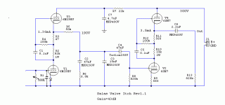

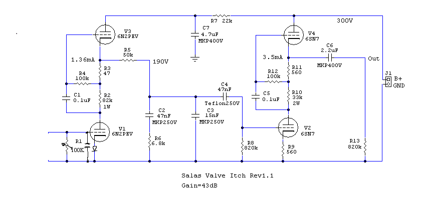

I am about to build a Valve Itch since a while. Now I got all the parts together and I started building the power supplies.
As I understood the shield between the triods of the 6N2PEV (Pin 9) goes to ground. Is this also true for the elevated valve or does it go to the 150V point for the elevated heater instead? I did not find a reference in the thread so far.

Have anyone noticed if the 6N2PEV produces grid current below 1,2 V biasing? The datasheet suggests that it might do http://www.goldenmiddle.com/files/6N2PEV.pdf. An IR LED like https://www1.elfa.se/data1/wwwroot/assets/datasheets/ir908-7c_eng_tds.pdf or a 1N4148 might be around 0,7 to 1 V.
Depends on the valve and IR Led sample. If we can measure some mV across the 47K input we up the Vf with a proper component is the technique.

This USSR input tube at this gain should give about 60pF Miller, add this to your cables pF expectation. If not having FFT capability, use ears while tweaking the input resistive load.
Short cables and you mighy be spot on. MM's has an ideal load capaistance that differs between them. Personally I have never agreed with those numbers. Maybe you do
They go average higher then ECC83 in AF but to my measurments they average 1,4 to 1,7 pF. A good ECC83 seldom goes over 0.9 on any grid.
Gm is just a constant refering to af and current. In this case it should be high but not always. Ideal in this case is a high gm/af tube as top and the same as lower. PEV is not so high gm but i suits the purpouse.
Gives Av=80 in the Itch's input stage. The upper part of a mu follower is actually a CCS maximizing gain and insulating rail nasties. Good enough gain for our purposes.
TT cables 180pF + 60pF Miller = 240pF so 40pF more than manufacturer recommend including tonearm capacitance. Have I to not add capacitance right?
