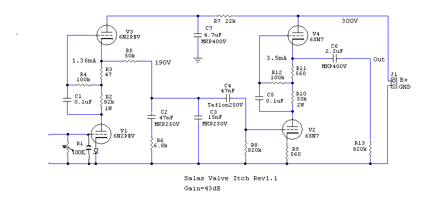

The gain is more than good for a 4.5mV cartridge. Something else must be wrong. Measure Ohmic load on phono input with power off and DC mV with power on. No TT cables attached when measuring.
A little bit more but I need to listen full volume up
Left 47K4 -0.028V
Right 47K9 -0.049V
Left 47K4 -0.028V
Right 47K9 -0.049V

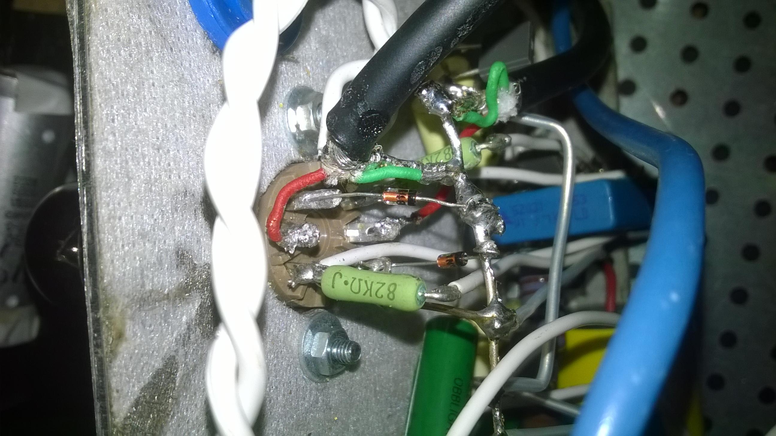

Your bottom tube doesnt bias. You should have 0,7 something if theres a 1N4148 down there with current passing. Measure your voltages in different points like anodes of all tubes. Are the diodes the right way (cathode down)?
Just remembered that I used the SSHV2 inside the Itch for other use and forgot to set again 300VDC😱.
Now time to warm up and listen, in the middle I will have dinner.
