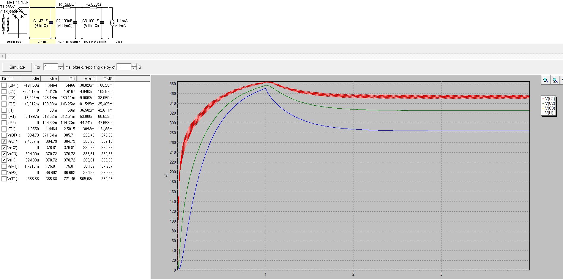

How critical is the voltage on the HT supply?
I have a 260VAC transformer instead of the specified 230V trafo.
I will drop voltage by using higher R values in the RC nodes of the supply line.
May I drop a little less or more voltage than the 41 volts that calculation suggests? Would like to use resistors from the box.

My main worry would be start up at 10 % too high mains voltage. I've dimensioned many things for a maximum voltage at start-up of -400 V. -400 V at 10 % above nominal mains is -363 V at nominal mains.
During start-up, only the voltage divider R47, R43, R139, D16, R140, R141 loads the -300 V supply, so the voltage drop across R132 and R136 will be less than normal and the transformer will deliver a bit more voltage than normal. If needed you could consider replacing R136 with a series connection of a Zener and a resistor, to reduce the difference in voltage drop between start up and full operation.
Once everything is heated up, if you manage to get the negative supply somewhere between -290 V and -330 V at nominal mains voltage, that should be OK.
Do you happen to know the unloaded voltage of your transformer (or equivalently the regulation) and the VA rating?

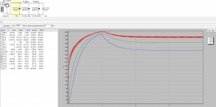

Thank you, as far as I remember, it's 290V unloaded, and 40VA. Can't check at the moment because I have to pull it from another build.
I did a sim in PSU Designer, assuming 10% regulation. This does look ok, given that C1-47uF is a 500V cap.
attachment.php
I will see how it turns out, the Zener is a good idea and another option.

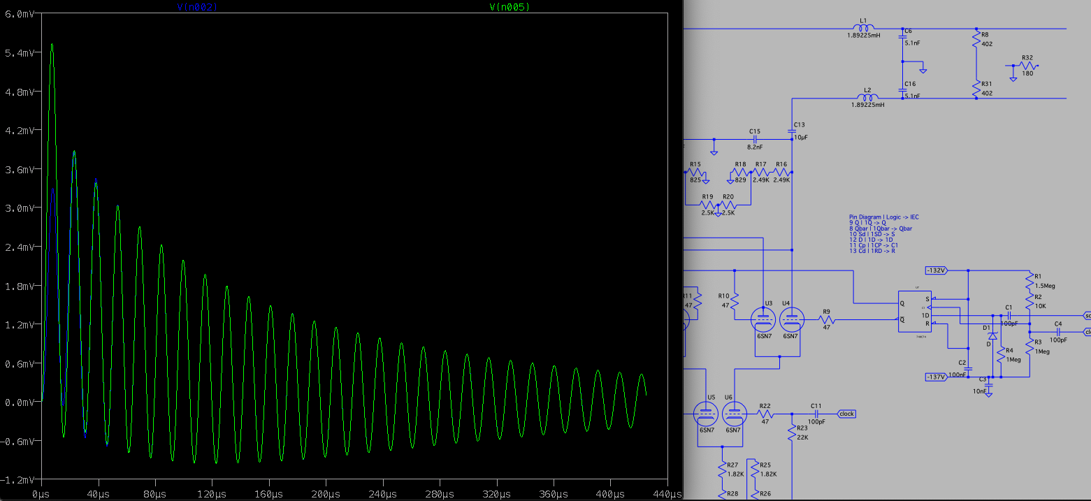

Hello again. Just was thinking of a variant of the RAW DSD512..
I'm been thinking of a version of this with 6SN7s. With two triodes per envelope and medium mu, it got me thinking as the 10mA differential output should be used to drive a push pull configuration of two 6AS7s in OTL for headphones (I'm designing a PP 6SN7/6AS7 OTL headphone amp at the moment in LTSpice). Three 6SN7s could provide the 6 triodes needed in small neat headphone sized amp package.
* 6SN7 coping with MHz in real life vs simulation. Gut feeling is that it probably won't have a problem.
* Cross talk vs higher B+ to Va/Ia - I suspect this may cause more RF issues in close proximity. one option is to allow low Hz (DC) and high Hz (rise/fall of the digital signal) only using a blocking filter.
* Reconstruction filter - the temptation to put this between the 6AS7 and headphones but would have to play with a simulation.
I may quickly knock up a simple DSD512 clocked LTSpice simulation - perhaps use a input file with DSD512 and then output a WAV file and see (although this may take some time to simulate).
Looking in a different direction, I have wondered previously about a version of Valve DAC using a Russian subminiature valve equivalent to the E88CC to make the board smaller/cheaper - 6S28B or 6S29B seem to be suitable but are only single triodes so the opportunity for a smaller board largely evaporates with the need for twice as many valves.
IIRC 6N16B is a well regarded dual triode sub-min equivalent to the 6SN7?
Do - edit timed out as I was playing with the load line calculator (Triode / Pentode Loadline Simulator v.1.0 (20161216 [url]www.trioda.com)[/url]). Looking at the load line, in the architecture we have for the valveDAC the valve will see the 16Kohm resistance (Ra) as it's got two 32R in parallel. A 0-5V grid (not using ±2.5), 153Ua, 16K Ra, will see ~ 2.59mA Iq (10mA at 0Vg, 3mA at about -5Vg) mu of 22.5V/V. There's still a little more you could give the tube by increasing the anode voltage.
Maybe I'm wrong and need of another coffee after a 5am start..
Well got the 6SN7 model running on LTSpice lol - DSD512 simulation 😀
This is literally the same voltages so probably not the best for the 6SN7's performance but it's 'working' (there needs to be a load of testing for distortion etc) plus I've not put in part of the filter (Lundhl transformer not in) so there's likely to be a load of digital signals output. I also had to use the 74HC74 which is 0.5V instead of the 74HCT74 which is 1.3V due to LtSpice model availability.
