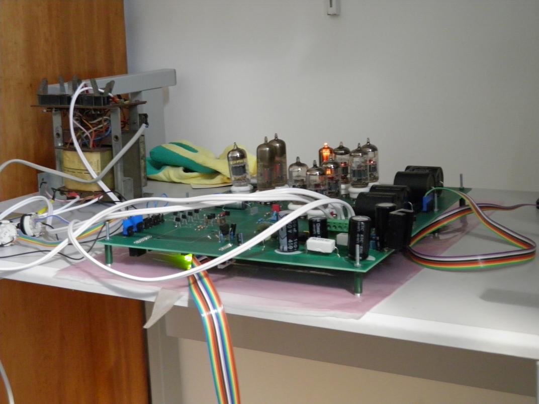

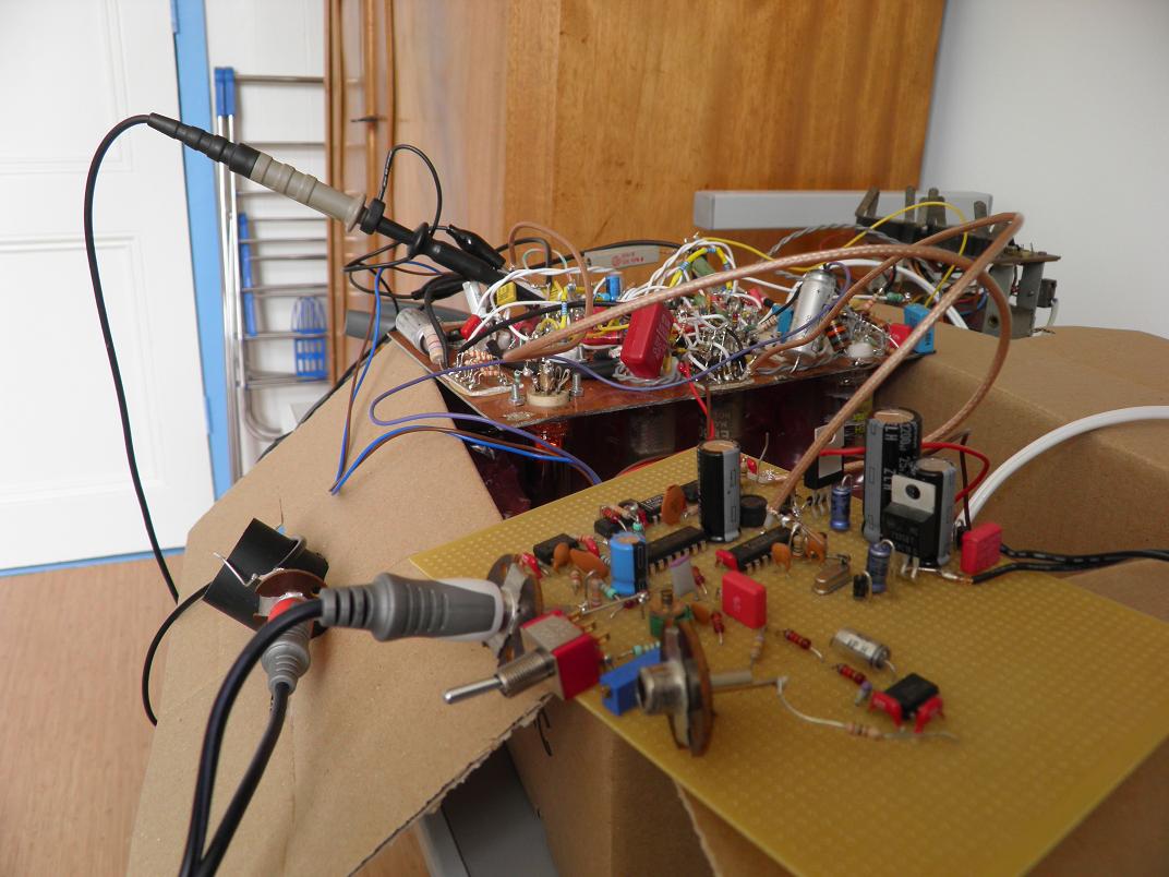

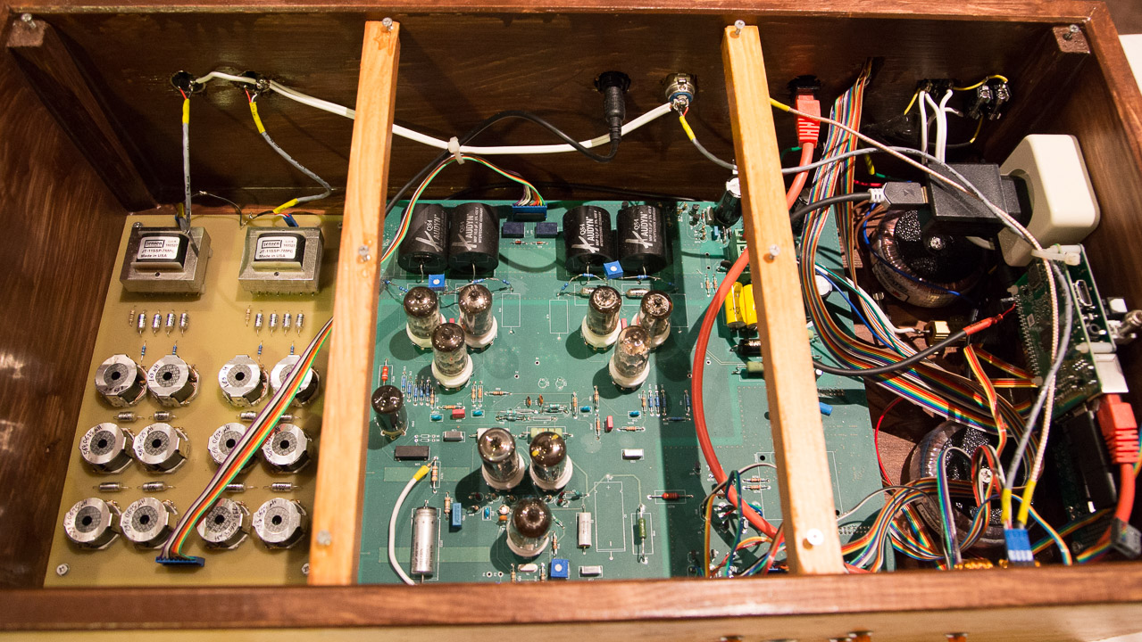

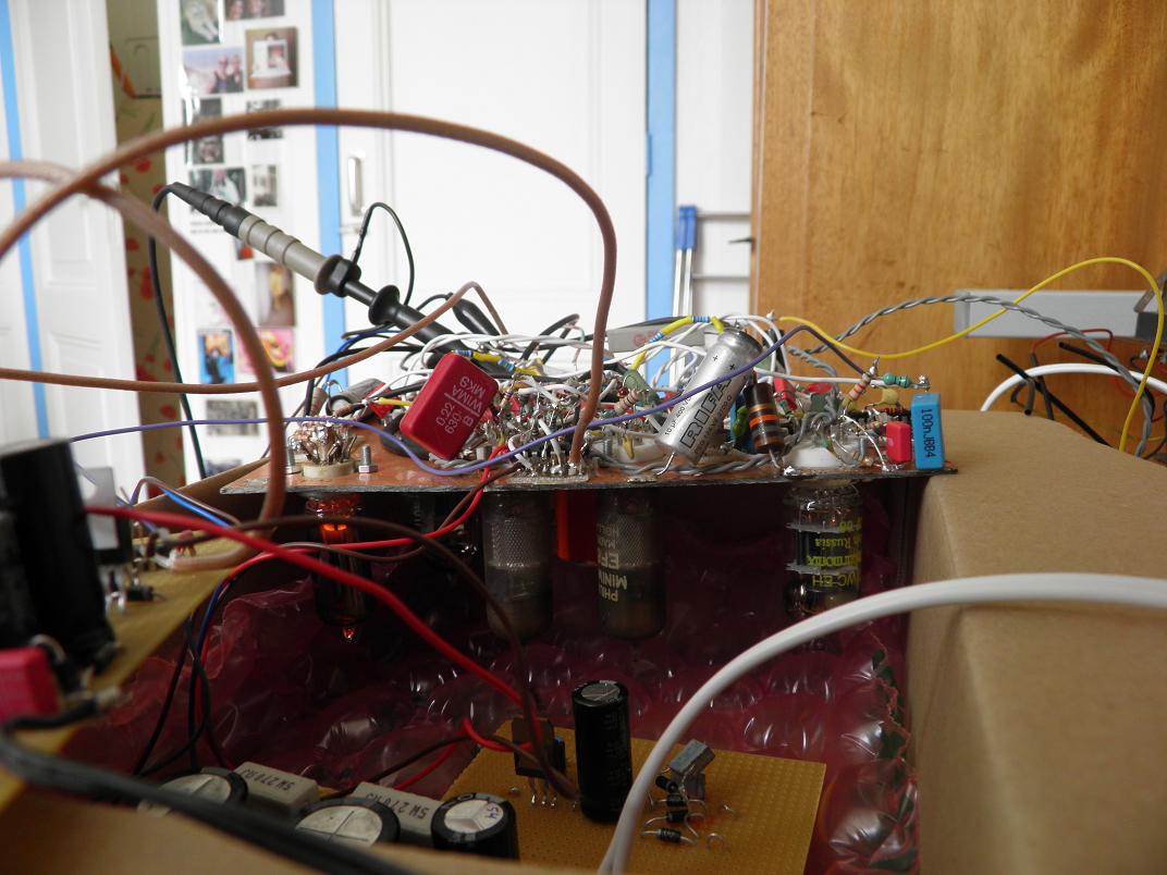

These are a couple of photos of the original valve DAC. The first two show an early experimental set-up that didn't include any of the digital processing yet, it only played back a sigma-delta modulate from a sigma-delta modulator made with some ICs on a piece of perfboard. The third shows the valve DAC main board in the first set-up that actually converted PCM digital to analogue. The fourth and last picture, which was made by Piet Blaas from the NVHR, is the best picture I have of the final DAC.
In this fourth picture, the valve at the bottom of the picture is the ECC81 crystal oscillator, the two above that are the EF80 valves for the clock buffer/voltage regulator, the one on the left is the 85A2 voltage reference and the two groups of three valves above that are the left and right E88CC two-tap RTZ FIRDACs.
