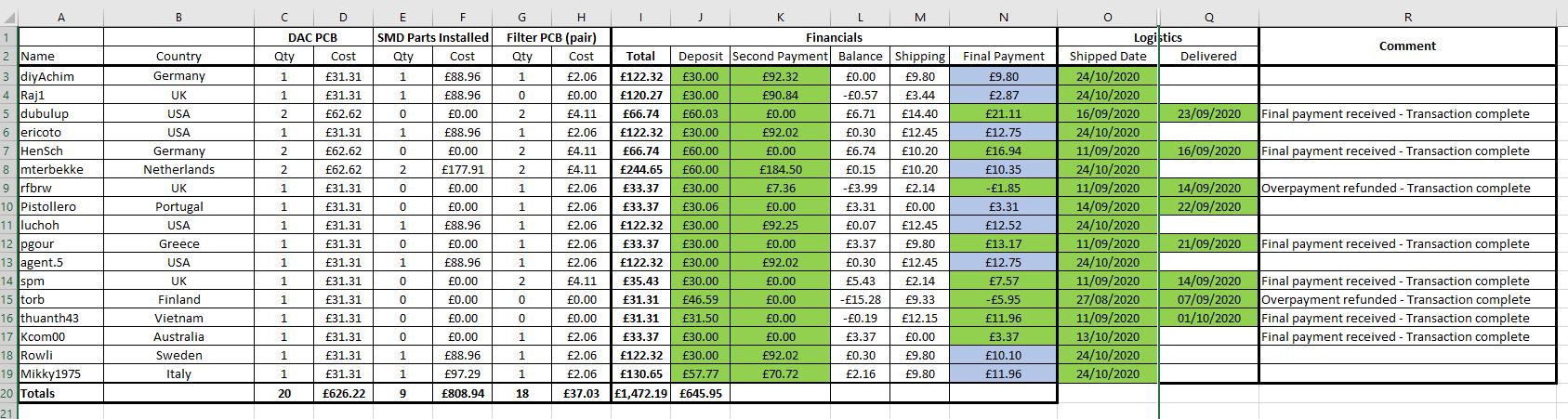

Some good news, 8 of the 9 PCBs have been completed for smd assembly and I'll be arranging to ship them out as soon as I can collect them from my friend's place, hopefully in the next day or two. As you guys have had to wait patiently I'll get them on their way and sort out the final payments to cover the shipping cost afterwards.
The 9th board is waiting on a final part but should follow very soon.

Even more good news! All nine PCBs are now completed with smd soldering and I will be collecting and despatching them tomorrow morning. I'll update with tracking information in due course and will post an updated spreadsheet with the final amounts owing.
Also, the last available bare PCB has been sold to 'SonnyMarrow' and will also be sent tomorrow.
I also hope to collect my second-build PCB tomorrow so I hope to be able to explore alternaite filter stages etc. I am planning an amplifier project with a balanced input so one possibility will be a simple filter with no output transformer - Marcel, do I need to make any changes to the filters if I don't have transformers in that context?

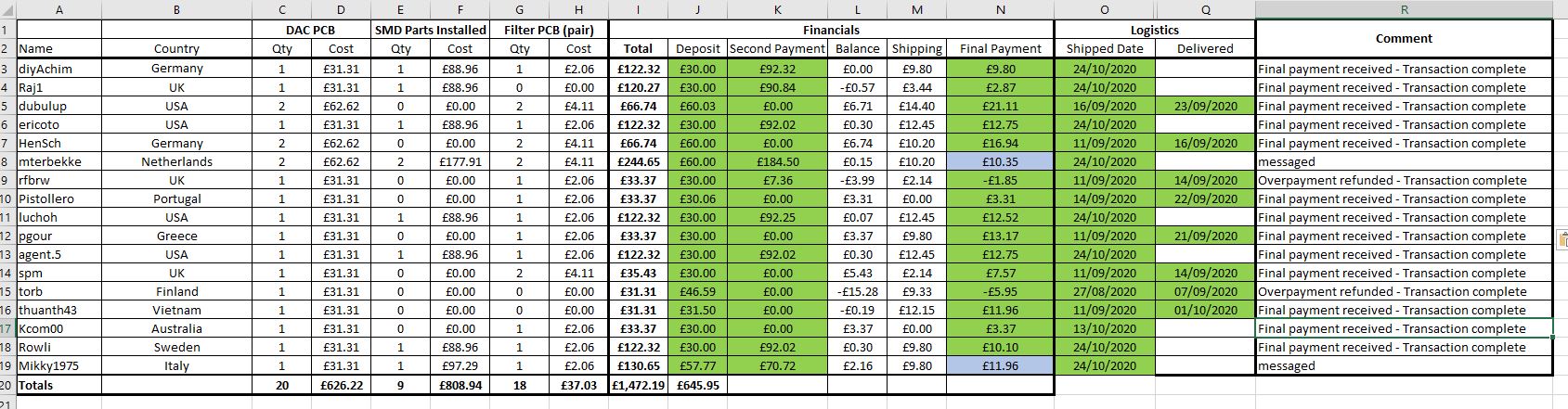

All the remaining PCBs were posted this morning. I will sent each recipient a PM with their tracking number.
That all but concludes the group buy; the cells in column 'N' of the spreadsheet are the final payments due to cover the shipping costs and accounting for any adjustments.

I've sent tracking information and final payment requests.
I think I got everything right but let me know if you think I've made an error.
