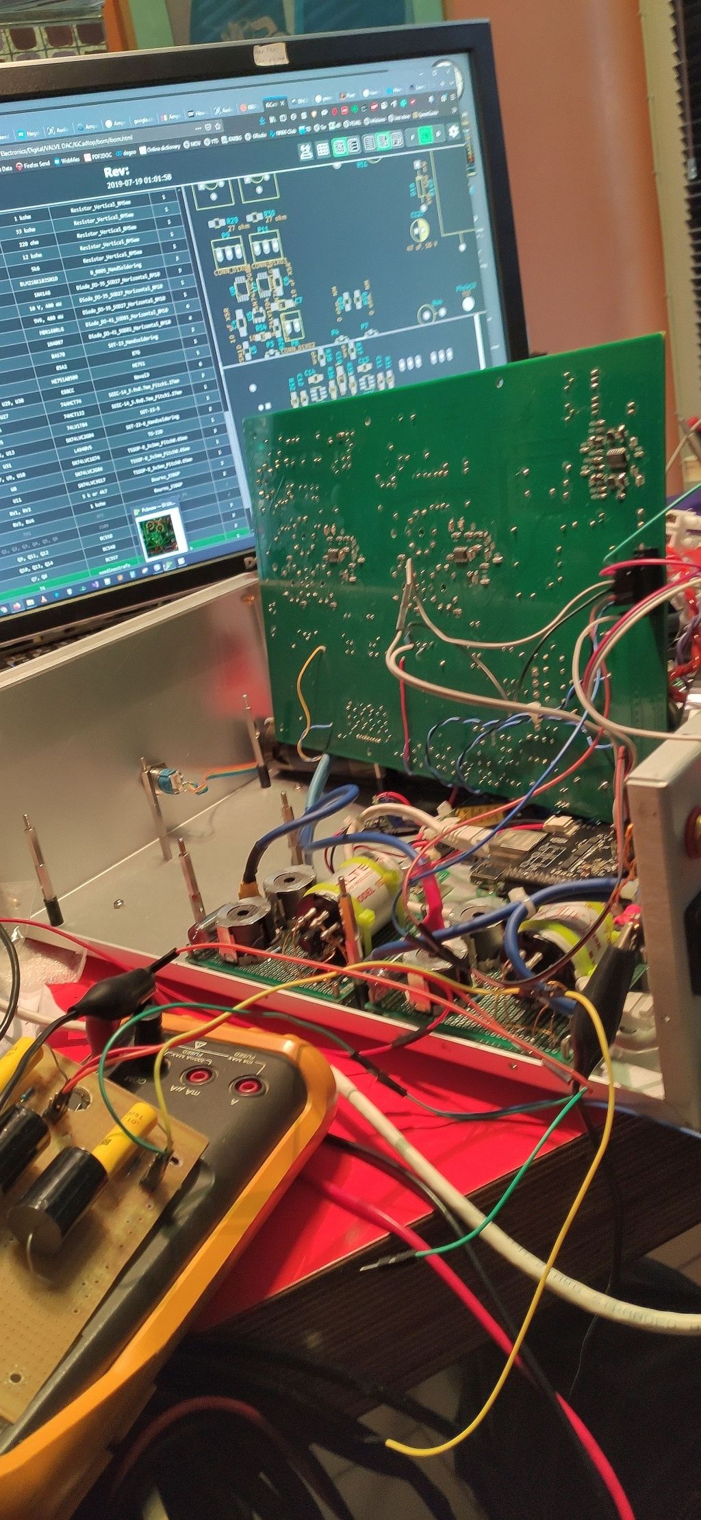

I have finished my built but, it is non-functioning.
I've got the following voltages:
B- : -287.3
D16 anode: -126.2V
D16 cathode: -131.9V
R111 to GND: 5.09V
All TPs:-122.1V
I get some sound but it is half speed (slow), noisy, and only from the positive node of the left channel.
P9, P11 shorted pins 1-2, and P8 shorted.
0 Ohm resistors on R59, R57, and R48.
Connected through BBGreen and PPY's ReClocker, fed though HQplayer 3 with DSD stream.
Since I have built everything for this project with all these SMDs and this is the first test for every part of the project, I do not know what is working and what is malfunctioning, so some help for debugging is what I am asking for because I've stacked.
Periklis

Hi Periklis hopefully you're not too far away and Marcel will be able to provide some insight.
Have you tested the BBB/reclocker on their own? Before I hooked up the Valve DAC I tried them with a simple low-pass filter no-dac to make sure I had a valid DSD signal.
Are all your potentiometers set to mid-travel - adjusting them on mine made a big difference to noise.
Ray
Thanks Ray,
I'll try the BBB - Rclk first thing tomorrow morning, since I want to be sure about this is functioning properly.
I thought that since HQplayer is functioning, this part is ok, but maybe not.
On the initial test, one clock's voltage stabilizer was not soldered properly and I was not able to stream 44.1kHz multiples. When fixed HQplayer responded.
Periklis
B- : -287.3
D16 anode: -126.2V
R111 to GND: 5.09V
All TPs:-122.1V
Supplies all close enough to the targets. Is the reference voltage about -202.3 V (85 V above B-)?
Half speed can't be due to the DAC and only from the positive node must be due to the DAC, so you have at least two problems.
Correct settings for using the bit clock on the Amanero-style connector.
Good, as with ppy's reclocker, the bug in the connections of the Amanero-style connector won't do any harm.
Periklis
Could you check the DC voltages at the inputs of the DC blocking capacitors, so at the anodes of U1, U2, U28 and U30, while attempting to play music? They should all be somewhere around -28 V with respect to ground.
What voltages do you measure at the muteswitch nodes, that is, at the J109 gates? They should be around -15 V, although a typical digital multimeter with 1 Mohm input resistance will display about -7 V. If they are 0 V or slightly positive, the outputs are muted.
Besides, Ray's suggestion to do some experiments with a makeshift low-pass filter is a very good one. You can functionally check a raw DSD output with an RC low-pass filter at 20 kHz or so, for example 820 ohm and 10 nF or 2.2 kohm and 3.9 nF. Connect the DSD output to the filter, AC couple the filter's output to an amplifier with volume control using a coupling capacitor of a few microfarads, make sure not to turn up the volume too high and check if you have sound. The reason for not turning up the volume too high is that at high volumes, the remaining ultrasonic quantization noise might damage your tweeters or your amplifier.
You could disconnect the transformer windings used for the heaters and the -300 V, so the only supply you will have is the +5 V, and use such a low-pass filter to functionally test the DSD datapath all the way from the BeagleBone up to U12B/R37 and U13A/R38.

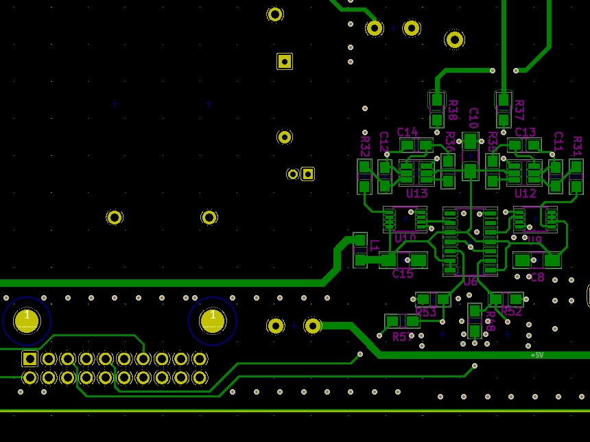

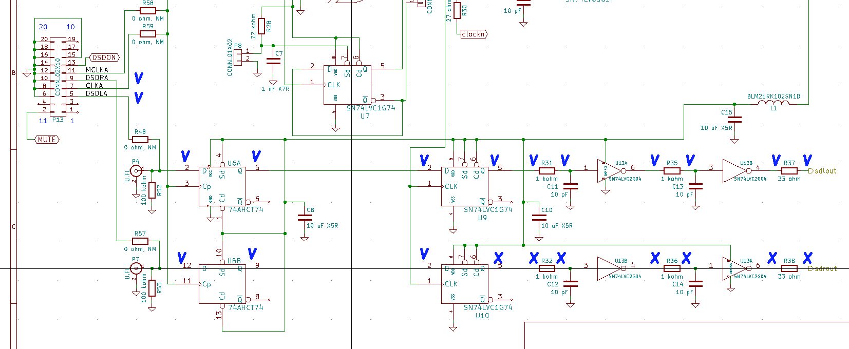

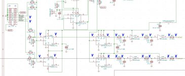

Hi Marcel,
Following your advice and Ray's I made the following measurements:
Rch
U28b, U30a : 0,034 VDC
U28a, U30b : -54,50 VDC
similar as if DSD signal was muted
Lch
U1b, U2a : -27,8 VDC
U1a, U2b : -26,43 VDC
correct, sound from Lch valid
J109 gates: -13.8 VDC
For results see attached image.
Thanks for being so much helpfull with so simple and easy to follow suggestions. Of course, I understand that I have a long road to success, so if any more ideas come to you I would be glad to try.
Periklis
