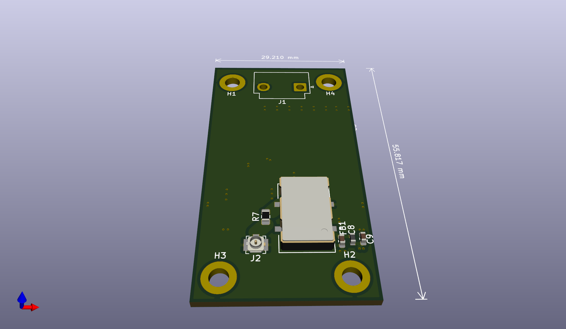

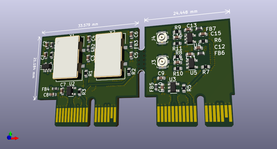

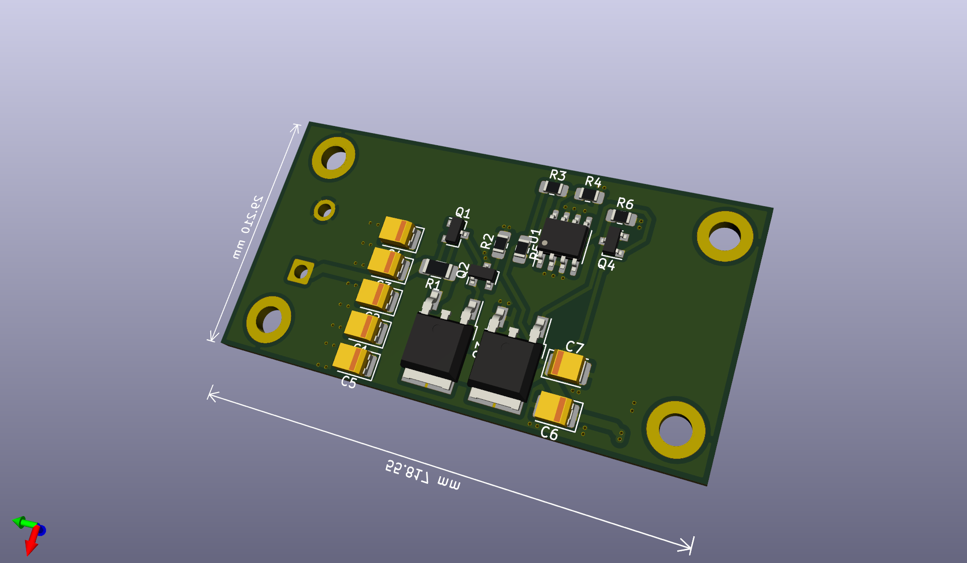

Schematics and renders of the external oscillators inputs board and stand-alone, always-on Crystek clock module (2 layers board). Connect 1 or 2 single-ended clocks to J3 and J4 of the inputs board. Using external clocks has been my original plan, and I reused the schematic a couple pages back, and removed the sine-to-square wave converters.

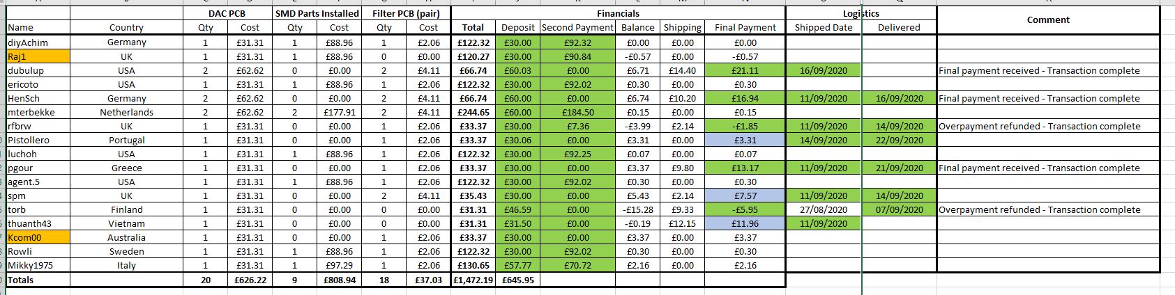

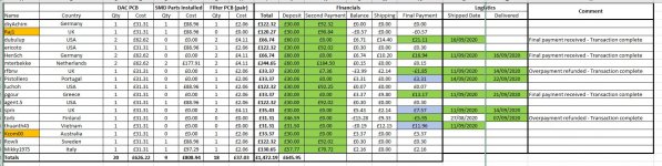

Latest GB sitrep attached. I'm still waiting on some final payments for shipped PCBs.
My friend's house move is almost complete and he'll soon be in a position to progress the smd soldering. Apologies for the delay.
Has anybody made progress with the boards that have been delivered?

I'm considering andrea_mori work for the the external clock part: can you confirm you're expecting a cmos square wave as external clock?

yes. Valve Dac needs a TTL/CMOS signal clock. I also am considering a pair of Andrea's well tempered clocks. According to him, these clocks generate sine wave outputs. Sine-to-square wave converters are required.
