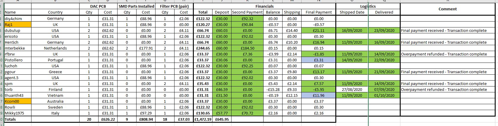

Late3st updated GB spreadsheet attached.
All bare PCBs that I despatched have now been delivered.
I'm waiting on two final payments for the bare PCBs that have been despatched, highlighted in blue.
As soon as they become available I'll start sending on the populated PCBs in the order shown on the spreadsheet.
Ray
