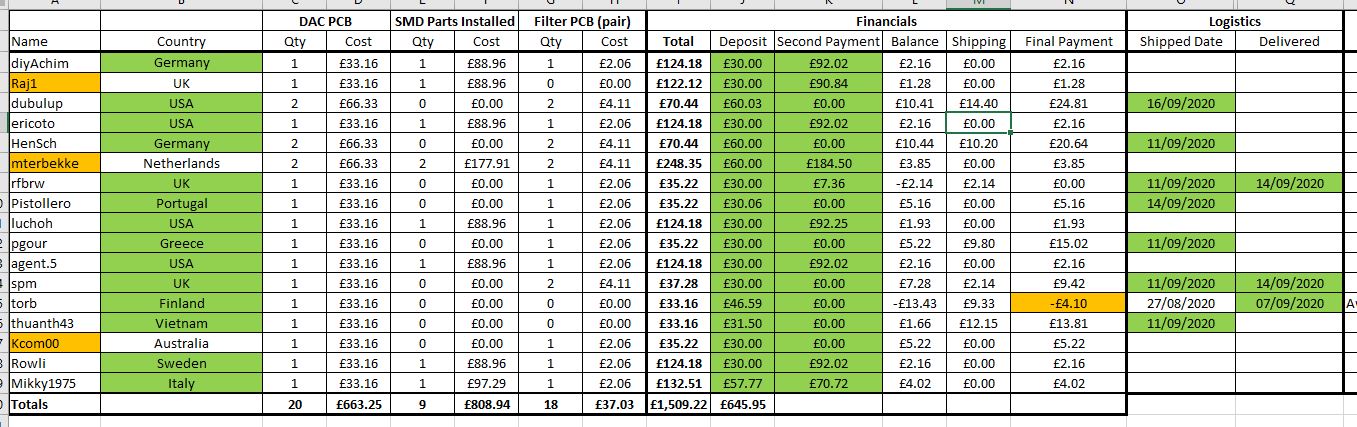

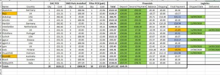

I finally received an invoice from Fedex for the Import duty and tax for the main PCBs but fortunately it was a little less than my estimate so there is a small decrease in the cost of each board. At least now we have the final figures for the board costs and can start sorting out final payments - at least for everyone who's boards have already been sent.
I've attached an updated spreadsheet screengrab reflecting these costs. Looking at the 'Final Payment' column, if the cell for you is blue can you please send me a payment for the amount shown - this will close the transaction. If your cell is orange you are due a refund for an overpayment and I'll process these later this evening. If your cell has no colour no further payment/refund is due at this time.
When you make payments to me please use PayPal family and friends to avoid my incurring fees.
I'm still missing two delivery addresses for the subscriber names shown in orange.
I'm hoping to get the soldering underway next week.
