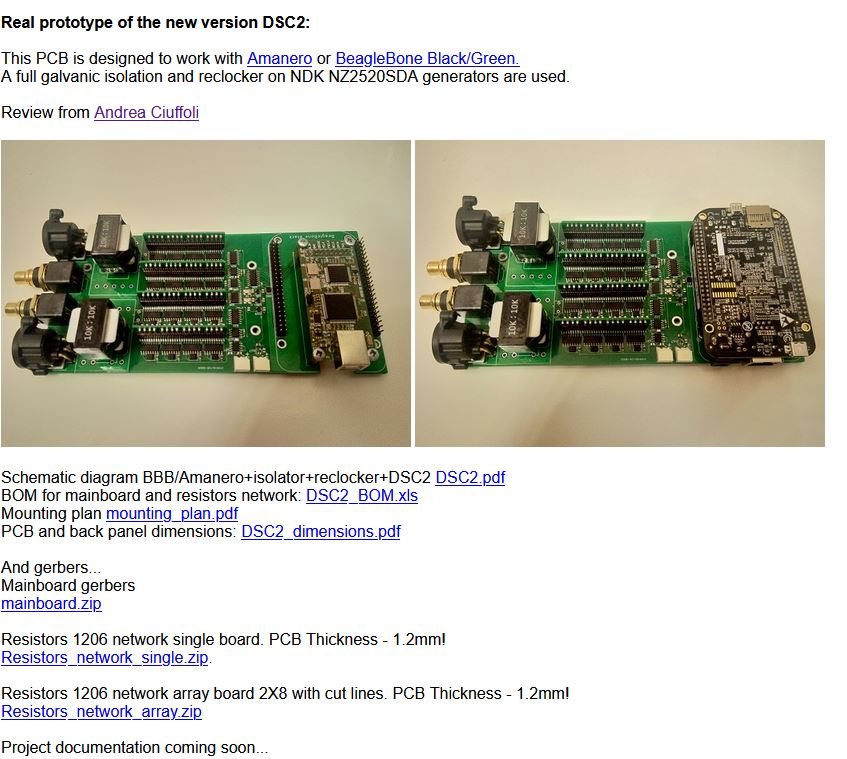

Marcel. see the image attached below, grabbed from ppy's website. This version of DSC2 includes the isolator/reclocker integrated onto the DSC2 board (as you can see, the BBB just plugs onto that board). Schematics etc. are there on the website.
Ray

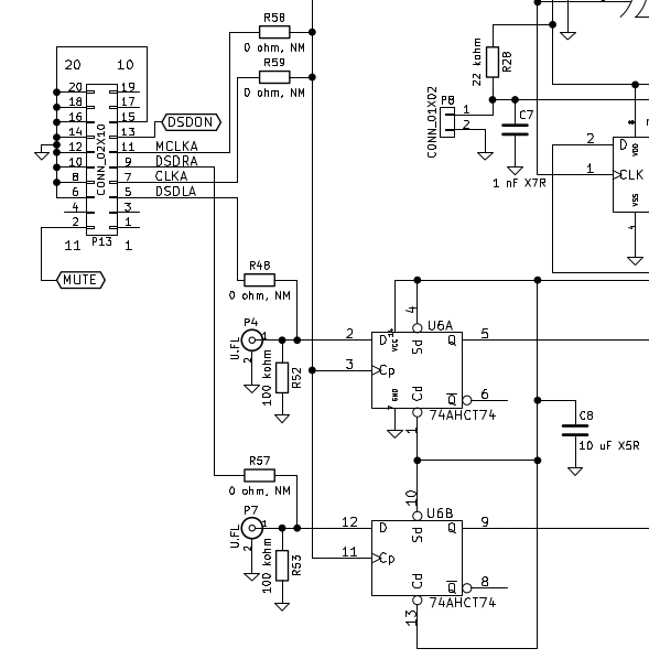

I know, but is it compatible with https://puredsd.ru/DSC252.pdf ? If so, then Ray can use the bit clock without any hold time issues.
The circuit in https://puredsd.ru/DSC252.pdf is positive edge triggered, like the raw DSD valve DAC, but it requires a set-up time of 7.2 ns and a hold time of 5.3 ns. The raw DSD valve DAC only needs 5 ns and 0 ns, so anything that meets the timing requirements of https://puredsd.ru/DSC252.pdf should also work with the raw DSD version of the valve DAC running on the bit clock.

The raw DSD valve DAC definitely needs an external clock source with reasonably low jitter. The data just need to be stable from 5 ns before to 0 ns after the rising clock edge, they are immediately clocked into a 74AHCT74 (U6 in the schematic).
