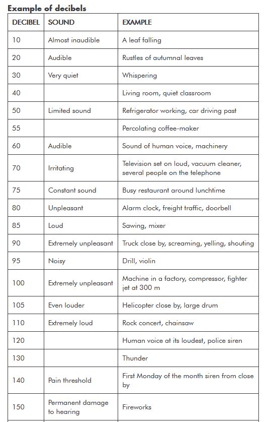

Maybe it would help people if I try to quantify what I'm talking about regarding my noise floor experimenting/tweaking as i don't want all the posits about it to give the impression that its a problem. I'm afraid my attempt isn't very scientific as I have no measuring facilities other than my ears.
I've attached a table of sounds and their associated relative levels in decibels (I feel something is missing - distance - but we'll go with it as is).
Fortunately I have a couple of benchmarks because;
I played some solo violin music and set the volume level to correspond with my recollection of an actual violin being played - again not terribly scientific - but perhaps 95dB.
Without adjusting the volume I then played some 'silence'. From my listening position I could have been listening to a leaf falling i.e. to me it was inadible at perhaps 10dB.
Sorry I can't do any better than that but maybe it is useful? I should add that my ears are well past their prime as I'll be 63 next month.

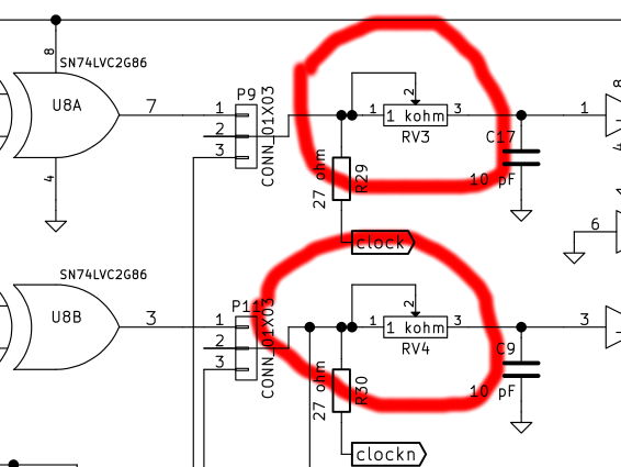

Is there an updated circuit drawing or KiCAD file that shows RV3/RV4 ?The original valve DAC has no RV3 and RV4, but it used to have trimmer capacitors that had a similar influence on the timing as RV3 and RV4. As far as I recall, the exact setting did not have much influence on the noise floor until it was so far off that the DAC did not work as a return-to-zero DAC anymore, then the noise increased clearly.
Thanks, Ray. But non of the .pdf files shows the RV3/RV4 and the file called "KiCadtop_schematic.pdf only shows this:
