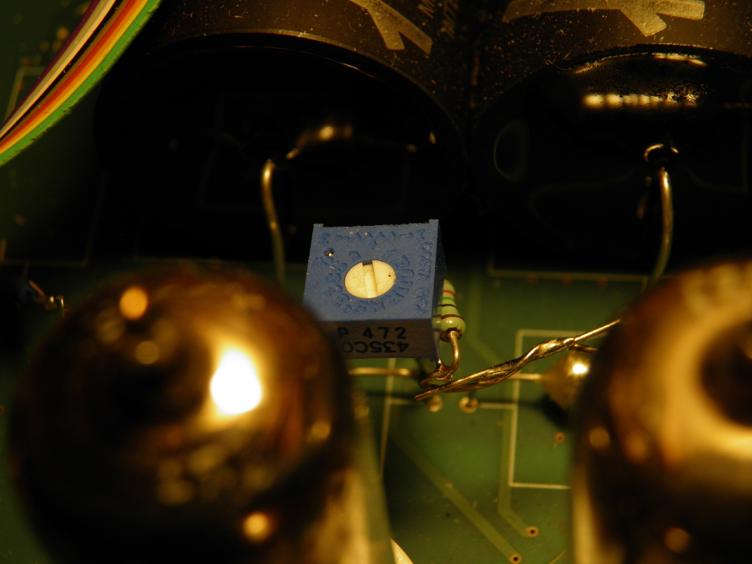

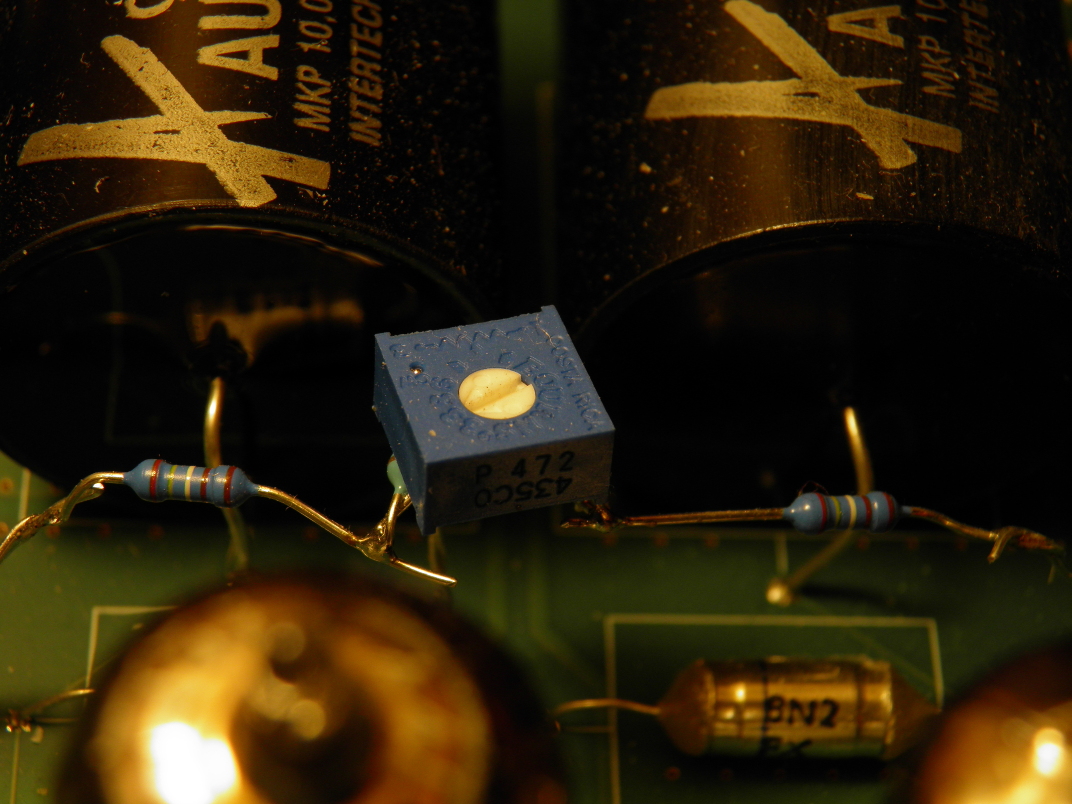

Marcel, For RV1 minimum noise is at about the 3 o'clock position but for RV2 lowest noise is with it rotated fully-clockwise? I was also thinking that multiturn potentiometers would have been nice for fine adjustments.
I think I've now settled on DSD256 as my baseline rate as DSD512 doesn't seem to bring anything extra except for a slightly higher noise floor. That's with my preferred HQP settings and it's entirely possible that other settings might give different results/preferences.
I did start to explore RV3 and RV4. They were set to fully clockwise when we first got the Valve DAC up and running when I experienced the noise issue. I backed them off a little but couldn't discern any difference in the noise floor. I was conscious that I had the HQP volume level very high for the tweaking and that made me nervous of making more adjustments in case I triggered the clocking noise again. I'll have a coffee and see if I can pluck up the courage to explore further.
I have to say that so far the Valve DAC documentation Marcel produced has been spot-on and the DAC has responded to adjustment exactly as per his design rationale.
For me the optima were just before 12 o'clock and around 2 o'clock, but they can vary depending on the matching between the triodes, so it's not surprising that you get different positions. It is a pity that your RV2 is completely clockwise, though, as that shows that the trimming range is too narrow.
I should have mentioned R14, R25, R26, R27, RV1, R103, R104, R105, R106 and RV2 in the section about things that may need to be changed experimentally, because I couldn't predict the required trimming range. Determining it experimentally would have involved buying a few dozens of E88CCs from many different brands, determining the optimal settings for those and doing some statistical calculations, but I didn't fancy buying dozens of E88CCs, so I ended up simply dimensioning things such that the trimming range was considerably larger than was needed in my DAC. I'll come up with a set of alternative values that double the trimming range.
The original valve DAC has no RV3 and RV4, but it used to have trimmer capacitors that had a similar influence on the timing as RV3 and RV4. As far as I recall, the exact setting did not have much influence on the noise floor until it was so far off that the DAC did not work as a return-to-zero DAC anymore, then the noise increased clearly.

Good point. I think it would be a good idea if I made the PCB compatible with both, so people can choose single turn or multiturn.
There are multiturn trimmer potmeters that should fit into the PCB as is (Bourns 3296P series, Blocked ), but those have the adjustment screw on the side, facing the big DC blocking capacitors. I think those would be very inconvenient.
The change to double the resistance trimming range is to change R14, R25, R26, R27, R103, R104, R105 and R106 into 2 kohm +/- 1 %, 0.6 W metal film. The trimming potmeters can stay as is, as can R5, R16, R76 and R87.

Yes, the 5 kohm version of the PV37W series should fit without any PCB change. Thanks!
I'll roll these amendments into the through-hole BOM.

Those are rated at 0.25W whereas the orignal spec pots were 0.5W - I assume a non-issue?
I wonder if it's possible to add an option for mounting the tube sockets on the other side of the PCB so that they could pop out of the top plate of the chassis?
Sorry, actually 0.25 W is a bit tight. If the DAC's data lines get disconnected and the potmeter is turned almost entirely to one side, there might be 10 mA flowing through a small part of the resistive element. The power spec of 0.25 W is for the entire resistive element, so the current the potmeter is designed for is sqrt(0.25 W/5 kohm) ~= 7.071068 mA which is less than 10 mA.
So, I'll have to update the PCB design after all.
