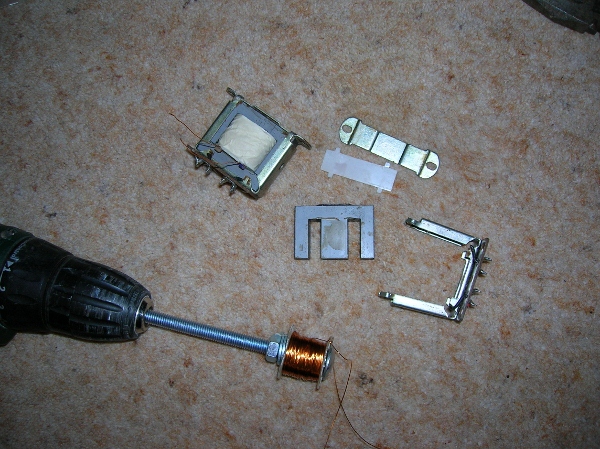

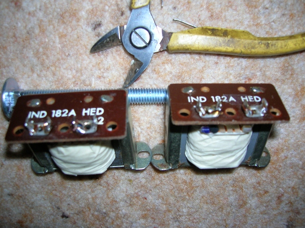

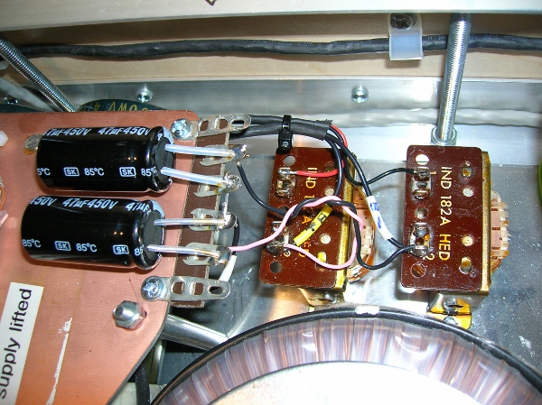

Just for interest,
I removed one of the PSU caps that was an additon across the +/- rails and used the space for these..
A couple of chokes wound for a test and give a reduction in Hum..
This was/is just a test and it seems to work well.. 🙂
OK the wire may need a rewind to reduce the DC resistance but they work quite well..
Regards
M. Gregg
Regards
M. Gregg

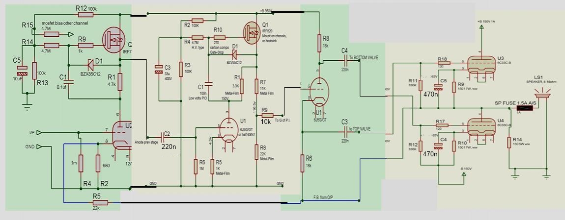

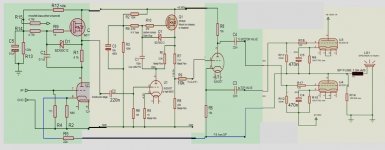

I guess,
I should also mention that in the above diagram the resistor R9 on the PI grid is now at value 120K to reduce the nipple distortion as discussed by Alistair..
The power is high enough for me but YMMV..
If the resistor you are refering to is R4 on the 2nd stage CCS it 4.7M connected to the gate stopper 2nd stage FET.. 🙂
Regards
M. Gregg
Regards
M. Gregg

I have spoken to quite a few people now and they have built different OTLs and yes they also have hum with some speakers.. 🙂 With the chokes the Hum is very low ear to the speaker.. 🙂
And even with the pre section B+ turned off with no chokes just the OP stage there is hum..so its definatly the OP stage and its not the heaters..
Does the tim Mellow have some kind of hum cancel circuit possibly tied to the driver stage? Even with no Ct connected the same is still true..
The only other thing is Tim mellow has heaters connected to the power supplies and lifted via + and - 150V rails...
However I think this is not relevant..or the chokes would not make a difference...

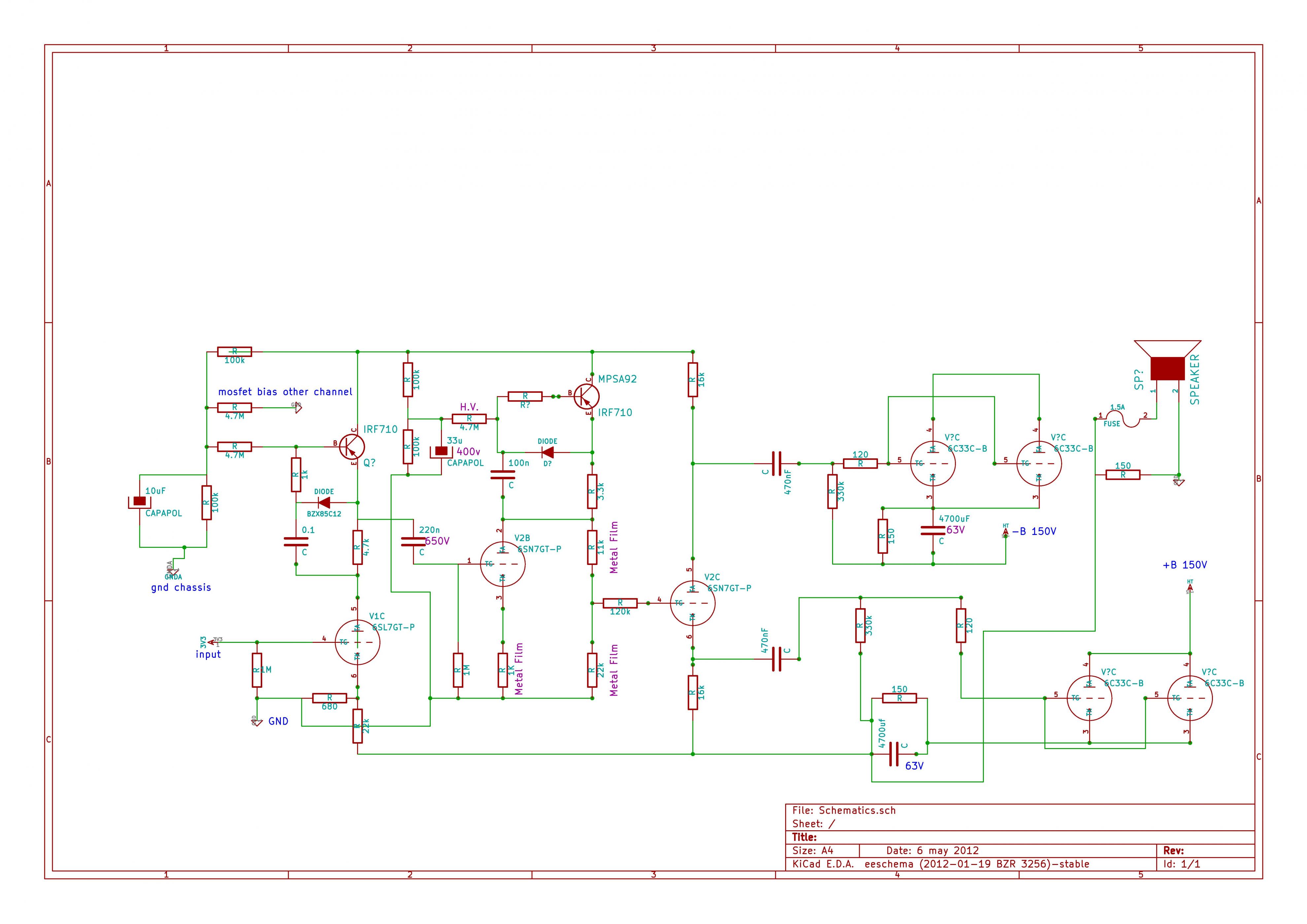

Sorry for the late response )=
I sat down and remaked the schematic:
I forgot to notice that the resistor below the fuse is a 5W one.
You used this PSU: http://diyaudioprojects.com/Forum/download/file.php?id=2101 am i right?
I dont need the 146V and the -430V part anymore. Can i just remove them ( C6+R21 and R31+R32+C16+C17)? And you removed one of the Caps (C12-15) and replaced them with some Cokes.
How difficult would it be to replace the transformer with a 2x 115 one? I only saw 115 ones no 120..
