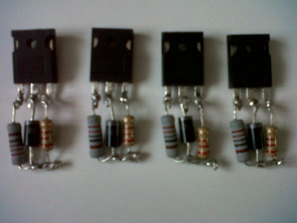

I´m back to katodbias but with a mosfet assisted zener for the moment.
Gives me ~10w no adjusting needed.
Amp was giving best THD at 45w disipation but now i´m down to 30w not wanting to make bigger hole in the ozonlayer 😀.

I switched to a TO-3p to just for comparsion of heat transfer.
TO-3/TO-220 didn´t do much difference when topplate heats up the device drifts a bit.

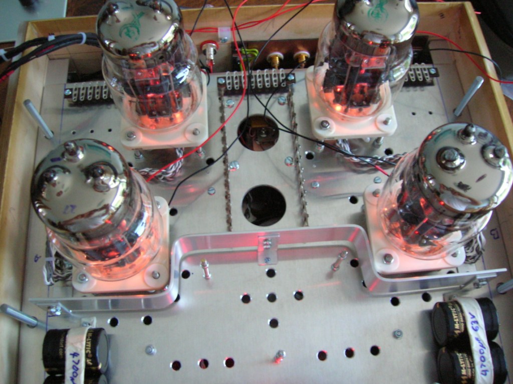

I have an idea,
I intend to leave the top plate alone,
I have a dividing plate that the tube bases are mounted on, (I'm going to leave this alone as well) and mount another false plate under the dividing plate. This I intend to use as the heat sink for the Mozener. The dividing plate has large holes for air flow so the hope is the air will travel across the new plate and through the holes...

Your layout is probably better than mine with several heat barriers.
I thought of putting the Moz on the side of the case.
I find that a double skin works well even with just a 3-5mm between as long as there is air flow across / between the surfaces.
I also found that there is little point in trying to cool an area of metal sometimes its better to isolate it from the chassis and let it do its thing..The reason is anything attached to it to try to cool it will just come up to the same temp...and cause even more problems.. The wooden sides prevent heat transfer between levels..also stops ringing..as long as the heat is managable on each plate..
another thing that works ok is to put a row of holes between two areas of the metal the heat transfer is slower and a heat reduction can be had across each side of the holes...down side is loss of strength caused by the holes..
