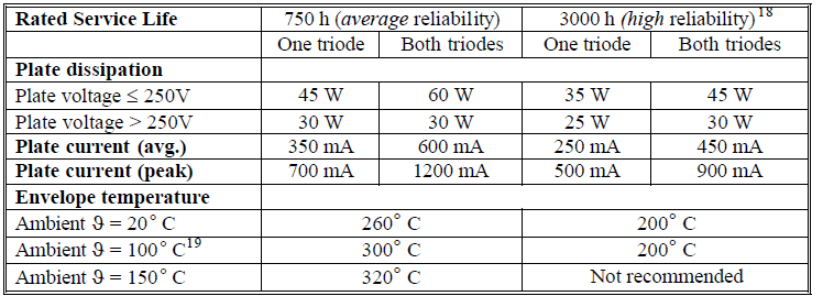

Well max Anode is 60W,
I am told that 400mA is pushing it (tube life) ..The higher the bias current the shorter will be the tube life..Then again up to 60 Watt is the design..
The heat will be very high..In the box temp will be higher than with it open..
What power out are you getting now what bias current are you running?

I´m running 350mA right now keeps the cost for firewood down.

Ive gone the other way--Still running the 2x PL509 I'm running 70mA, although sound has suffered slightly--but not as much as you would have thought suprisingly--These seem best at around 120mA-150mA

Experience of the 6C33C suggests 250 May be a bit high. You'll need around 50-80V drop across the cathode devices, depending on the current draw--LOTS of dissipation there....
