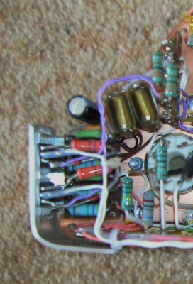

Vacuum Tube OTL power amp!!
Just a picture of the Mod...
Tight...LOL....:snail:
I will cobble togeather the whole schematic and post progress so far...
Regards
M. Gregg

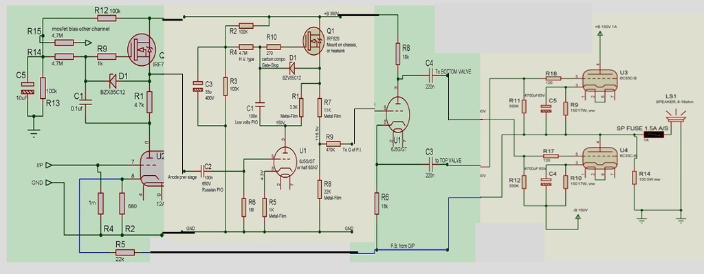

Schematic so far...
Valve pin numbers still not correct..
C2 is 220n
C3 is 470n
C4 is 470n
R9/R10 are 220 Ohm 12W or higher...
...Just for those interested..
I used the supply from the first splitter R12/13 to supply 2nd stage ccs...works fine!
Regards
M. Gregg

Alastair,
Did you get the remote working OK and any progress on the MK2?
Is the above schematic correct to what you have now?
I must admit I missed the amp while it was in bits..LOL
