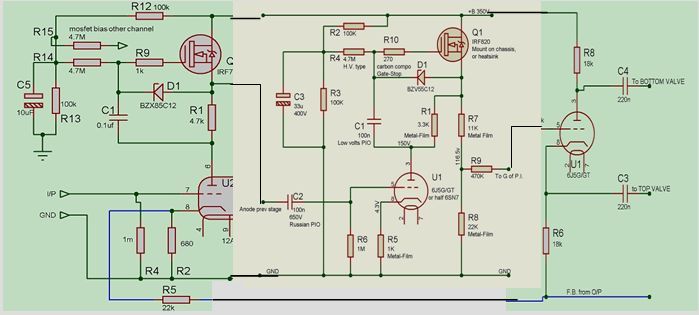

Well, Ive decided that the MOSFET 'Mu-Stage' addition to the second gain-stage is well worth the effort....
Power handling at higher levels is improved, as the op-point of the SN7 is more ideal, this stage was going into clipping before the O/P stage, as it was previously...
Here is the second stage as I have it now--.
Looks good!
Is IRF710 OK as replacement for 820, also did you use another 100K-100K splitter or just take the 4.7M from the existing source?
C2 now 100n not 220n?
270 carbon comp R10 is this a selection for pref sound or due to stability?
Inductance ect? :)

Yup--710 is fine (better), I just used the 820 as thats what I have loads of!
--(Really need to order some 710, they have a nice low gate-capacitance....)
I made up some small vero-boards with most of the parts on, including duplicates of the 100K pot dividers and the 33uF caps...
You can share the 1/2 potential from the pot. divider you already have, that runs the first stages. As the bias resistors are so high (4.7M) there'll be no interactions...
--Again, the caps I used on the veroboards were what I had around, anything from 1-100uf will prolly be OK if you do double up on the pot divider stages....
The 'Carbon-Compo' is because its a 'Gate-Stopper' and is usually recommended to be a carbon-compo type. TBH Ive used standard resistors in the past with no issues, but recently I ordered a big bag of 270 ohm from R-S Components.....
The value of 'C2' isnt too critical, I'm currently using what was in the amp, I assumed it was 100n, but on checking its 220n as in the earlier diagrams here....

The amp seems o play louder before obvious clipping, which is probably coming from the O/P stage caps charging (blocking distortion)...
Thats something I'm looking at currently. Thinking of a simple clamping circuit set to just a little above the average cathode-bias-voltage of the average 6C33C....
As the cathode-volts rises, the clamp would come into action and prevent it going further into blocking, but still retain the self-bias action as normal....
Prob end up with yet another mosfet and a zener-diode.....
--Summit for me to think about!

Parts on order!
Alastair,
I will use the same divider supply and tap via 4.7M from first 6SN7 stage. Keep coupling capacitor at 220N. Irf710 Fet.
Have you kept the gate stopper for first stage at 1K or changed it to 270 Ohm as in 2nd stage (R10)?

Alastair,
A quick cobble togeather...LOL
I guess this is what we have now with the same feedback Etc.
The pin outs are still not correct for the tubes, however....I will be picking up from the first stage for the second stage CCS.
C2 is still 220N...
