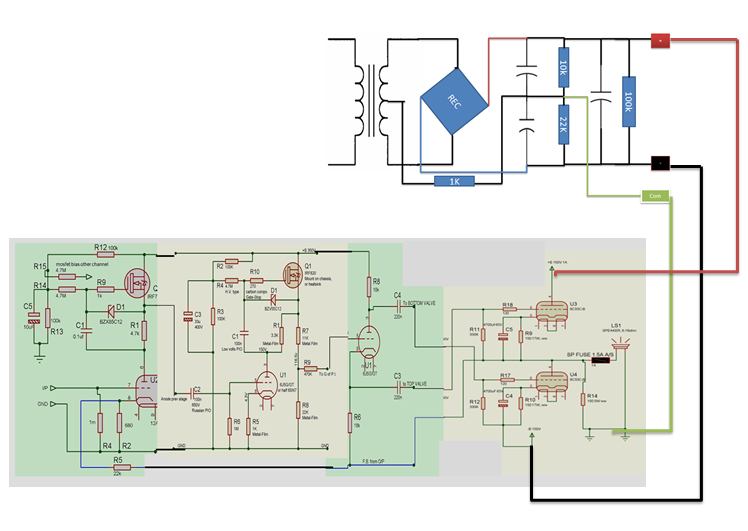

Alastair,
I am going to have to try shorting out the 1K.. I have had comments by others that they had a big offset caused by this 1K with no load and also with full load.
This we have seen..
This is the question WHY did Tim Mellow put this in the PSU?
Thoughts are charge current and short fault causing major damage..
OK nothing in the cathode of the 6C33C's in other designs..
Well with the auto bias we do have a cathode resistor to limit fault current..
Possibily the cathode cap could blow,,,then again the fuse should go first..
So I see no gain in this 1K resistor...If the inrush is controlled.
So out comes the soldering iron....Shame I don't have the new coupling caps..
Curiosity has the better of me.. 🙂
I will leave the other resistors as is for now..cathode current PI ect..

Just for interest,
Again based upon tests done recently,
Also great help from members.
It seems that if the Ct is diconnected we lose bass response in this design..
This was confirmed by tests I have done and thoughts from members seem to point to, the cathode caps being in series with PSU caps lowering effective capacitance of the cathode bypass..hence lower bass..breathe..lol
So I know Ct must be connected (even with 1K is fine)..how much better it may be "direct" I will know soon..
However thoughts are still with speaker protection..If I used 500 Ohm will it be half as good..LMAO
Ah well..its times like this you have a magic wand and zap, test, zap put back..LOL 🙂
LOL just did the calcs if 6c33c was short with 220 ohm cathode resistor whats the volt drop across "wattage dissipated" 4 Ohms in series..
I think were OK with direct conected Ct..

I should imagine with most/all designs you would see a drop in bass without the CT connected...
This is due to the fact (In 'normal') designs you have no DC return from each rail, only an AC drain via the PSU caps, which then are both fully in series with the signal.
--The centre-point of the caps, is a pseudo-ground only if the CT isnt connected, and will not respond to DC and attenuate extremely Low freq..
The Tim-Mellow design (IMHO no offence intended) is flawed in a number of ways. I dont like it, however those that built it, like it....
With the CT connected, of course, the 22K and 10K become innefective as the CT now connected will keep the CT at 'O' volts, (all things being equal) and you'll still have the offset on O/P term caused by 7mA PI current.
This could be rectified by adding suitable sized resistor from the neg rail to the O/P terminal, to flow the same current as the PI....

Alastair,
That's great news..ok not for the tube..
I can't comment about other designs and bass Ct or effects first OTL I have experience with..However there is a bass reduction no question about it!
What size resistor you goin to put in the negative rail then? 🙂
Alastair,
Could you do some measurements for power out THD etc..and post if you get time!
I have had a few people ask..It seems some are interested..
Regards
M. Gregg
Resistor from Neg rail to O/P term would need to be around 22K or a little higher.
We are only looking to flow approx 6 mA to compensate for the PI current which should be also around 6 mA
--This will then effectively form a sorta potential-divider with the PI and cancel out the offset caused by the current return from the PI into the O/P term.
Realistically though, you'll probably have a bigger offset from the O/P valves themselves, and in choosing their position to minimise offset, you would have taken into account this small (Almost Non ) issue....
Offset across a 8ohm resistor is the best check though, rather than the O/C value...
Any testing that I now currently do however, would be done with 6C41C so wouldnt have much bearing on the design as described in this thread.
Maybe if you have the equipment/software, you could find what your current set-up is giving....
Not sure when I'll be able to get to do this...
Apparently, There's some pretty good freebie software able to check things like frequency-response, distortion etc but the quality of the readings depends on soundcard performance.
My soundcard is pretty crap so any results wouldn't be very accurate!
Alastair,
Here is a suprise for me any way...
I have connected the Ct direct....and yes a slight reduction in noise...But..
The bass is less refined....It's early to tell yet..
I'm going to listen for a while but I think there will be a value going back in what thet will be I'm not sure yet!
I may try the my joking remark of 500 Ohms..

Hmm....
'Less refined'
I wonder, if the phase-shifts that are probably happening at these lower frequencies caused by the PSU caps in series with the signal without the CT connected, are causing the bass differences that are a pleasing effect for you....
Or maybe I'm just talking crap!--Sound is just so subjective and so difficult to describe in words!
I would have thought without the CT connected, the bass would be 'wolly' or boomy/vague sounding, less defined....
'Less refined'
Hmm....
'Less refined'
Its hard to describe but here we go...there seems to be less bass and its grainey buy comparison.. not so smooth sounding..hard on the ear..
I don't know if this makes sense but its less musical..
The problem is this could be the components used etc..
I'm almost tempted to put a couple of flying leads and variable power resistor and try different settings,,to see what the effects are..
We know that there is an effect if its disconnected and put back...so I have to assume that I am hearing something..what that is I do not know..
Regards
M. Gregg
