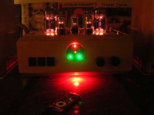

8Hrs continuous,
Can't find the off switch..lol
No fatigue...strange listen all day?
The Alpairs are getting a pasting... Cones moving oh yes...
Kraftwork..LOL <<shows the High freq....sounds Great! <<no tweeter!

I must admit it sounds great at the moment, I will be expecting leakage all the time, so I guess some new ones are on the cards.
Yes heat is an issue with these tubes, I only get it on the top plate now. If I could find a non metalic heat resisting material it would be perfect.
I thought about PTFE, but is hard to drill. 🙂 It's not a real problem just thoughts to make it better!

Trying to straighten out my PSU design.
6800uF in each +-150 rail one dropping resistor.
With my 115v transformer not here i have to guess but seems like a little to less for real quite one ?
M Gregg did you go regulated for small signal HT ?

Do what you know works best for you,
You could use electronic choke.....
I Thought about using a Maida,
however I just used 47uF- 10H choke-47uF.
470K across the last cap. 50mA fuse.
Regulated DC heaters for first two 6SN7's.
The type of rectifier will make a difference...BYV96E or hex or standard + snub.

Standard Avalanche,
Good spec 2A 1500V 🙂
The 6C33C stage required current not voltage so I used higher current diodes in this section..also inrush for the high capacitor values on each rail.
I used a 1K 12W on the common rail. 4700uF across each rail and 1000uF across the +/- rails and 4.7uF film cap.
Any snubbing?
