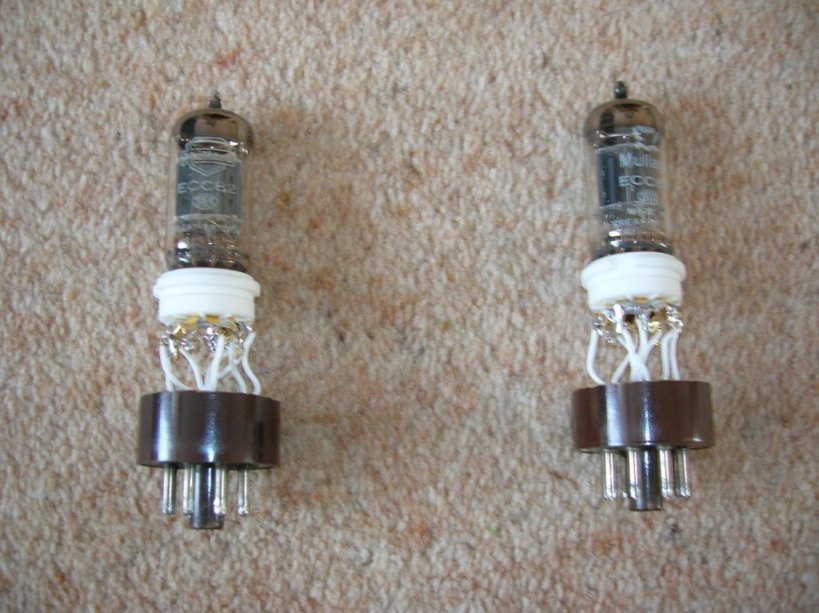

Well here is a story to tell:
I made these:

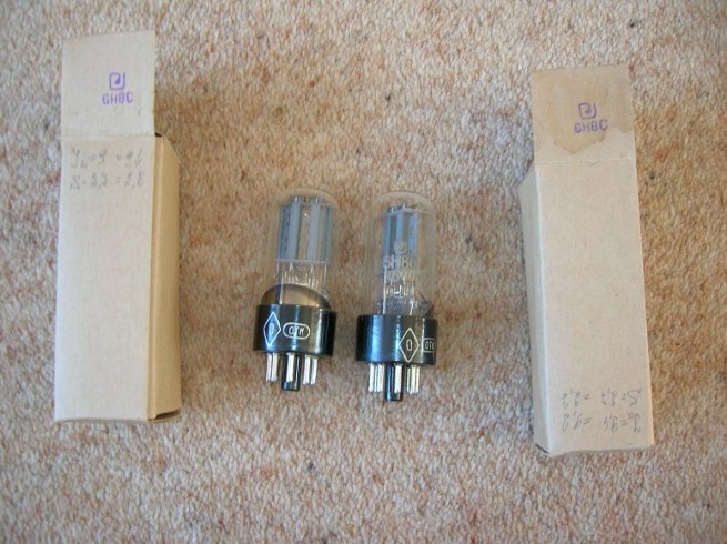

As I finished the last joint and cleaned the base up, These arrived (6H8C). I thought I can't believe it chaos theory reigns supreme. Honest I had not taken my hand off the base of adapter last one in the socket!!!!!
So I put the 6H8C's in ......a strange buzzzzz from one channel. I thought it must be one of my earths are not correct, however I put the music on WOW.....then my DC heater protection cut in...
Thoughts are that it did not cut in with the SL's so I put in the adapters and WOW.....no cut out!....The tubes are stuffed....so the adaptors are in at the moment the Mullards sound nice! So me thinks, I have had some more on order for 2 weeks should be matched.....I think A couple of Tung sol are on the cards....I still haven't changed the bias...running 300 Ohm. Yes it is running my Alpair 7's...sounds very nice. I will let it warm up and have a play let you know more....

One thing I have noticed with the 6H8C, the heater-current is quoted as 600+-50mA but always appears to be higher--although Ive never measured it. Sounds like you have a H-C leak or short in one of the 6H8C....

Knew you would end up making some adaptors, The ECC82 is basically the B9A equiv of 6SN7 anyway, so at least you'll run right with those (Its Just a personal thing, I'm not too keen on the B9a twin-triodes, but that doesn't mean they are bad!)....

Just arrived,
Matched pair CH8C.
So I have the replacements. 🙂
Regards
M. Gregg
Get 'em in there--How do they sound?🙂
