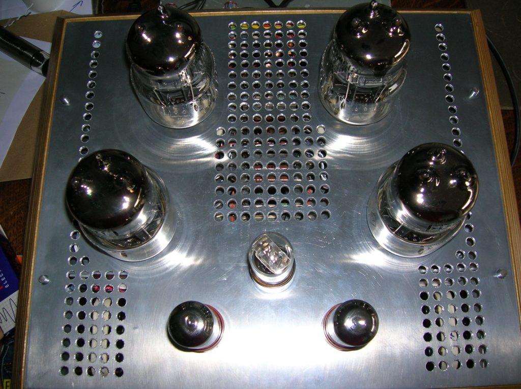

Just some more progress.
I am working on the top plate now to cut down the heat transfer across the surface. The heat does not pass the shield between Pre and power sections.
Still waiting for the 6SN7's.
B+ relay is in the top left corner of the picture.
Just for interest if I power between different heater settings you don't hear anything except a slow increase / decrease in clip level.
Also it drives my Alpair 7's quite a surprise. Just want to hear the difference with the SN7's.
Difference in power taken from mains supply with one heater on the 6c33c's is 100W..I think its worth the effort.

I have modified the top plate,
It still gets quite warm, however you can touch and hold your hand on it, tested after 2 hrs with B+ on.

Just for interest,
I have lowered the top plate by 1.5mm and increased the hole size in the last 8 holes at the rear of the top plate. It is now just warm to the touch with all heaters running...strange just a small adjustment makes such a difference.

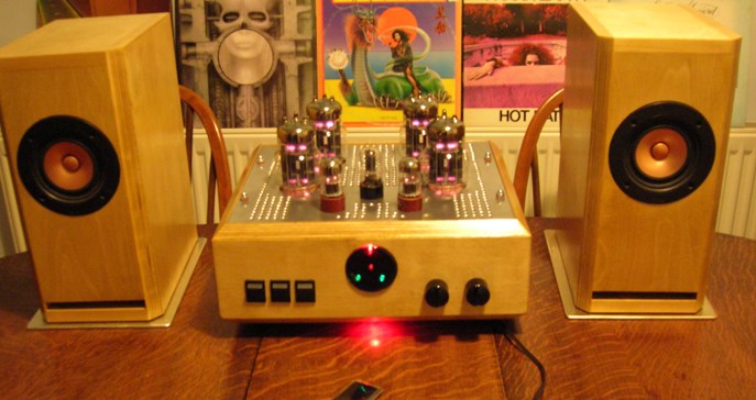

Could not resist,
Here is the OTL still no SN7's , driving the Alpair7's. (On test)
Still some work on the front panel etc, to do....
Display shows 2 heaters, HT & input 1 on...

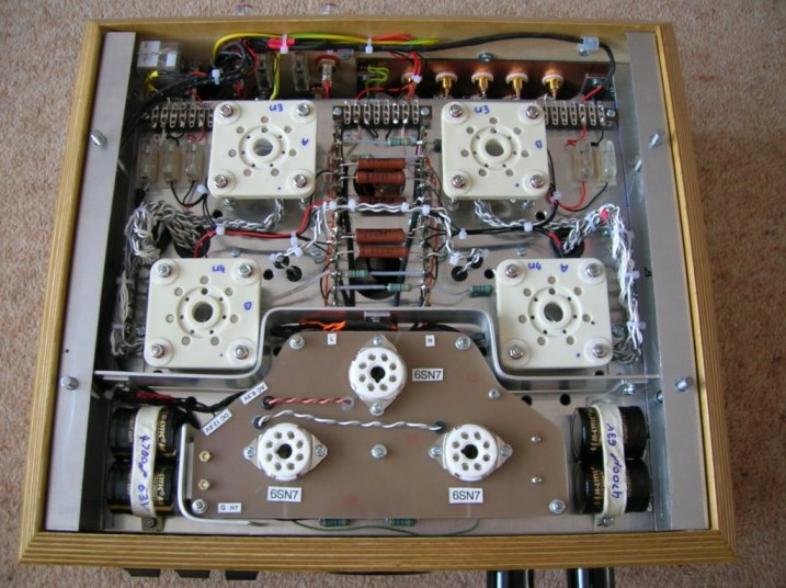

What happened to all the capacitors?
The hill is getting less steep 😉 I think your on the move now!
