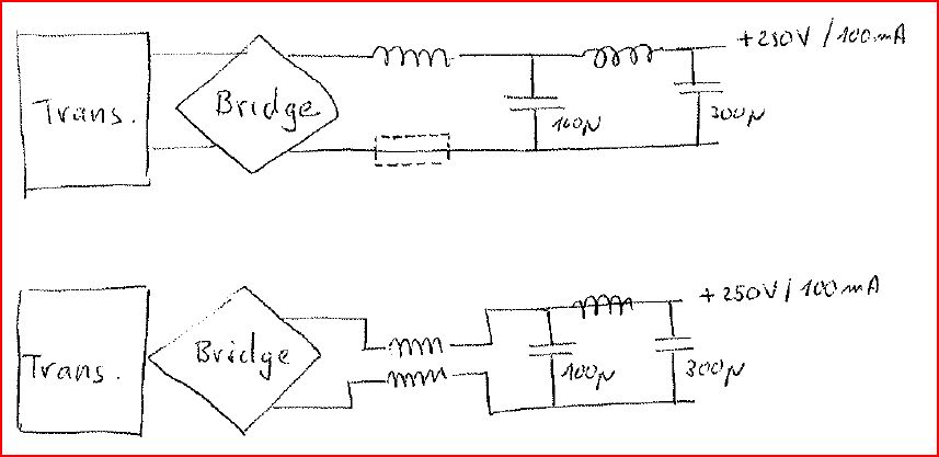

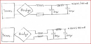

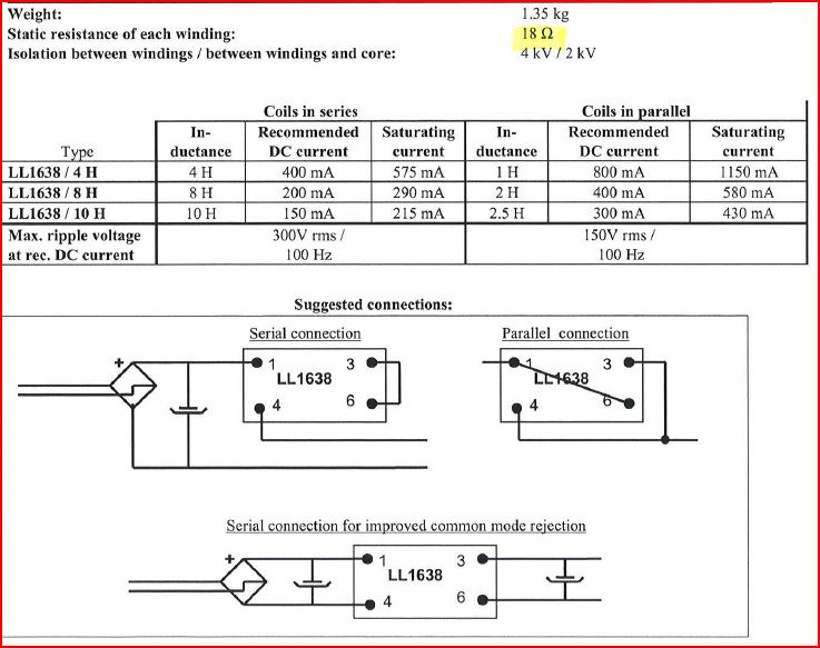

I need a 250 V/ 100mA HV Power supply with following structure: Transformer + bridge + input choke and pi filter + regulation.
The Lundahl LL1628 with 2 coils should be my final choice.
What is the way to connect them ?
· 2 coils in serie => 10H on B+
· 1 coil (5H) on B+ and one in ground (5H)
See on attached files
What do you mean with the resistor (100 Ohm) on the ground ?
Please can someone help me to calculate the chokes values ?
Lundahl LL1628 is an excellent choice.
Your best option is 2 coils in series => 10H on B+
OK Joshua
That means one dual tube for : input stage + CCS from the second stage
Another dual tube for the Cathode follower + CVS
Same for second channel
Am I right ?
What do you think about a 100 Ohms on the ground line ?

What do you think about a 100 Ohms on the ground line?
Which resistor are you referring to?
Please see my attached schematic.
The resitor I mention, is on the foot of the xformer.
vince
I'm not clear about what you are trying to do.
You can do either LC filtering or RLC filtering.
Since you are going to use Lundahl LL1628 in series configuration, LC is good option for filtering mains ripple.
Adding R is useful only if want to lower the voltage. If you use R, better have the same resistor on the (+) and (-) lines.
