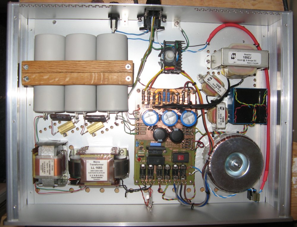

This built supply is not the needed supply for the real RTP3 but for is own need. For example there is no Logic Supply in the original. The included RTP3C schematic is very close to what is in the kit. Heater supplies are Current Regulator, not Voltage. Allen claims that they were always better. Make your choice and do some test, you'll easily find what proper voltage to use, to prevent regulator IC overheating and proper filament operation. If you add a choke inline you'll drop some voltage there as well. Again simulate with Duan PSU2 and you should have a good idea.
Don't forget that the current needed is different from tube type to an other. That prevent easy tube rolling in this preamp. Depending on tube you may need to change the current programming resistor of the current regulators...
One thing that help me reach the proper voltage with the Lundhall is that euro transformers are designed for 110V-115V primary. We have 120 in Canada. So transformer secondaries are always higher, even so if they are not fully loaded.
HV voltage value is a compromise between regulator power dissipation, what is needed at the preamp and proper regulator overhead input voltage. Get the original SVE SuperReg. It is explained in the doc, or read the notes on the schematic I posted. You'll get your answer.
Here the latest supply built. With the bigger low heater choke, tweaked CRCRC resistors values for proper HV and some more ventilation made into the casing.

My personal opinion (based on two versions of FVP5) is that heater supplies bring nothing to the amp. Its silent enough without it. Unnecessary bulk and expense.
Allen had very strong opinions on many things - and I am not certain I would agree with all of them or even many of them. The reason the preamp sounds so go is mainly because of the incredibly good topology which delivers at least 80% of the performance. You can go chasing the final 20% all you like but its going to cost - and you are never going to be satisfied.

Well Allen was reaching for the best sound and to build a reference class preamp, and he did it. If heater current regulator were maybe contributing to only 5% of it, he would certainly choose it.
And if you're trying to build as good a preamp, it is worth it to try it as well. It no big deal. Use one current reg per tube and adjust the current programming resistor according to the chosen tube. As simple as that.
This preamp was one of Allen life achievement. He worked on it for years, perfecting every aspects and working hard to extract as much juice as he can. I'll follow his advice any time 😉

LM317 as CCS is good enough for purpose , if you're keeping HF garbage out of heater circuit , just because 317 is good as snail in suppressing high freq noise;
elevating heater potential to proper voltage is a must , both for "lower" and "higher" triode systems in stage , with purpose to prevent any possible leak between heater and cathode;

AFAIK, there is no HF oscillations caused by the heaters. DC elevation of the heaters is a good thing to do and it's mentioned in Allen's schematics. LM317 is fine as either voltage or current regulator for the heaters.
