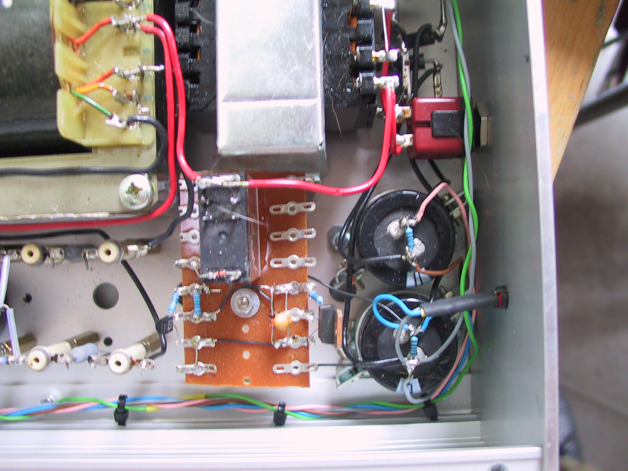

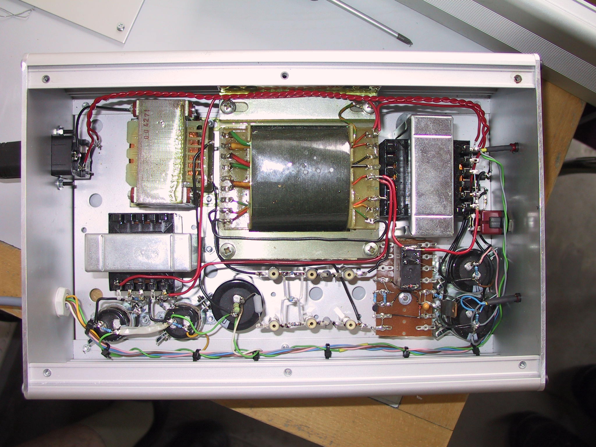

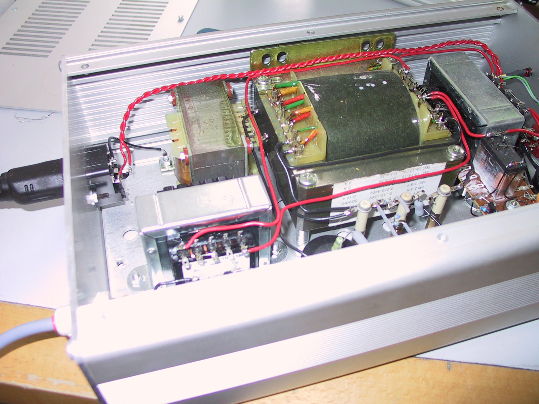

photos are of RTP3C PSU, algar_ami PSU is the RTP3D, which is quite different

Vince, damophi is right. I used to have the RTP3C PSU as well. Those pics are from emile (i think).
Not sure !
I think there are much more differencies...

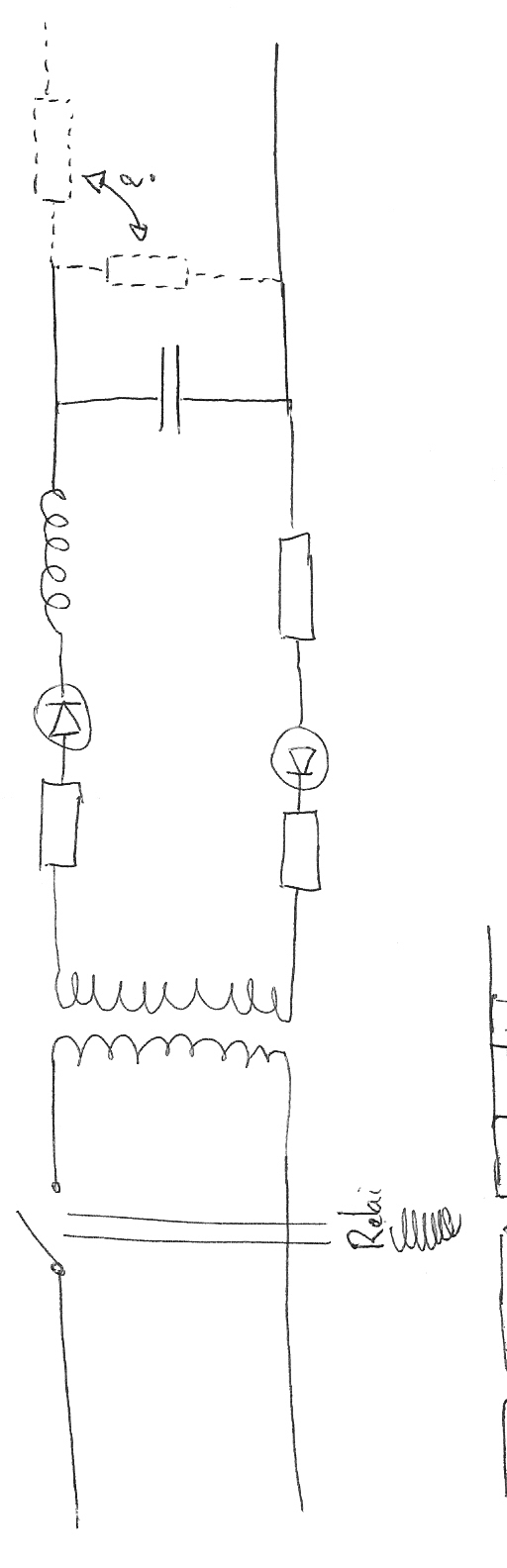

Here the schematic rebuilt from the pictures Ive send yesterday.
By cheking twice, I found a mistake with my diodes. In fact, there is a full waves rectifier.
It is not possible too find out the component used by VSE.
As you see, the HV filter is very poor.
algar_ami, can you share and explain your schematic ?

That appears to be a classic choke input filter, and knowing Allan I am quite sure that there is nothing "poor" about the high voltage power supply - you just don't have the full story..

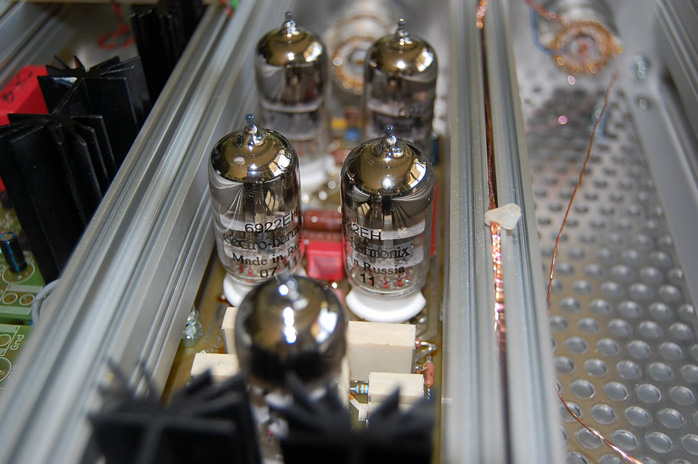

The D version is using PCB, not point to point, and the same coupling caps as the SVP2 latest version, smd case size, Metallized polyphenylene sulphide type. These caps are also quite difficult to source in small order...
Problem with the ceramic strips is that you need to order quite a minimum, they sell only with bank transfer payment, etc...
So it is a costly affair. I ordered quite a lot at the time.

Check the 6moons review of the RTP3D review, and included pictures. You'll see the pcb and the capacitors.
I also used this review pictures to design my cases.
Far from it. You have only shown the raw B+ leaving out the all improtant SuperReg(s)

Why is this choke filter not poor according to Allan Wright ?
vince
This is extremely ill informed and disrespectful I am afraid; for the reasons already pointed out to you. It is also likely that if Allen used the Lundahl choke as an input filter that he connected it in a way that allows some common mode filtering.
