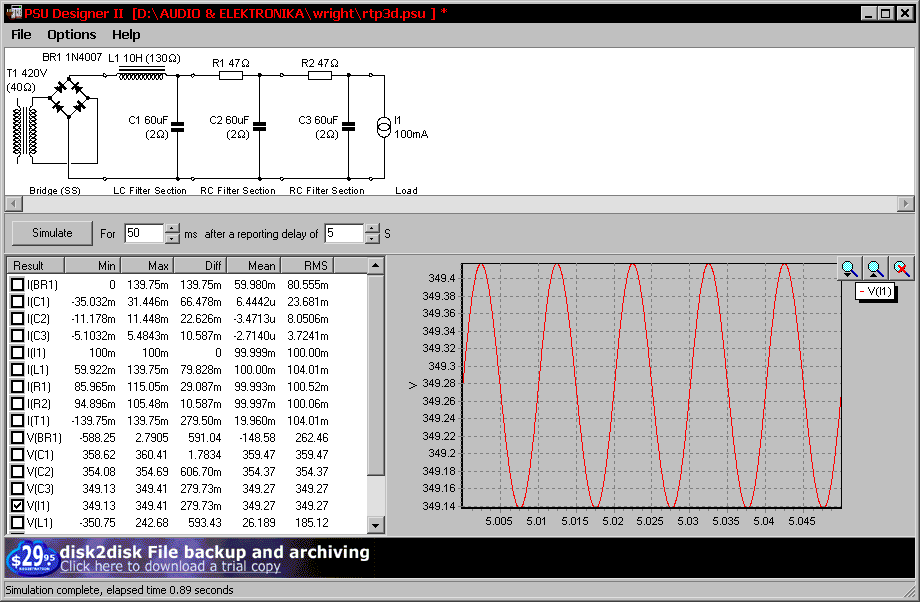

So it's getting clearer: Allen just claims 50Volts to be needed. So I'm ok with this. My simulation file is included in the previous post. (I ramped up to 440Volt...) But 420Volt will do the job properly (=> 330V!)

if your goal is to have 300Vdc after Superreg , as needed for RTP3D .....
you can decrease programmed current in Superreg to some 100mA
load is approx. 19+14+15 mA (per channel) and going to anything more than twice that for programmed current is just waste
correct that , simulate again and correct needed values of resistors in RC chain
edit: with 420Vac and 100mA as load , you're spot on

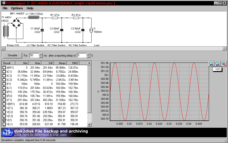

I calculated: 19mA phono + 14mA cascode + 30mA follower == around 65mA
(so hopefully I was wrong with the 30mA...)
Then I knew the choke to be used with max. 160mA...
Therefore I got my values.
Are you calculating mono???
You're around 50mA / channel, twice is 100mA...

find enclosed two sims - one for dual mono PSU ( one PSU and SR per channel ) , second one for common PSU for both channels (one PSU and SR for both channels)
of course that first version is preferred
when I wrote 15 , that was a typo , sorry .

that's main difference between dual mono and common PSU ; those motor run caps are cheap - I reckon no more than 5-7E/pc
I'm still sure that best approach is to make dual mono PSU
you're good with 10H per channel
maybe 100E more , but your pleasure and satisfaction will be multiplied
