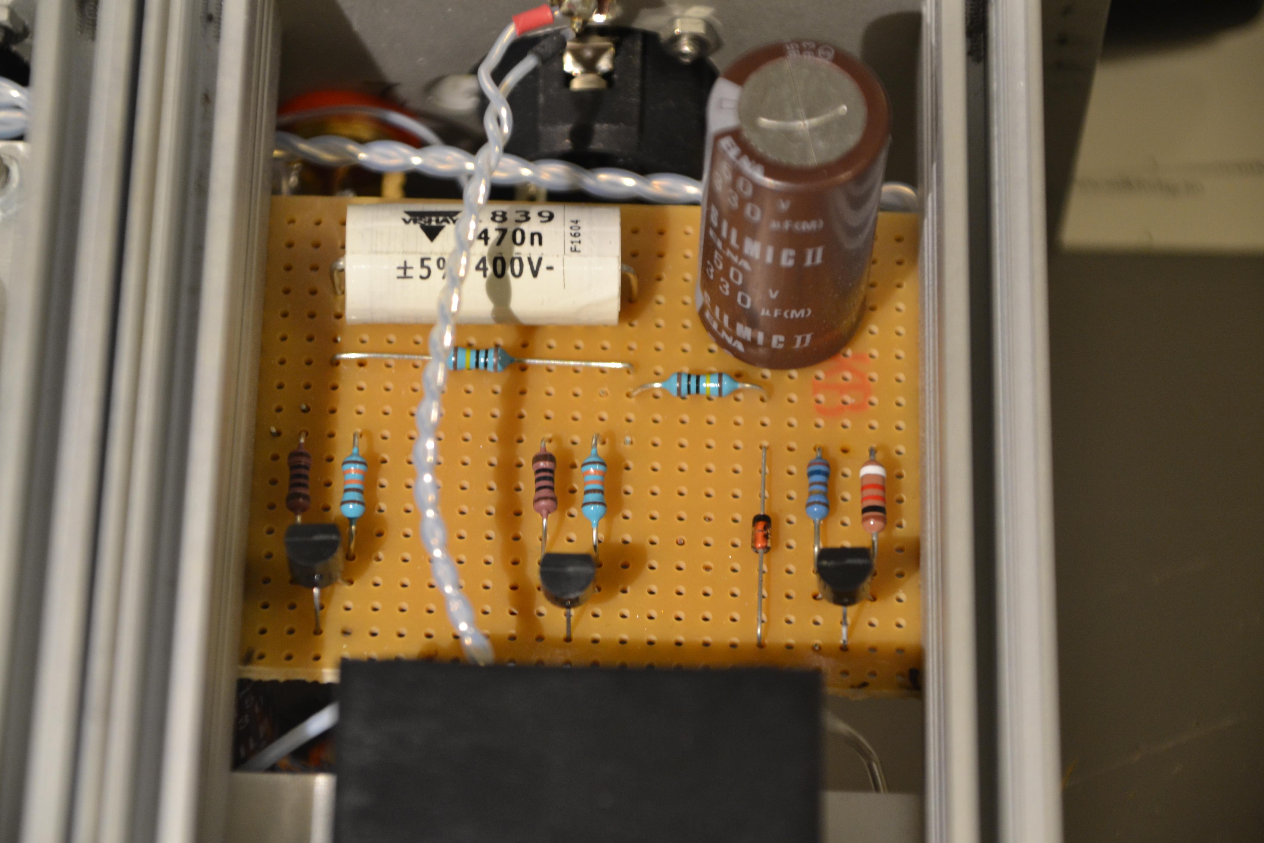

Hi Frode,
Referring to your question under #614 whether to choose 355 or 380 V at the input of the Sreg I can tell you the following from the RTP3D power supply instructions.
The power transformer is specified 420 V AC secondary and it will measure ca. 590 V DC at the output and that is behind the LCRCRC chain without a bleeder and without any load ( idle ) !!
As soon as the load ( the two Sregs ) are connected this voltage will drop to ca. 360 V DC so 355 V should be all ok. Hope that clarifies things completely.
Looking at the pictures of your preamp I also have a question. What is the purpose of those two copper boards located below the original metal phono boards at the back side of the preamp?
This I guess is your own construction as they are not shown in the instructions.
Initially I thought since I can see a pot on the topside that these are meant for impedance or gain adjustment however when looking at the photograph of the backside
I noticed three transistors there as well.
Did you place some parts originally meant to be located on the phono metal boards on these additional copper boards due to space restrictions or why these additional boards
I'm asking myself.

Hello Airtangent !
Thank you for advice and information !
The Board behind the phonostage and in front of the Sreg are the -24 minireg and ccs. As it was so litle Space for all this parts at the original location, I removed them on a separate plate. To build them as modules out side the chassi, made it a bit more easy. The 3 transistors at each modul are Bss 129.
I have also fitted 330 uf at each section, and 2 x 330 uf at line section.

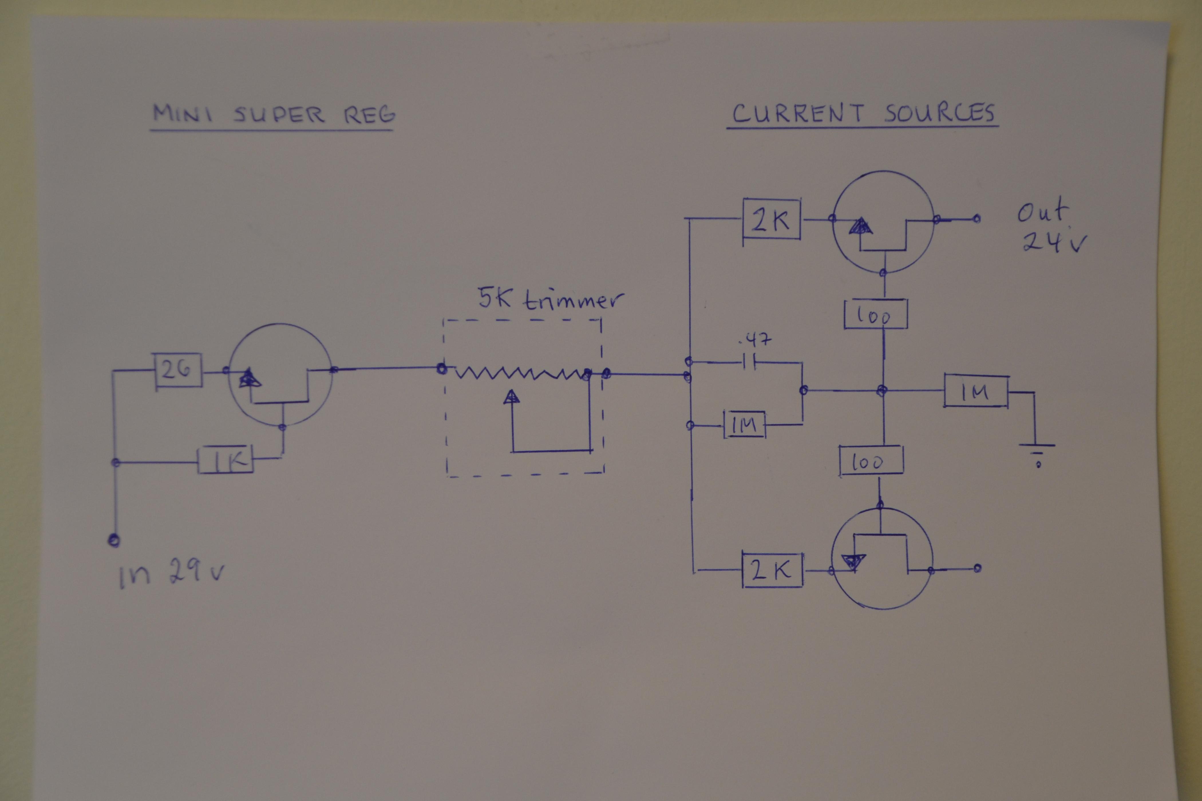

Airtangent !
I forgot to explain about the trim pot I have on these circuit board. As I understand it, the current throu the negative 24 v supply, sets the anode voltages on tube B in the linestage. By increase or decrease the current with a trim pot, you can adjust for exactly 150 v in the line stage, and 65 v in the phono.
I made a schetch to show you were I placed it. If you look at the number of parts at the picture, you wil se it corespond with the drawing.
At the time I ordered parts for the rebuild, I was thinking that a 25 turn trimmer have 5 turns for 1 k, plenty adjustments possibility. To be 100 % certain I did not have to litle resistance, I bought 5 k trim pots. If I were to buy it today, I would have chousen 500 ohm, as I think this is enough resistanse and the acuaracy of the adjustment are more easy.
The blue trim pots next to LM 317 for the heater is 10 ohm. I found out that using a smal circuitboard in front of the pot, made the connection of cable to it easy. When incerting a cable in the houl, it stays tight to the pot leg when solder. It also work great as isolalater between the legs.

I see I forgot the 24 v zener before the 5k pot
It's not at all obvious to me what the pot does! Its function appears to be to insert a variable resistance in series with the CCS, and I don't understand why one would do that.
I would have thought a more useful control would be on the CCS current, and the pot in that position certainly doesn't do that.

Hi Frode,
Thank you for sharing with us the buildup of these seperate copper boards.
My only concern here with these boards is that in case of the phono amps you put them between the metal phono boards and the rear panel.
Considering the fact that phono is the most sensitive part in a preamp ( mV signals )
I would have made the phono board input wiring to the rear jacks as short as possible
and then in my opinion it would have been better to place these seperate copper boards
in front instead of behind the metal phono plates. This will keep wiring between input on the phono board and phono jacks ( Cinch, XLR or Redel ) very short.
This is what is usually done so as well in the RTP3 preamp, see here a photograph from a current manufacture RTP3E ( latest version ):
Vacuum State RTP3 preamp Photo #1073042 - US Audio Mart
You could then easily take the required 29V input voltage from the copper board in front of the Sregs.
Just an idea.
