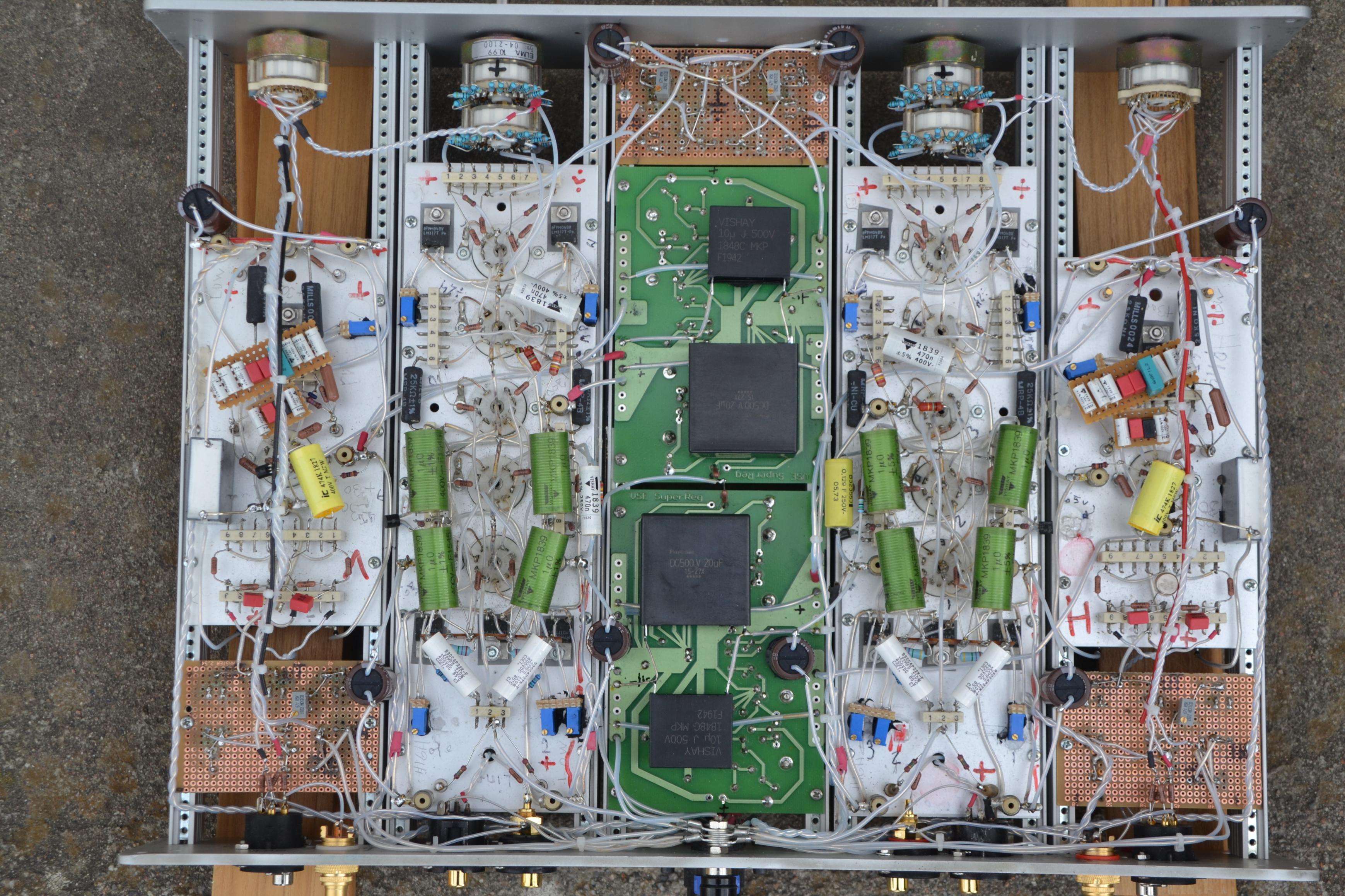

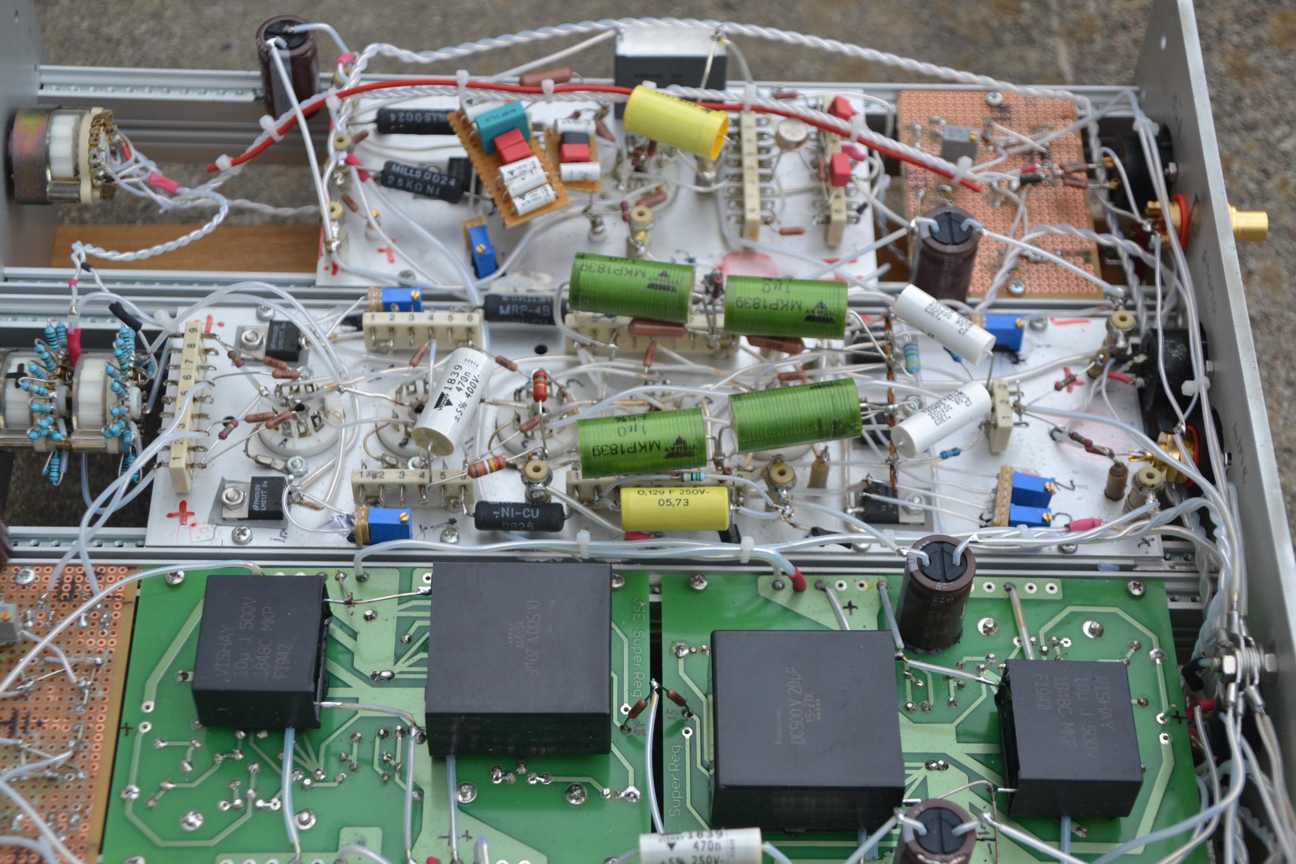

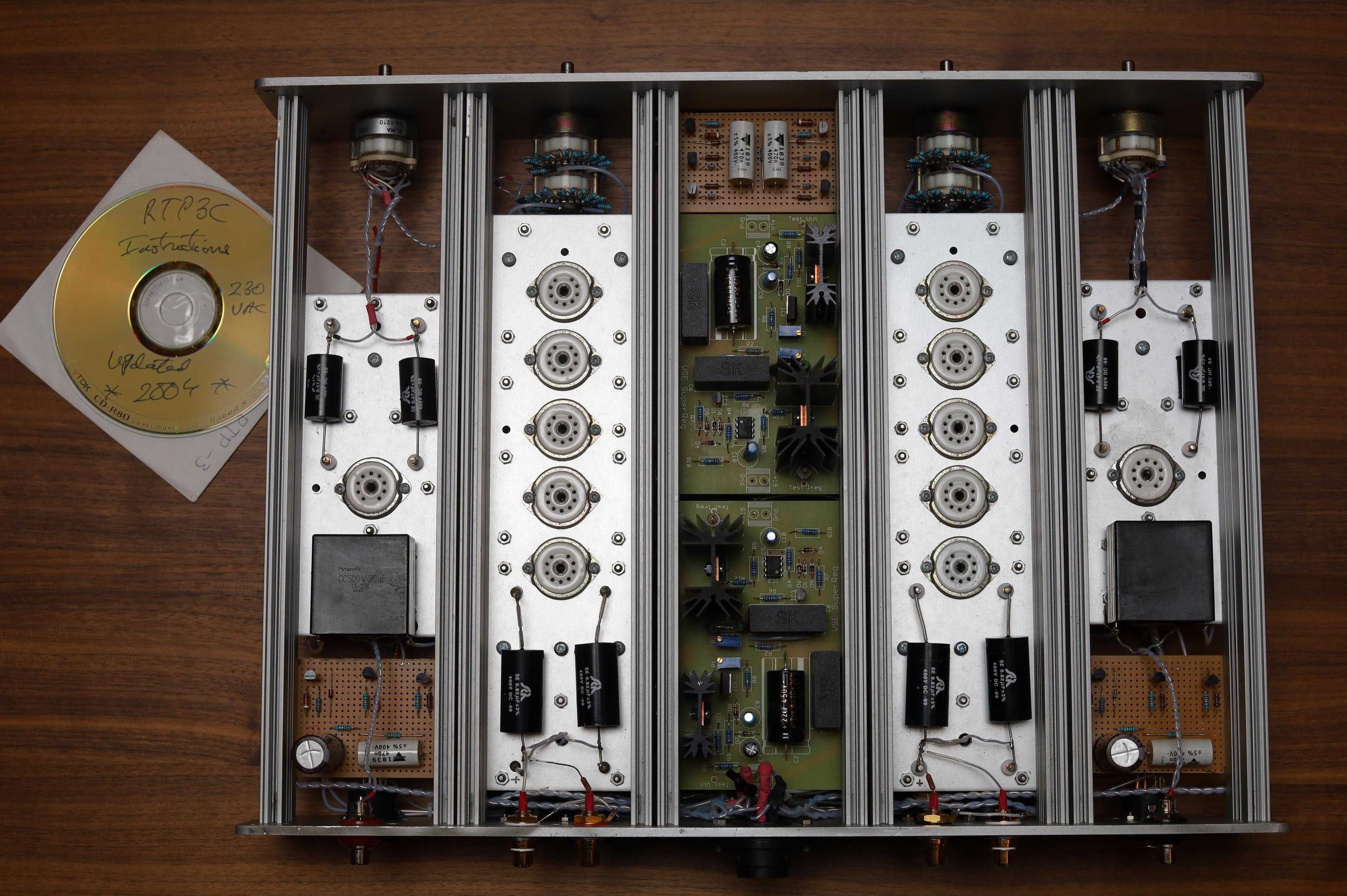

Her is a few pictures of my unit.
It only worked for me by quoting my self.
Sincerely
Frode
Hi Frode,
Are those 3 aluminum clad resistors supposed to be the dummy load? If yes, this kind of resistor is supposed to be mounted on a heatsink in order to reach the designated power dissipation.
Hi Frode,
Hello,
AND if you mount them on a chassis they will need a piece of metal that will be close to the dimensions of your chassis for one resistor. If i remember well it was something like 300*300*1,5 mm aluminium. It will give a big bang when it dies. I have seen it once.
Greetings, Eduard
The 3 big resistors are 15K each, so this cannot be the dummy load. Nevertheless you have to cool them with a heatsink when they have to dissipate a lot of power.
Regards, Gerrit
Regards, Gerrit
