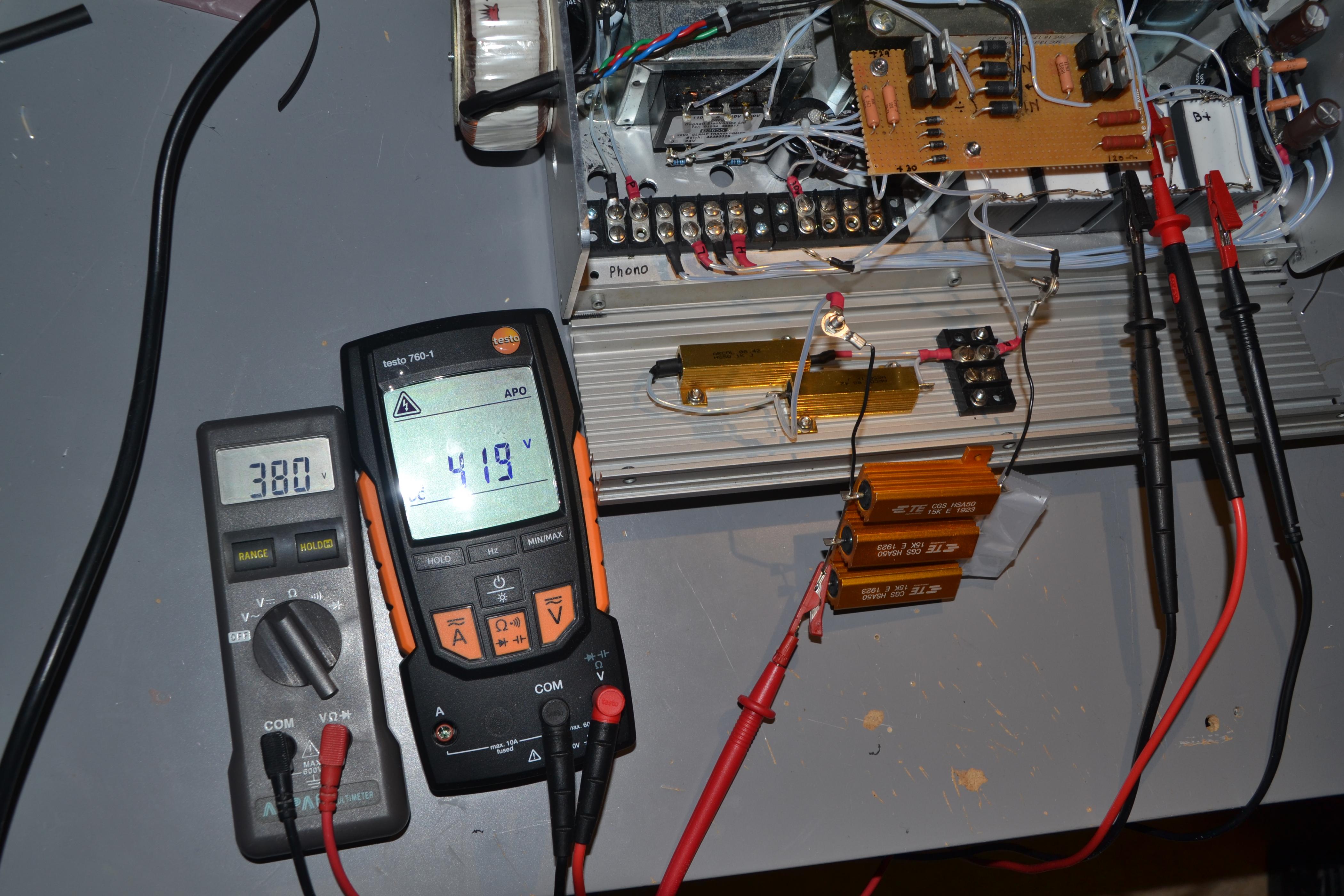

Thank you for the information. If you look at the beige circuitboard over the 4 x 50 uf 500 v polypropylen capacitors, there are 2 red resistors at the right side. They are the 120 ohm between the transformer and rechtifier. the 4 x To 220 right behind them are 4 A hexfreds 600v. The Orange resistor to the left is the 180 ohm you are refering to.
On the left side I have 4 x hexfreds for the -24 v, and the smal ones is for + 30 ( bias for Sreg )
In the center is rechtifier for number 3 heater supply, this is for the phono. This I wil Connect when everything is working.
Today I tryed with some resistors. With 1 k the volt was about 355 and with 2x 1k in paralel ( 500 ohm ) I have about 380 vdc. This is at least inside instruction specificasjon ( minimum 35, and maximum 100 v )
Do you have any input on what to chouse 355v or 380 v ?
This is not a Power amp but could 1k make it a slow power supply ?
Hi Frode,
I wouldn't worry about fine tuning the PSU voltage quite yet. My strategy at this point would be to leave the series resistor in the PSU as it is, and check the voltage once you have the whole preamp running.
Alex

The best move in order to check the voltage drop in the raw PS is to load its output (leaving the SRegs out) with the anticipated load of the actual preamp (plus shunt currents in the SRegs). This way, you can check the actual output voltage of the raw PS that will feed the SRegs and fine tune it accordingly in order to get circa 340 V at the input of the SRegs.
Just my 2 cents here.
Evangelos
