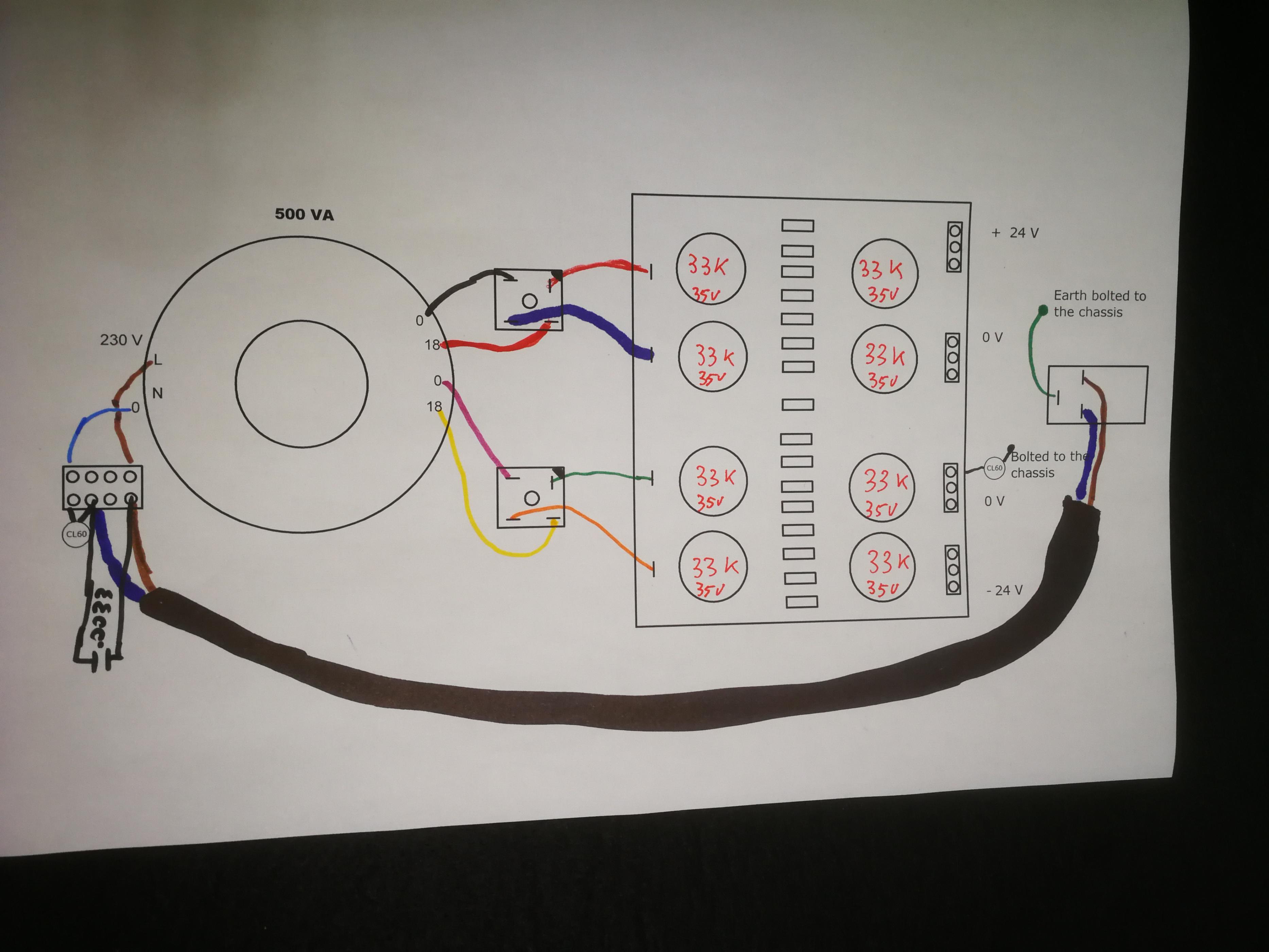

Hi, I designed a mounting layout for the PSU, I wanted to know if the CL60 thermistors are positioned well, is the first inserted on the neutral at the input, or should it be inserted on the Line?
is the positioning of the Capacitor from 0.0033 uF right between L and N?
The second output thermistor connects a PSU ground to the chassis .. is that right?
or is the second thermistor not needed?
(I attach diagram and datasheet of Toroidal)
Thank you.

Hi @triksters.
The first thermistor is usually put on the live wire (though it would not make a difference if you put in on the neutral, I think). The capacitor is ok. The thermistor on the PSU ground is also ok. Put the ground wire from the IEC connector to the same bolt on the chassis as the other end on this ground lifting thermistor as well.
If you research a little bit on „earth“ ground „bolt“, you will find quite a few post (of experts) which very clearly state the the earth (from the IEC) must have its own bolt, not even earth bolted (screwed?) separately on the same bolt (screw?) is good. Safety-measures, perhaps legal stuff, not technically…
Just my 2c
@myleftear, I'm not sure we talk about the same thing, but I always saw instructions like that: put earth wire on the bolt first and tighten it with the separate star washer and nut - so that when you put other ground connections on top of it (on the same bolt) you should never make loose the earth nut and always have the earth wire properly bolted to the chassis.
Yes we talk about the same thing, and information is conflicting…
In the end, it’s your build = your decision :cheers:
