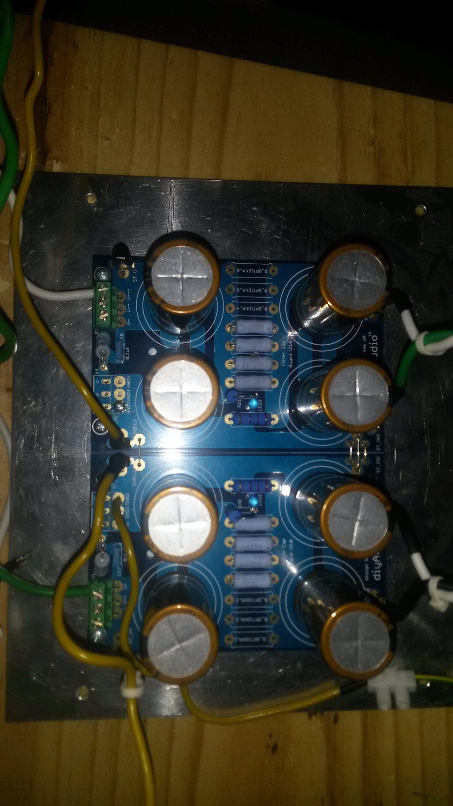

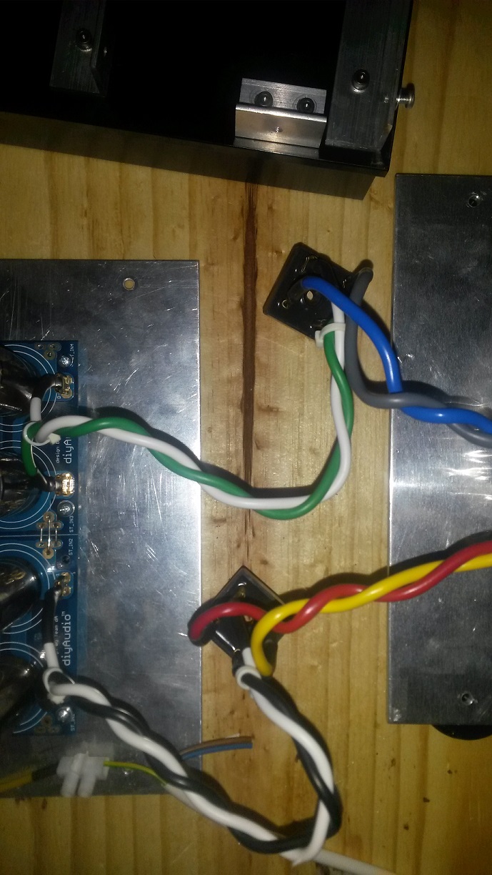

hi guys,
I have a question about the PSU ive built, I used the V3 board of the diyaudio store and i'm using it for a Aleph J built. The reason why I post this question is because when I finished the build i stumbled into a hum problem I would like to get rid off. So far the background intel .
I dissasembled the casing ive build and laid out the whole on a table, next i connected the transformer to the psu and the psu to the Aleph J boards and the speakers to the speak output (nothing connected on RCA) and fired up and all lights got up. Ive noticed severall things:
1- light hum on right speaker (ignore this for the moment because this isnt the right place for debugging this).
2- the transformer buzzes, noticable when my ear is 20 cm off.
3- a buz from the psu board.
i tried a couple of things:
1- dissasembled the on/off button. no changes after this action.
2- dissasembled the NTC thermisters, i use these for a slow start. no changes after this action.
3- waited for a 15 minutes to warm everything up, maybe just a buzz when all the caps are empty. but even after 15 minutes the buz of the transformer and psu are still there.
4- disconnected the Aleph J boards, no buzz form the psu board but transformer stil lightly buzzes.
Am i going insane here? is this normal or are these buzzes mentioned above coming from DC on the mains??
I used the standard bom material except for the transformer, its a 500va Amplimo. caps are nichicon 15.000uf.
I've made some photo's i will try and upload these in a bit.
hi guys,

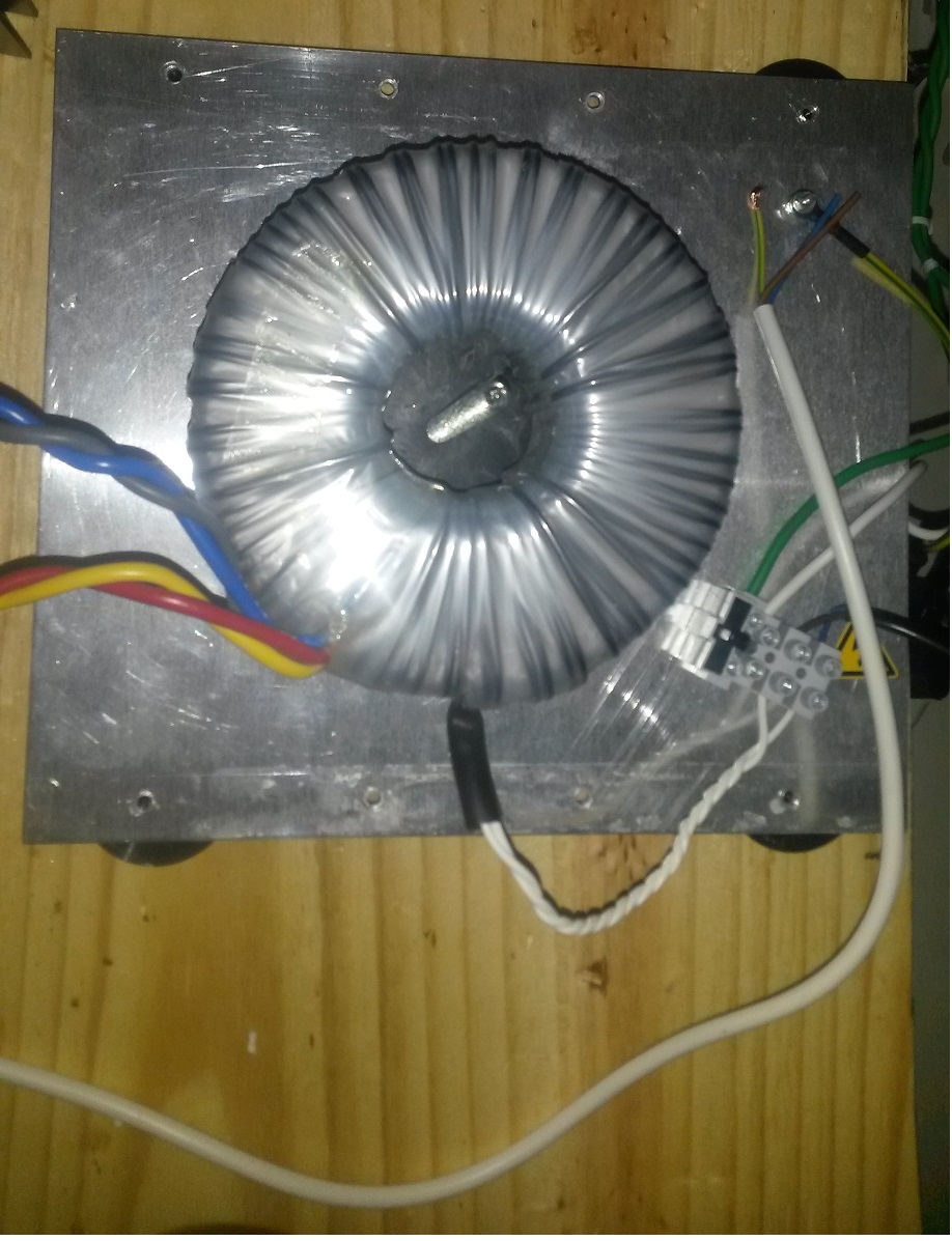

The wires in a transformer windings pass pulses of current.
When wires pass current in the presence of a magnetic field there is a force on the wire.
Pulses of current will give pulses of force.
Opposite polarity pulses will give opposite polarity forces.
result: the wire moves.
If it's surrounded in a stiff medium it won't move much. If it's able to move in free air it will move a lot.
Movement is vibration and that is audbile if the movement coincides with the 50/60Hz, or it's harmonics.

dear andrew,
thanks for your explanation, I will bolt the transformer to the bottom plate and check again, so if I understand you correctly, a transformer will hum Always a bit because of the polarity forces?
but what about the hum from the capacitors, do i have to worrie about that?
