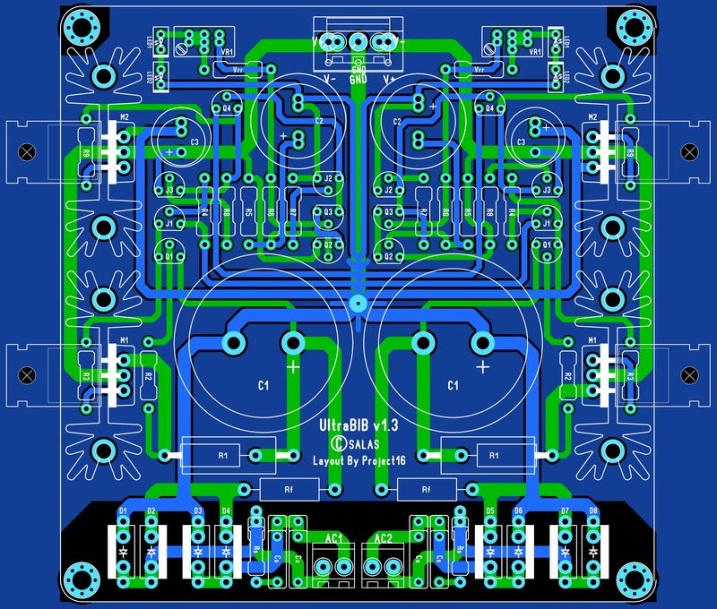

For those who would be interested, the gerber files of my version are available.

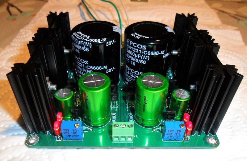

HI all.
Here are the .LAY and gerber files for the UltraBIB 1.3.
In the archive there is a REV-1 with some improvements, especially at the level of the capacitors C3 which are too close to the mosfets or then it will be necessary to choose capacitors 105 °. The best is to choose the REV-1 version.
The picture shows the initial version that works perfectly.
  • UltraBIB - v1.3.zip
