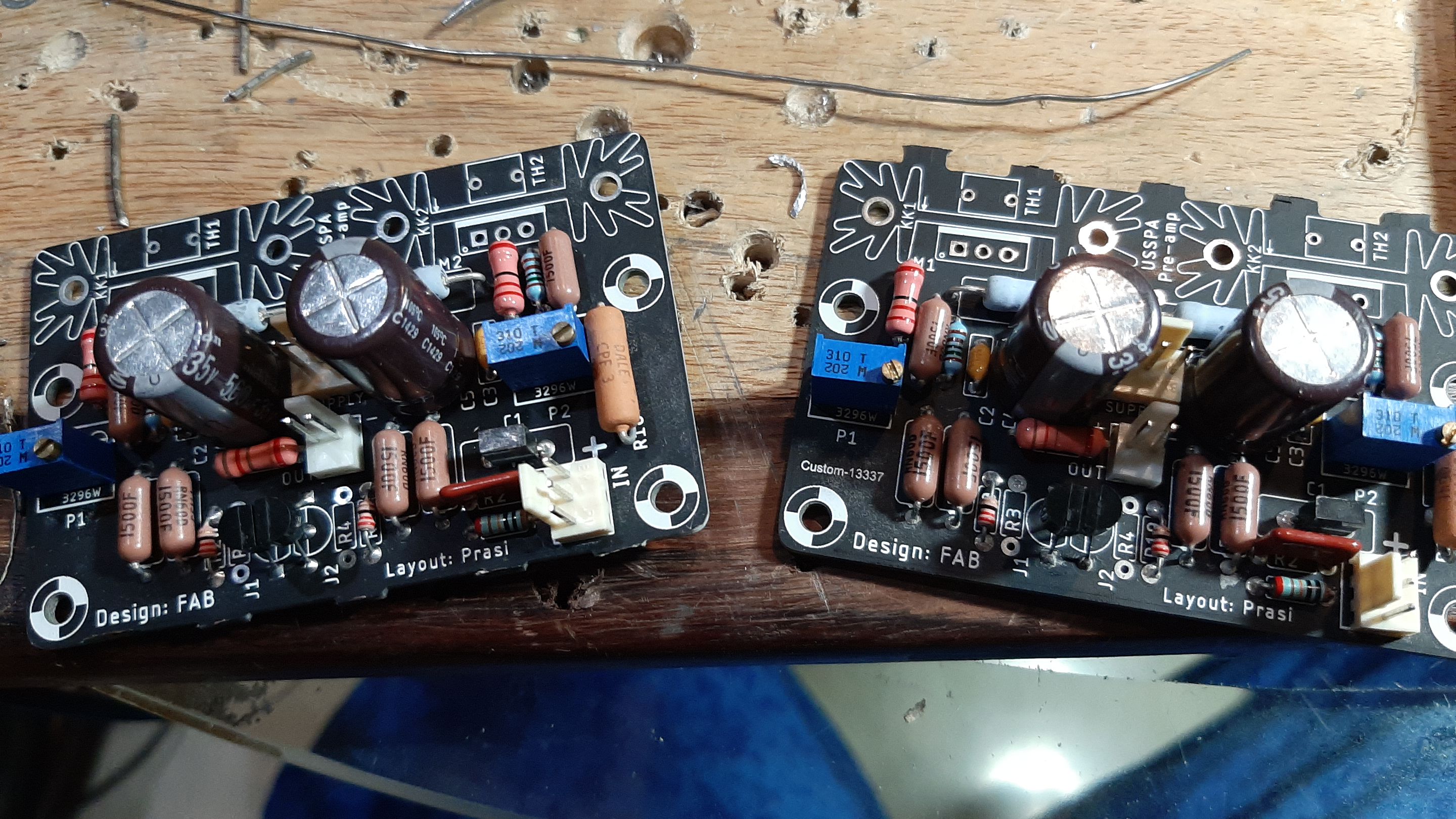

Yes it will be my 2nd usspa.
I made so I could play with to a friend with high end equipment. He was so impressed with the last one and asked for a unit to be parked at his home. He is using single ended tube.. So it's something different. It's like.. Expensive better? Sometimes nahh
This will be integrated with rjm emerald phono. That's a good project.. If anyone care to diy a phono. We also tested with some of the best.. No problem with quality.
With a switch for cd and phono, so it will be easy to compare later.
Perhaps this time.. I will try studer 900 power supply. Then make a comparison with other supply since the supply will be on separate box. Easy to compare. But need rebias everything with every change
I made some material change.. That guy have a very revealing and clean sounding system. So soften it some with carbon resistors. And a slightly more dirtier supply. He got all the slam already one could wish for so...

I'm not using kemet cap this time.. Want to sound less clean and see how it goes

Hi AnthonyA
The specified power supply caps combination has been selected (from Nippon Chemicon white paper) for optimal impedance response against frequency band. Your new cap should also work even though not optimized:rolleyes:
Without knowing exactly what you mean by “less clean” have you tried to modify H2 level using one optional resistor as per section 7 of the manual?
I thought that the goal was to be clean;)

. I will learn how to adjust H2 using scope with my friend later. The jfet is getting scarce so it's not very tightly match, could only manage 0.6ma diff . Will be better I learn to use the oscilloscope.
Darn.. I should have ordered the caps with u.. Lol let's light it up first

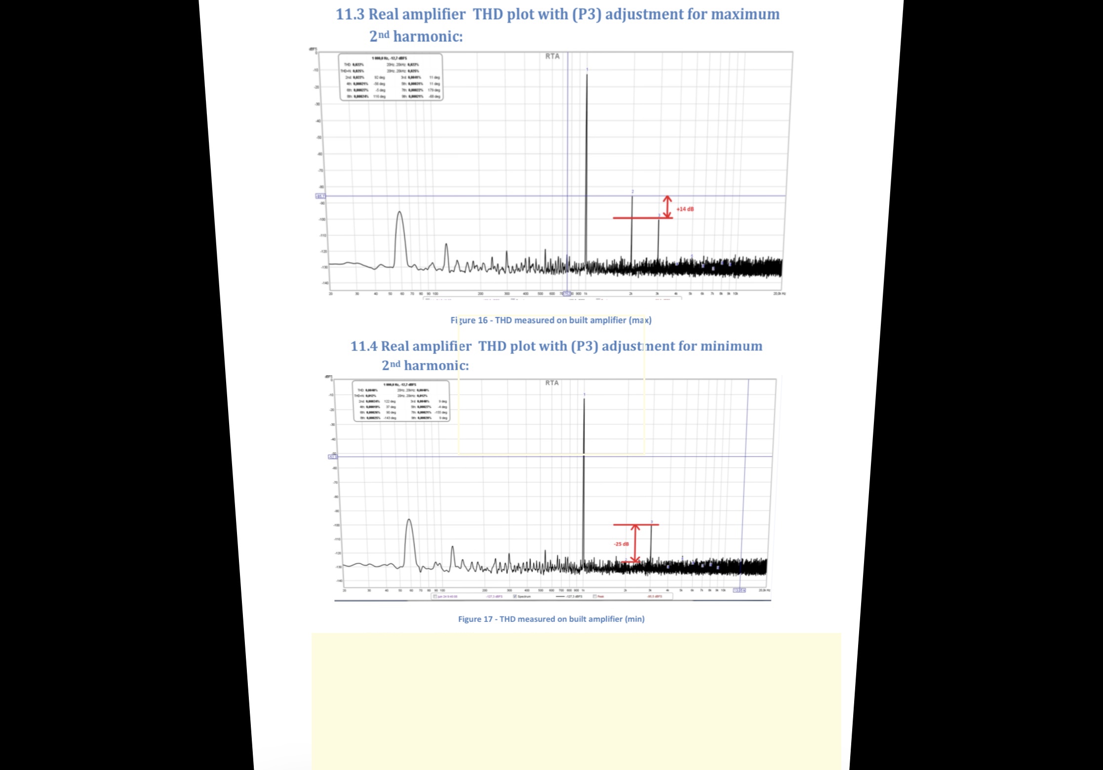

Hi AnthonyA
The scope function will not show H2 unless the scope has FFT function.
Your jfet are very well matched if they only have 0.6ma difference on IDSS ;)
You should have reduced H2 with that good match :rolleyes:

Yes as per section 7 of the manual, only one side at a time should be adjusted but you can install 10k ohms pot for each side and set to 10k ohms for both to start with. Afterwards start reducing the value on one side only. The noticeable effect will only show once you reach less than 1K ohms or less. You may have to readjust dc offset during that process.

Hi AnthonyA
See below extract of USSA3 power amp manual. The USSA3 has a similar front stage as the USSPA thus should behave similarly for H2 adjustment.
One of my USSPA has an FFT similar to the one shown here but without R19/20 installed.

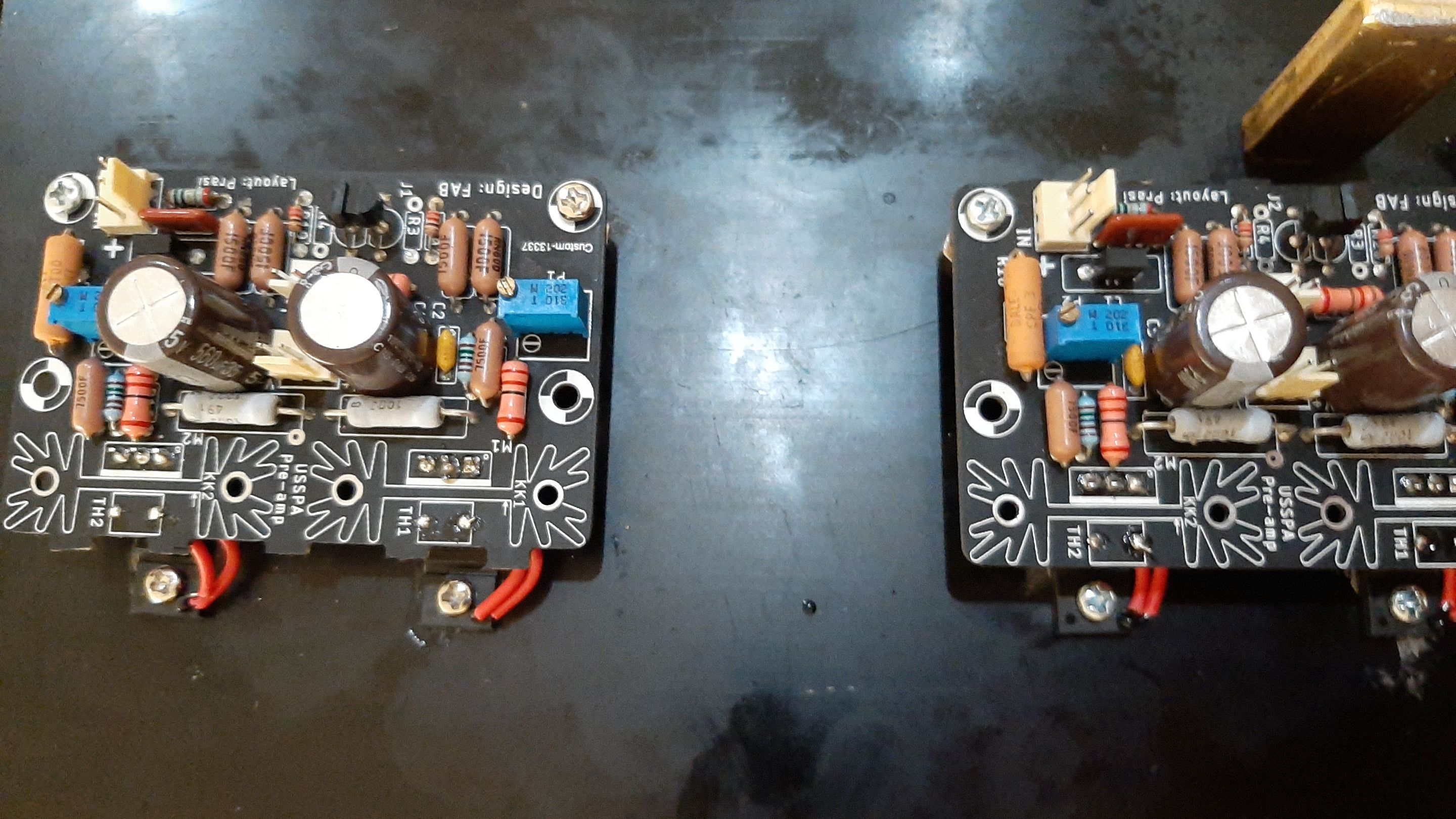

Hi Fab sorry for Dumb questions as u know I know nothing much.
I haven't mounted the pcb on fssa.. So when is a good time to tweak it? Also it's a bad position once all box installed its very difficult to reach for the trimpot
It's only adjustable for positive h2 on both usspa and fssa ? Or both positive and negative?

Pot on a pcb always makes it difficult to adjust once board is installed in the amp...
You can tweak it with heatsink installed horizontally.
Depending which side you use (positive or negative) it can go either way but probably not symmetrically because without adjustment you have already H2 present on a polarity thus less margin to increase H2 on the other polarity.
