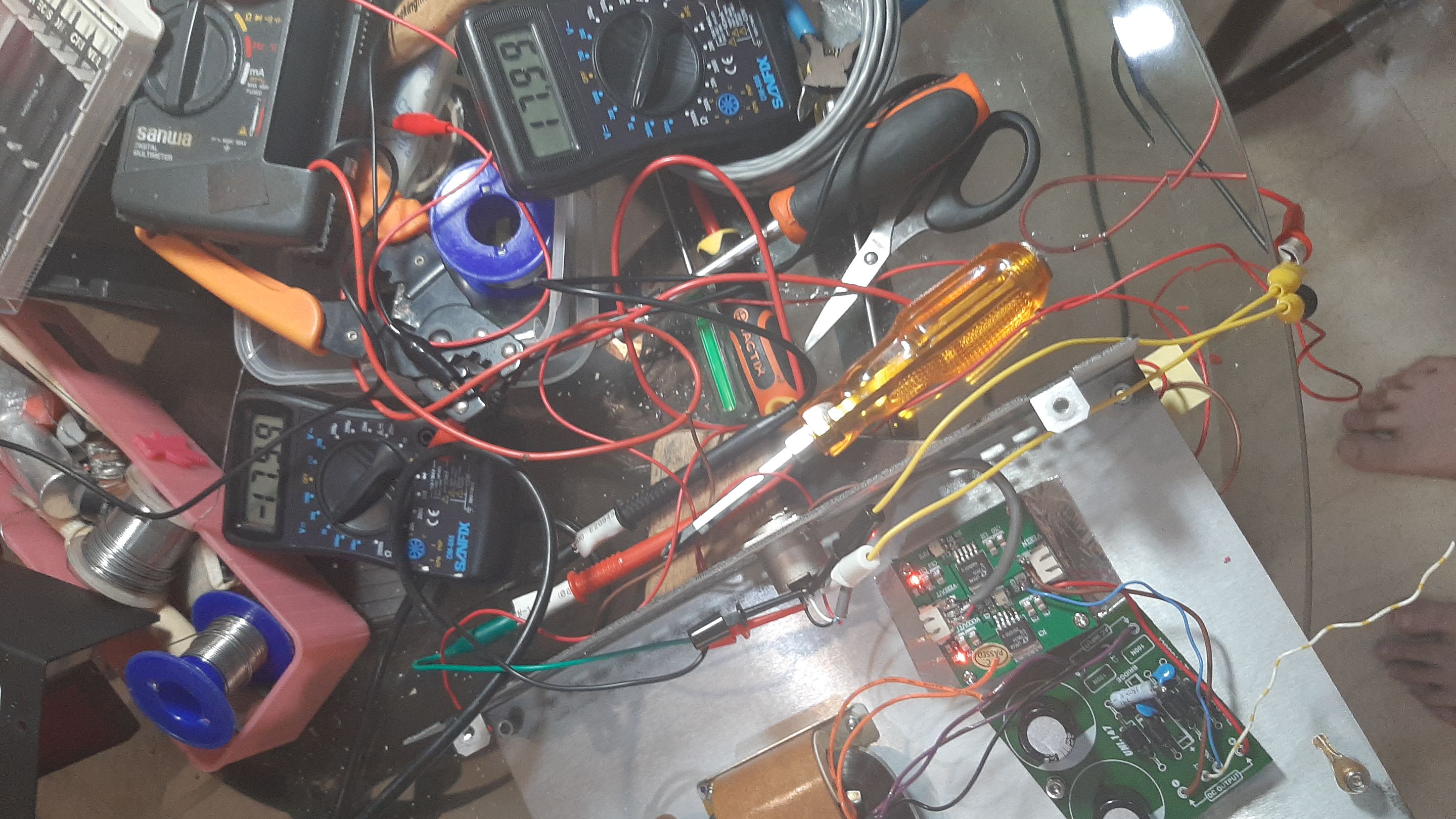

USSPA Build thread
Oh well . It's alive .
Fab .
First impression .
It's similar but different
Usspa 2
More zing and grunge.
More muscle
Less delicate and smooth less airy .
More bass especially upper bass
Better for jazz .rock .
More slow and heavy .which bring out the swing and groove.
3d . Stage ..is there . But I think there is a slight difference in stage size and presentation .will see later
Quite similar to the impression I got from my friend
Input change to 100p that's a good move .more lively
I like it ! Good to have both.
I'll have more in a month or two .
Chiao
Lt1963/3015
Wider deeper higher Soundstage. No frills. Smoother sound
Studer 900 more mascular. Hint of pro audio sound. If u use this... Pre burn in 72 hrs before final setting. Sound a touch quieter
200ma per channel
OK! About 200 hours of burn in.

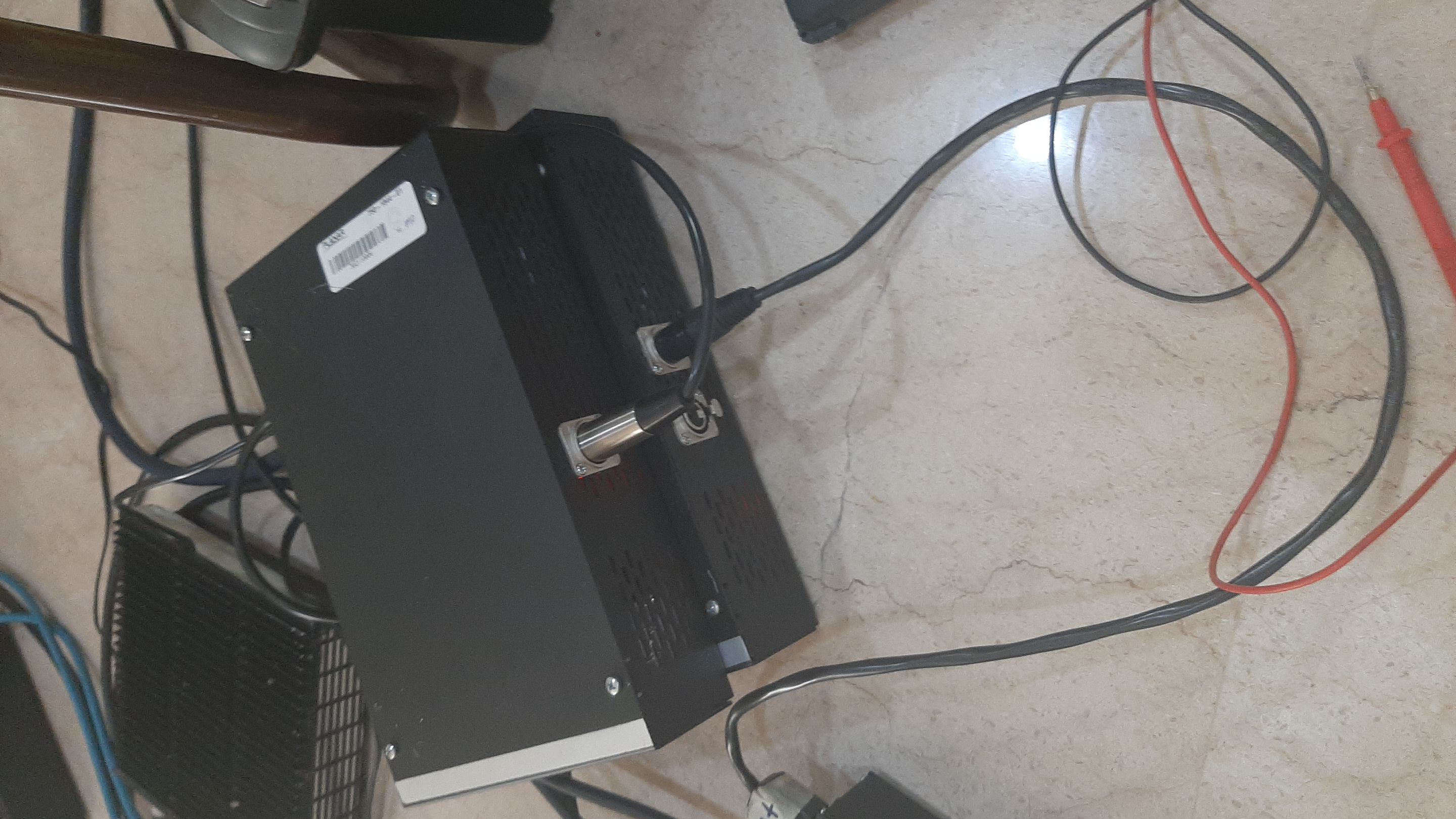

I plug into the more clearer and better system (I got 2 listening areas) to have a listen. I'm familiar with the setup so should be decent review
the initial impressions is correct.
Just additional note.
The depth is clearer with usspa 1
Sound is neater and true with usspa 1 better instrument distance
Width usspa 1 better
If after accuracy clarity smoothness .listen to classical and acoustics alot. Version 1
If after grunt. body and weight, listen to more rock. Audiophile version 2. If room is small this will shine more (3m wide or shorter)
If you ask me which is more special.. Usspa 1 is more hi end, the wall dissappear more in a bigger room
Also.. Lt 1963 is still champion. Sounds better.
Last note.. 18v is slightly better than 15v
The caps also I had one set of poly and 10uf bypass smd at breakoff so should be fairly similar just some difference in tone, supply is also similar . Solder also similar .
Usspa 1 is more overview we see everything
Usspa 2 is more spotlight you feel into the music more
Does that make sense to you?

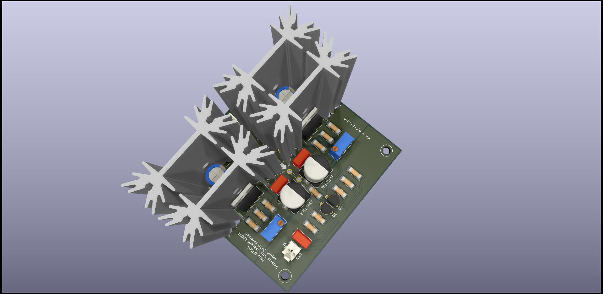

Just for fun and for a bit of praticing doing board layouts I've done my (virtual) version of the USSPA... With LDOVR.com LT3045/LT3094 onboard and MELF-resistors - mounted on both sides of the board and with clear PGND-area and SGND-star. Boardsize 76,2cm x 69,2cm :deerman:
(no, I won't provide production files...)
