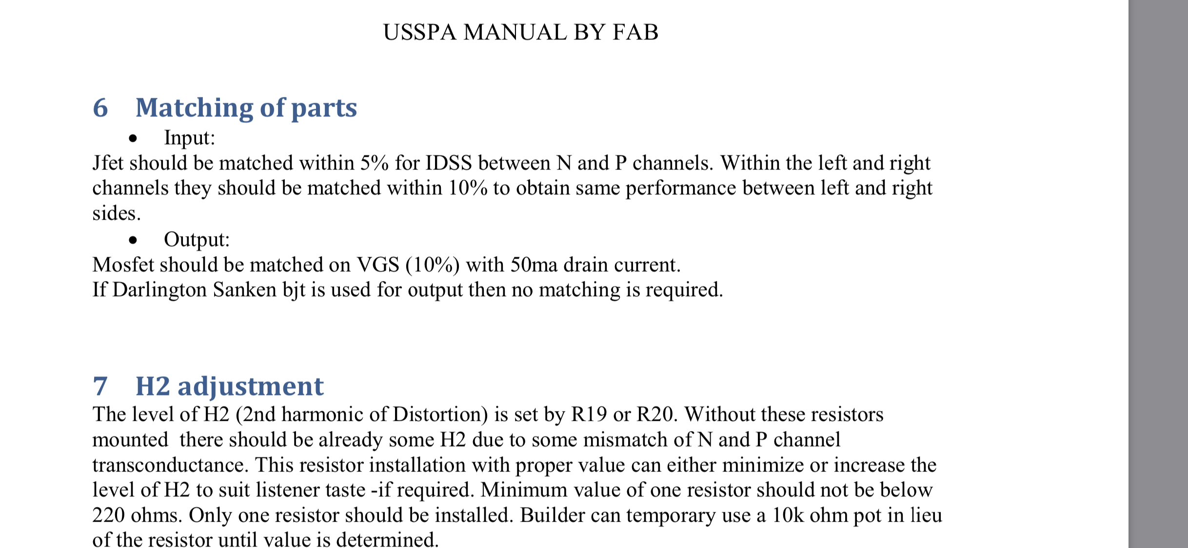

Yes thanks. The reason for the manual is I need to know regarding transistors matching criteria and options for the transistors if I could look for common type instead of the obsolete one.
Hi
Input jfet can only be LSK/LSJ equivalent instead of 2SK/2SJ because Linear Sytems still produce parts. For USSPA1 there is no equivalent for obsolete mosfet but some members here still have them.
For USSPA2 the output bjt is still in current production so no issue here.
See below manual extract for active parts recommended matching.
Fab
