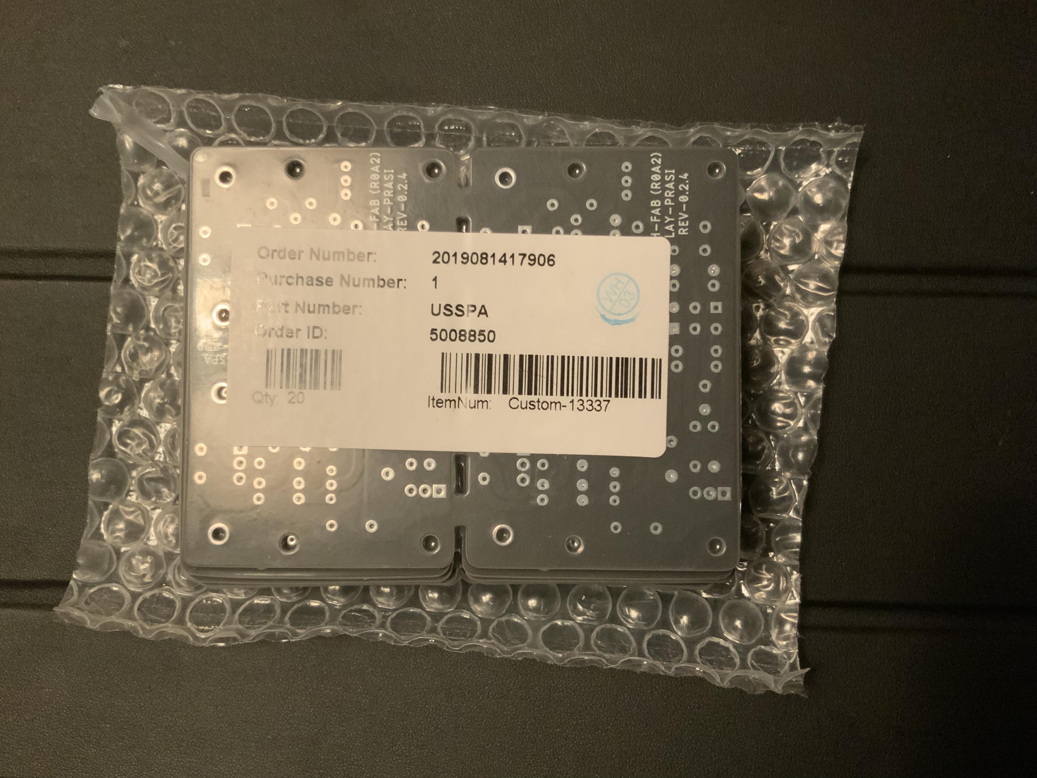

All USSPA pcb of the small group buy are at the post office.
Let me know once you receive the pcbs.

Hi Fab,
I received the USSPA pcb’s today, thank you.
Very quick shipping from Canada!!

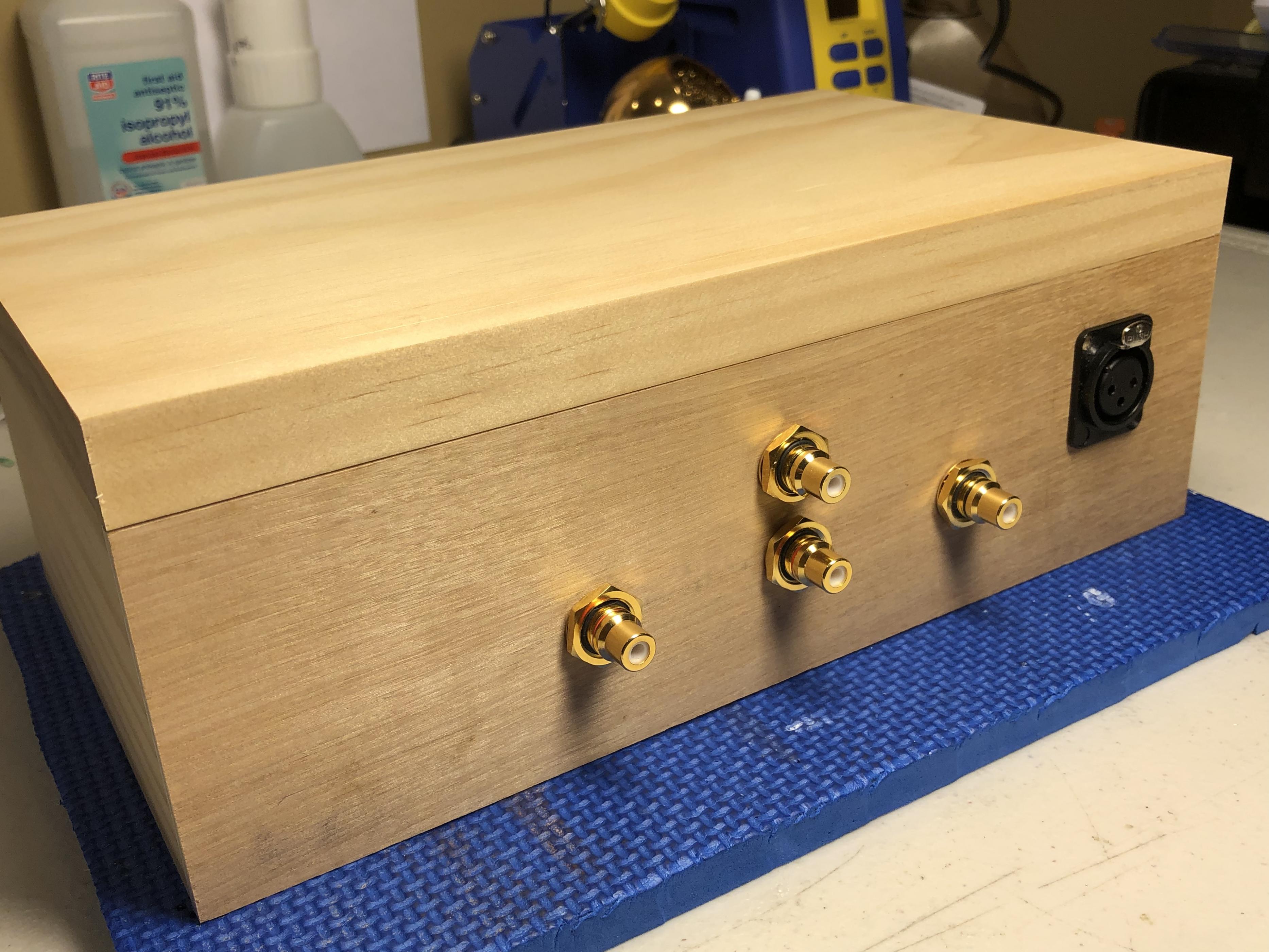

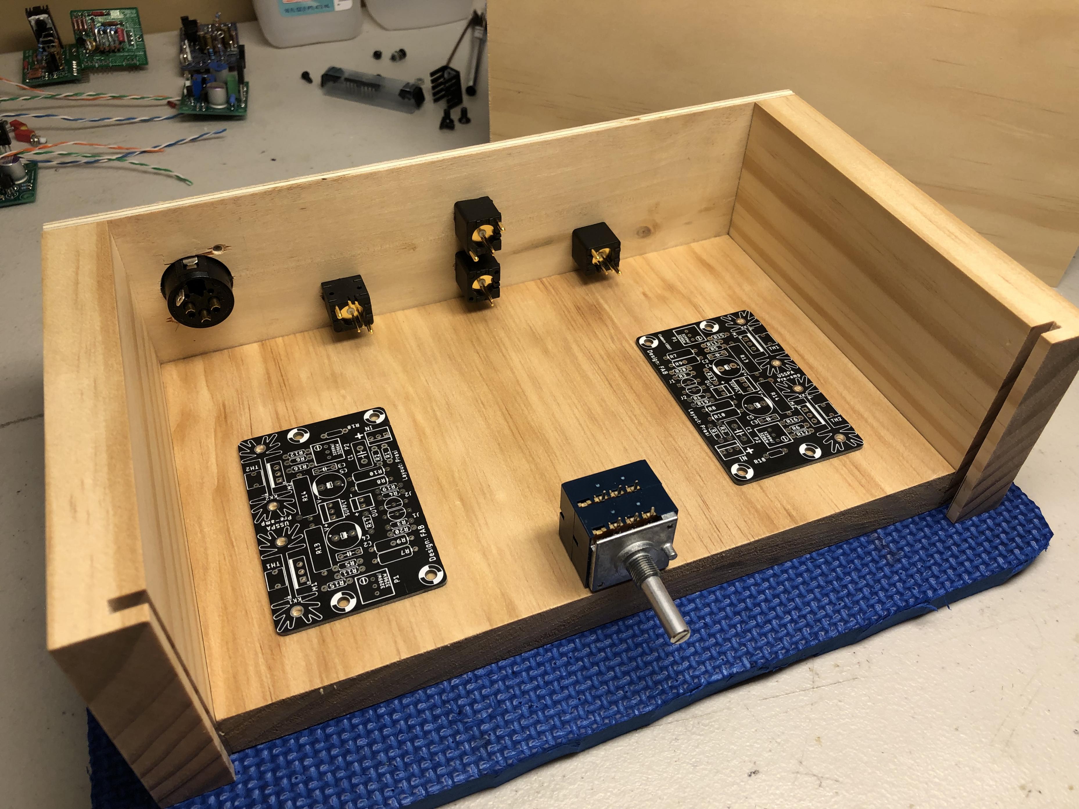

My aluminum chassis will not arrive for a couple of weeks so I threw together this little wooden case, it will have an aluminum front panel also. 🙂
