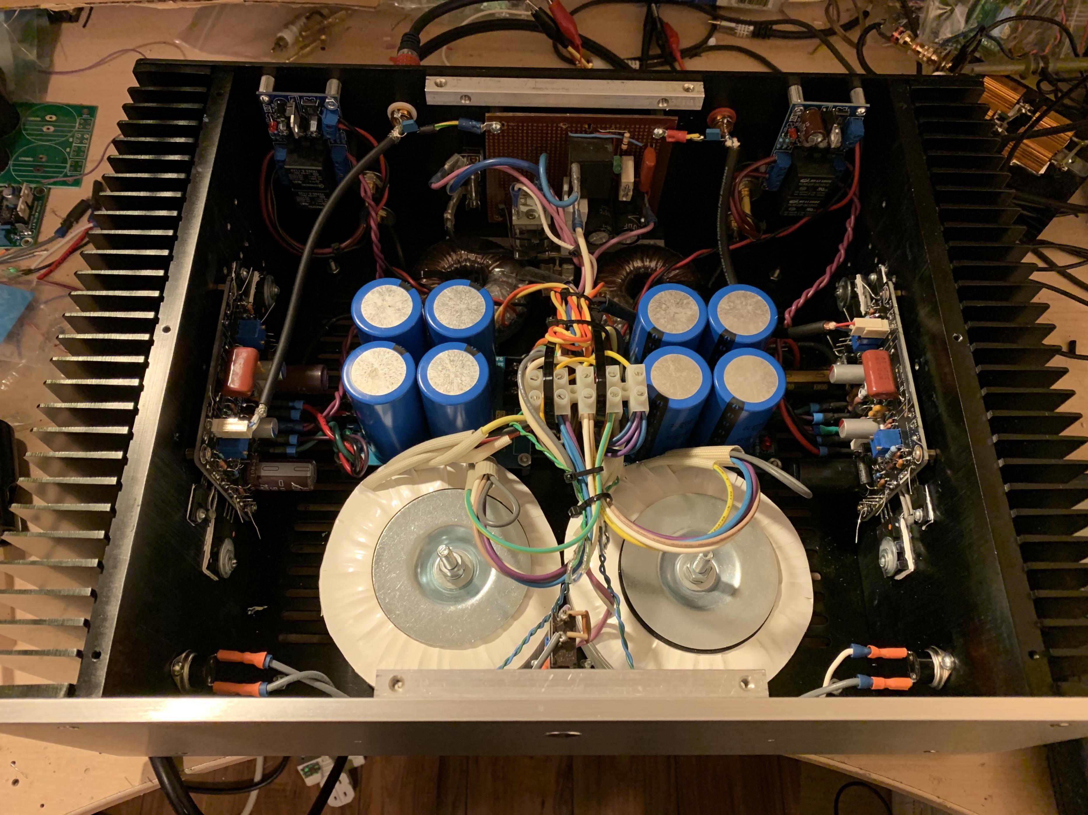

Hi Fab
I can see a small blue box capacitor connected in series with the RCA input ground to a PCB board. What is this connection for and what is the perforated board with all those components?

Hi manniraj
The caps are installed between input RCA ground and chassis via a pcb mounting screw( in that case because it was convenient and worked fine). It reduces the background noise furthermore by creating an AC connection to chassis. DC connection to chassis from input RCA ground may create ground loops depending on the overall grounding arrangement.
The perforated pcb is simply a soft start circuit that I built many years ago before such boards were readily available on the net...
this amplifier chassis is not new and has seen many different amps over the years...😉

Thanks Fab, I have never tried a cap on the RCA input ground to the chassis even when I had hum coming in the amplifier. Looking at your suggestion I think I will also try to make this on my amps where I get some hum. What value is the cap?
Hi manniraj
The cap value I used for that function is 100nF. The location of the connection to the chassis makes a difference too. The cap mainly reduces the « hiss « noise of the amp, not that efficient to cure a big hum problem though..unless you replace a direct DC connection to chassis causing the hum by this cap.
