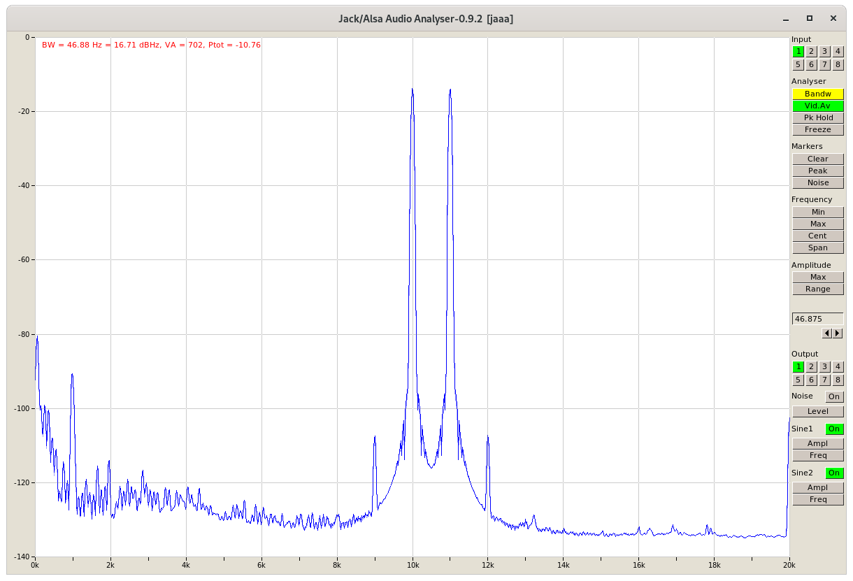

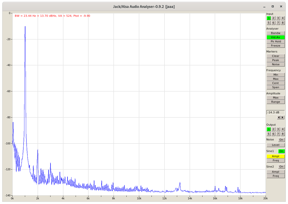

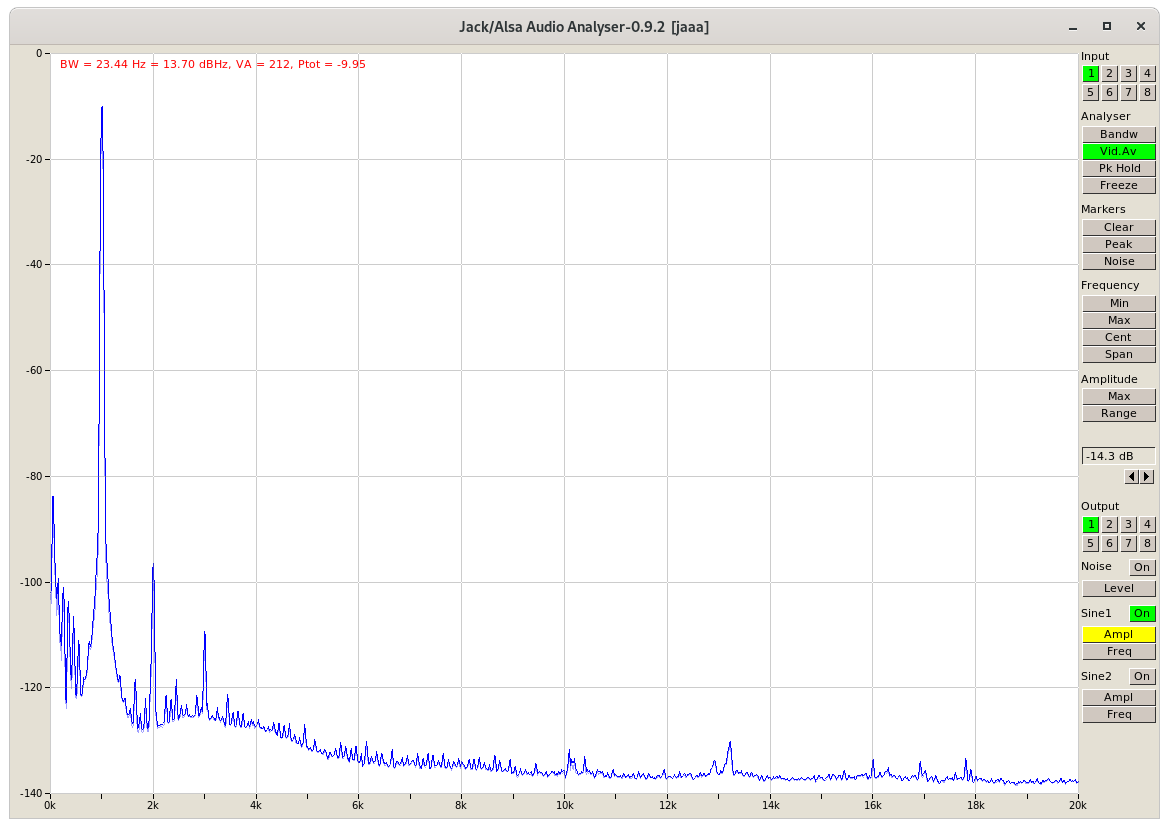

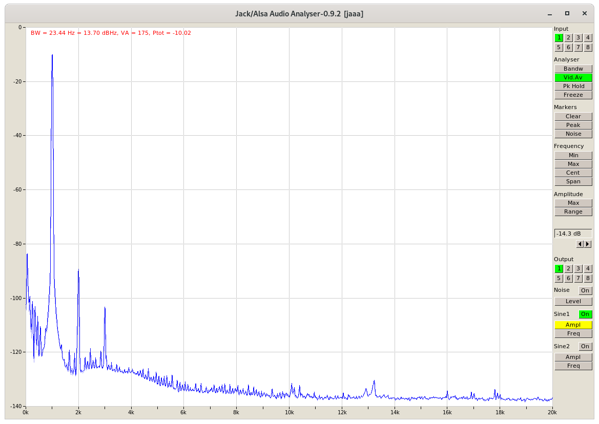

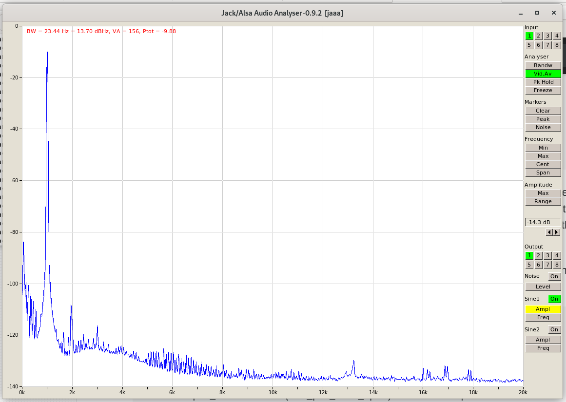

Here are some measurements from the test setup as shown in post 1500 (dummy heatsink with lots of spaghetti). Bias points were adjusted as described in post 1506. The amp was running on +/- 25 VDC from cheap lab-bench PSUs. Measurements were done at 1 Vrms into a 4 Ohm load. The output bias was set to 0.7 A, 1.0 A, 1.5 and 2.0 A (IMD was measured at 1.0 A only).
Not surprisingly, higher bias gives lower harmonic distortion. THD is very low overall, and harmonics show a very nice decay with 2nd higher than 3rd (and higher harmonics are below noise floor).
Looks good to me! Thanks Fab for this nice amp!
P.S.: The output DC is rock steady within single-digit millivolt range if heatsink temperature changes. The temperaure compensation works perfectly with the lugged thermistor part!

I start my own THD measurement at 1Wrms but your measurement appears consistent with mine so it is excellent at this stage. 🙂
Note that the possible long wires effect should normally not show on such THD measurement. Only 10KHz square wave with RC load and check with scope will normally reveal for sure such an issue - if it is really the case of course. I see other amplifiers using a correction network close to the output mosfet to “patch” this potential issue. If you can manage to have it worked without it then it means my amp is really permissible to long wires...😉

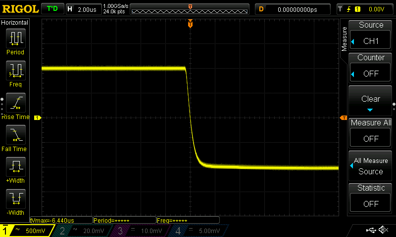

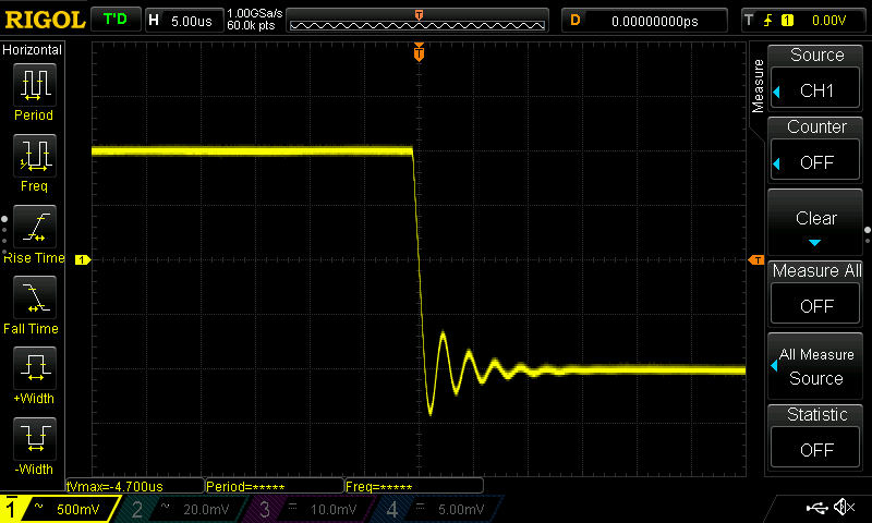

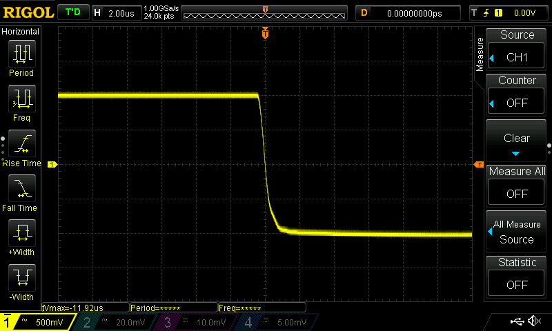

Here are the scope shots for R = 4 Ohm with C = 1 uF, 0.1 uF, 0.01 uF, 0.001 uF and no-cap. Note the different time scales (shown on top left).

Good response to square waves Mbrennwa :wave:

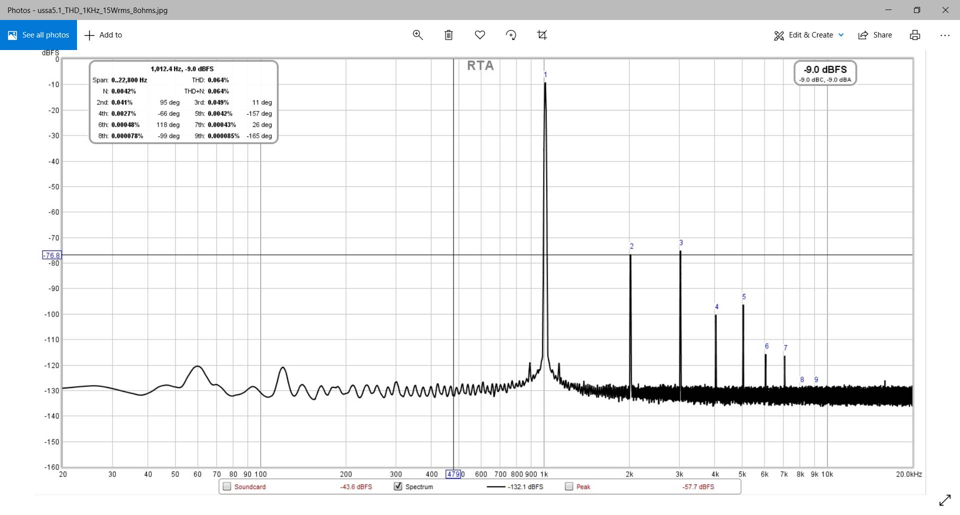

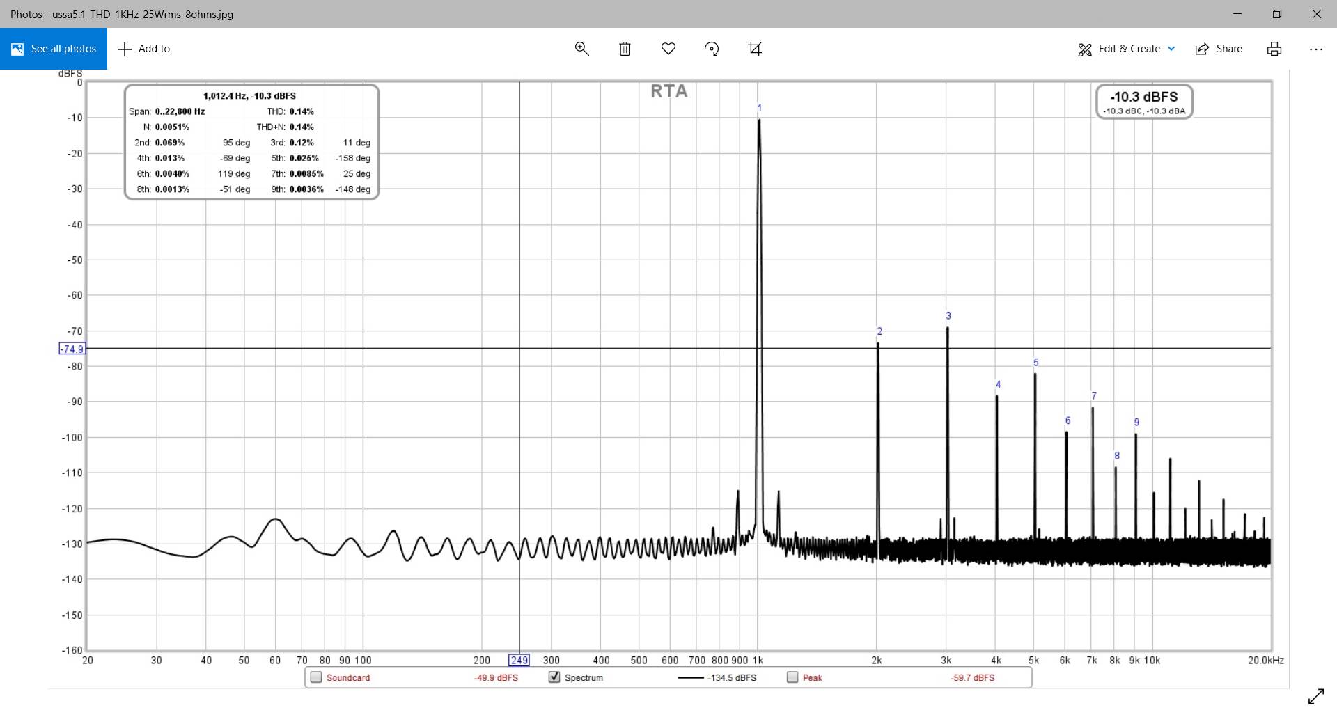

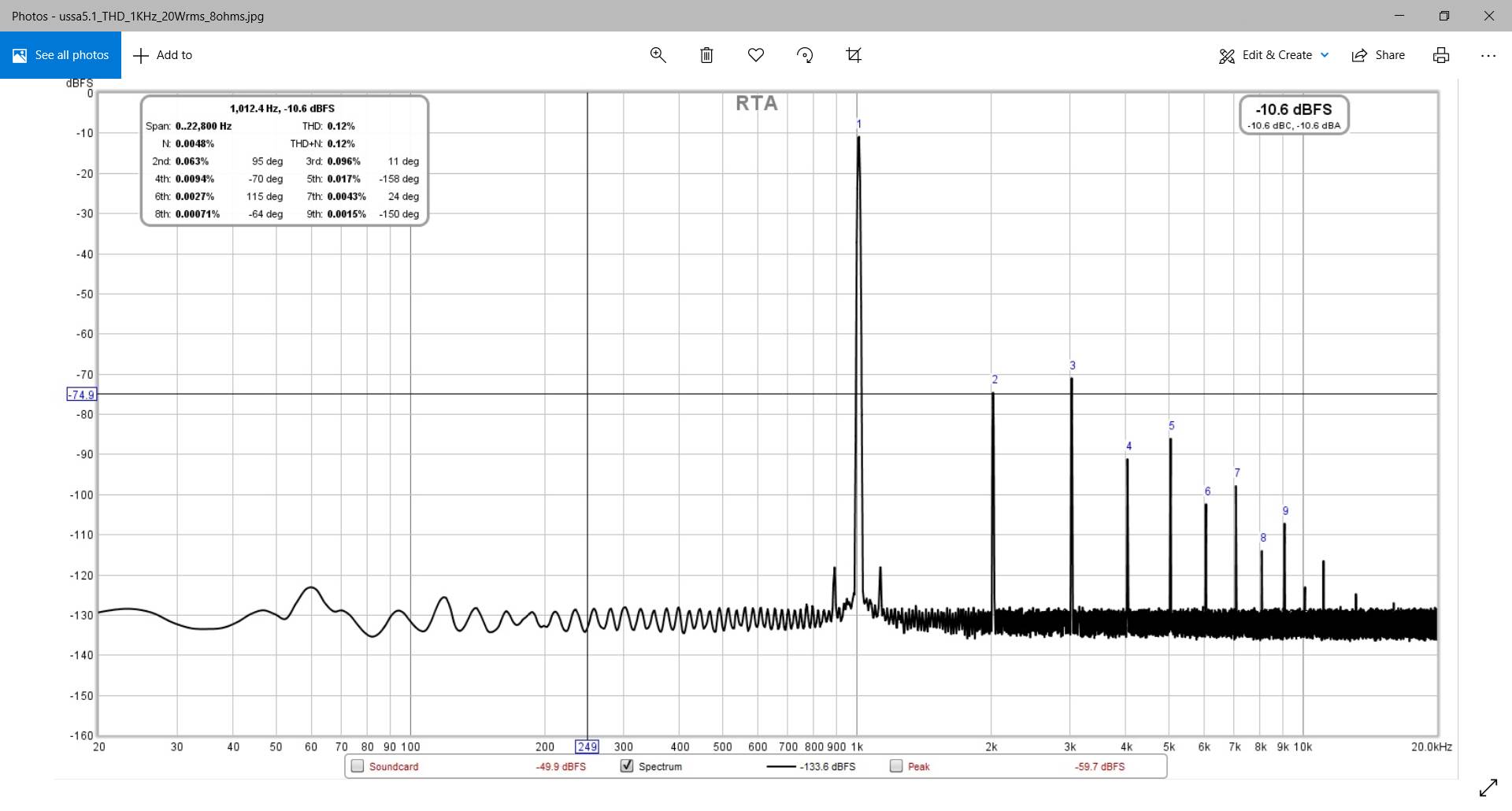

For THD at higher power these are the curves I took earlier this year for USSA 5.1 (which is very similar to original USSA 5).
Included are for 10 to 25Wrms at 1KHz at 1.25A bias. I do not have a low THD generator for 10KHz but being a low feedback factor CFA amp the profile should be quite good.
For 6W and 1Wrms the curves are in the manual where only H2 and H3 are over the noise floor with H2> H3 at lower than about 8 Wrms or so.

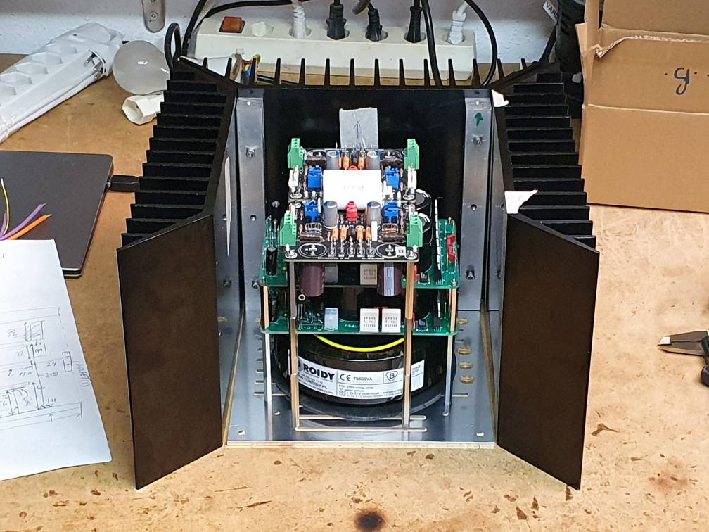

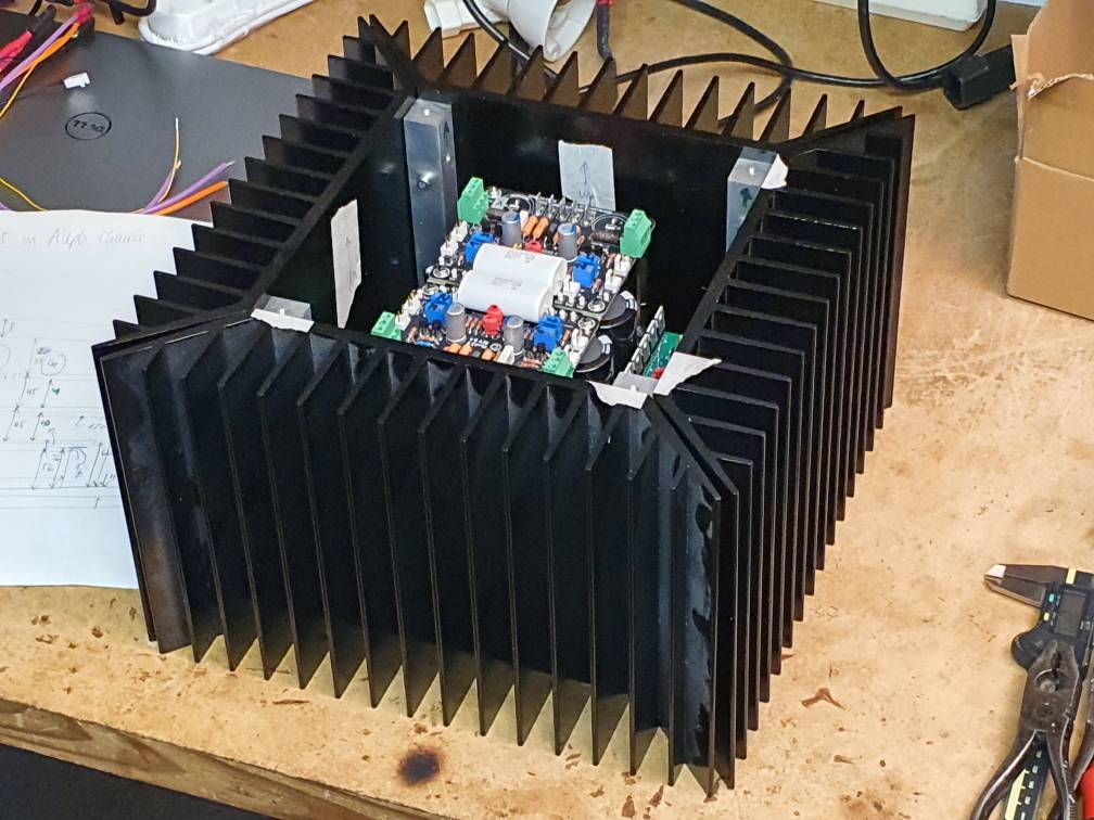

Wow Mbrennwa!
This looks fantastic :cheers:
It is a remarkable implementation. It may be the smallest 25Wrms/ 8 ohms (or more?) class A amplifier 😉
I really like it a lot🙂 can I use the picture in my next iteration of the build manual ?
Where will be located the input and output connections.
Can you describe a bit your PSU .
Fab
Well, my current Aleph is already there (same chassis). However, the Aleph has an external SMPS, only the CLC smoothing is in the chassis. The USSA will have to full PSU inside the chassis.
Sure! I may have better photos later on.
On the bottom. The whole thing will have somewhat taller feet than a typical chassis, which allows some room for (angled) connectors.
I have not yet tested the PSU. The plan is to use one 500 VA transformer with 4 x 21 VAC secondaries --> two Smooth Like Buttah power supplies (one per channel) --> USSA5 boards
The chassis is quite a bit of work. Lots of drilling and tapping. I already broke two drill bits, and they are stuck in the aluminium... next time I will buy the expenisve drill bits again 🙄 Drilling / tapping must be dead on centered on the fins, so that the hole is inside the fins and will not visible from the outside.
