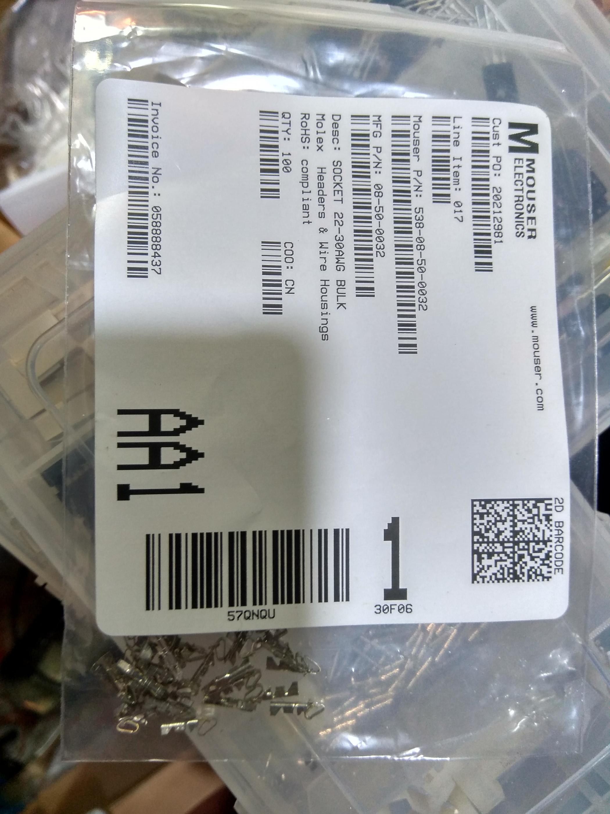

Speaking of connectors... I ordered the Molex parts from the BOM in the USSA manual, but the crimp pins are missing. I have no clue about the Molex universe... so, which pins should I get to fit in the connector housing and on the PCB connector? A Mouser part number would be great.
Thanks!
I have the housings specified in the USSA BOM, which are a different part number than what you suggested:
https://www.molex.com/molex/products/part-detail/crimp_housings/0022013037
Will your suggested crimp pins work in the housings I already have?

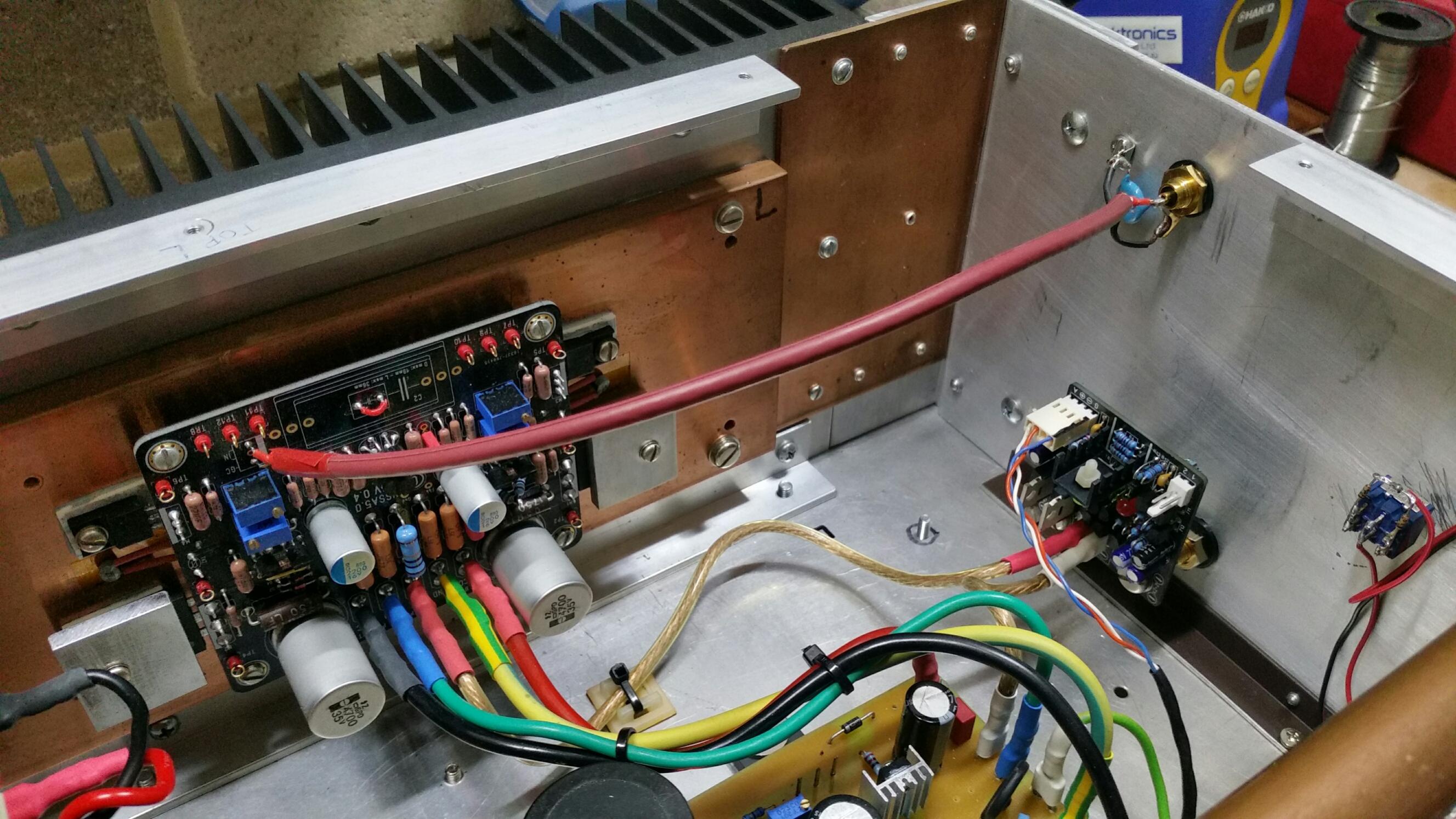

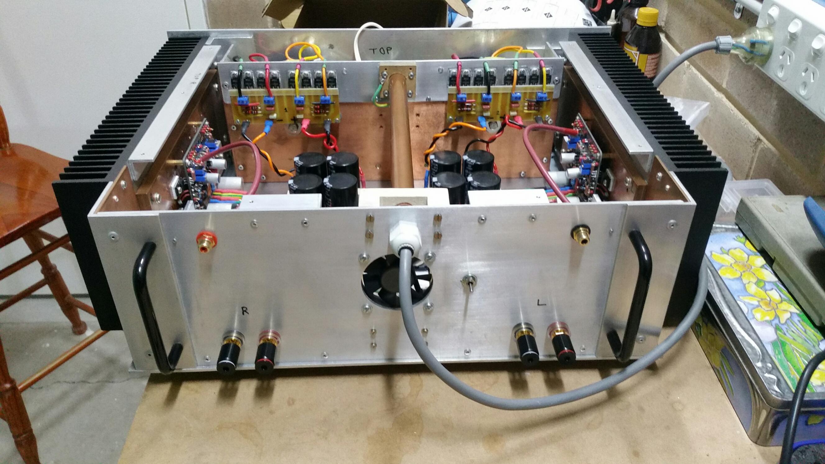

Finally getting around to my build (stereo chassis).

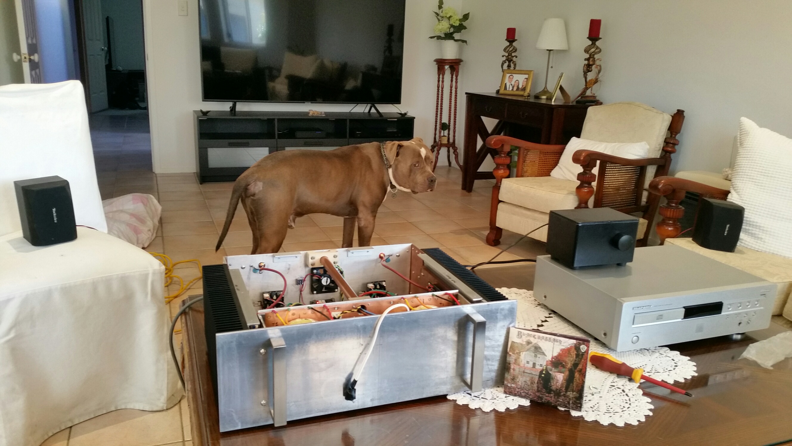

Finally my amp is playing music on my sacrificial speakers.
I've measured 70.5mV on one channel and the other one is at 71mV, across R15 or R16.
Heatsinks are just warm and I can touch the output Mosfets for about 20 seconds. I assume that the heavy copper plate bolted to the heatsink is drawing away most of the heat from the Mosfets.
When I get my speakers out of storage I will do some critical listening. Now to finish off the front panel.

Good stuff Harry3. Looks like man's best friend also likes what he is seeing? Or he's just bored. 🙂

Well done......Harry!!

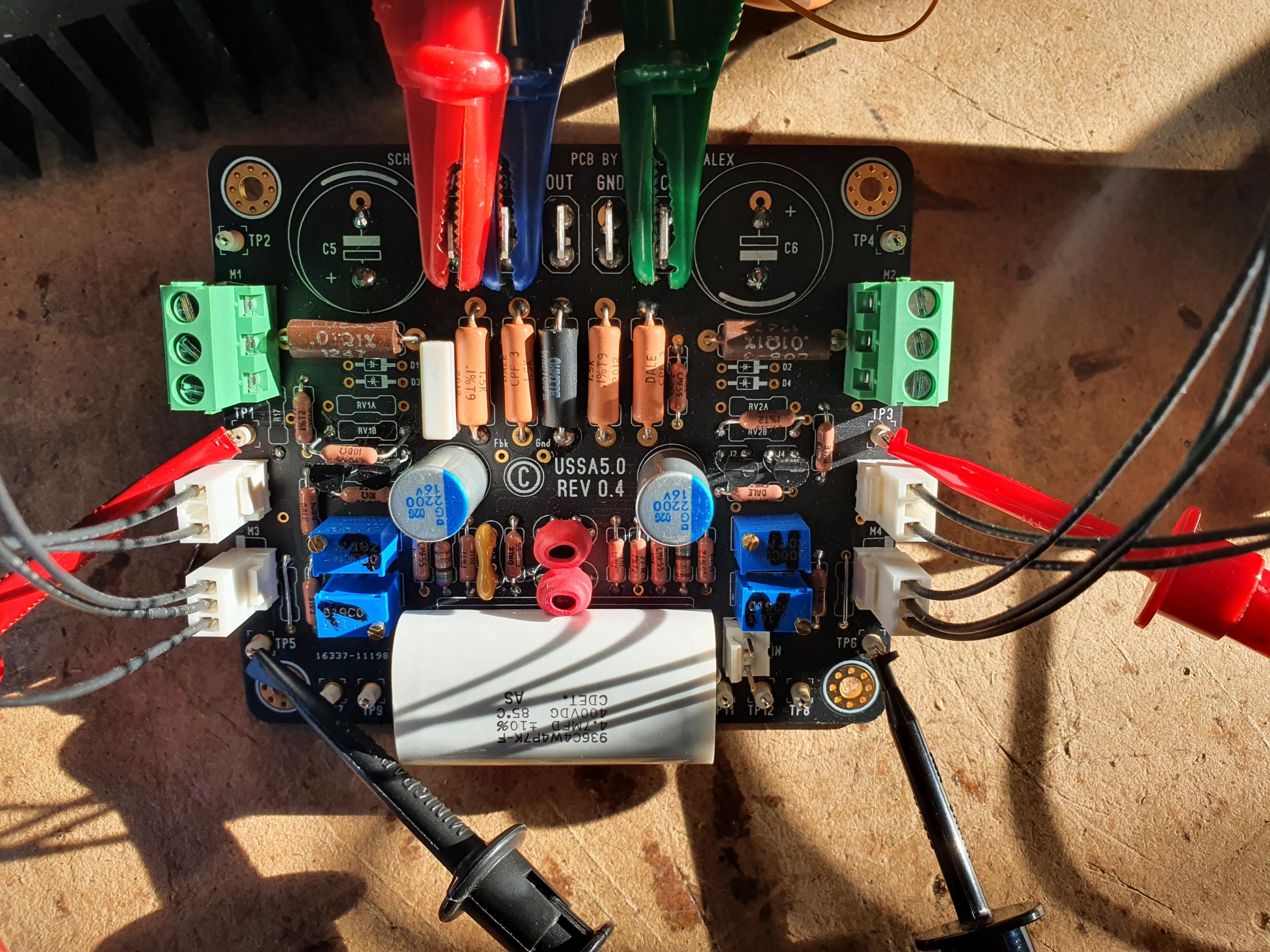

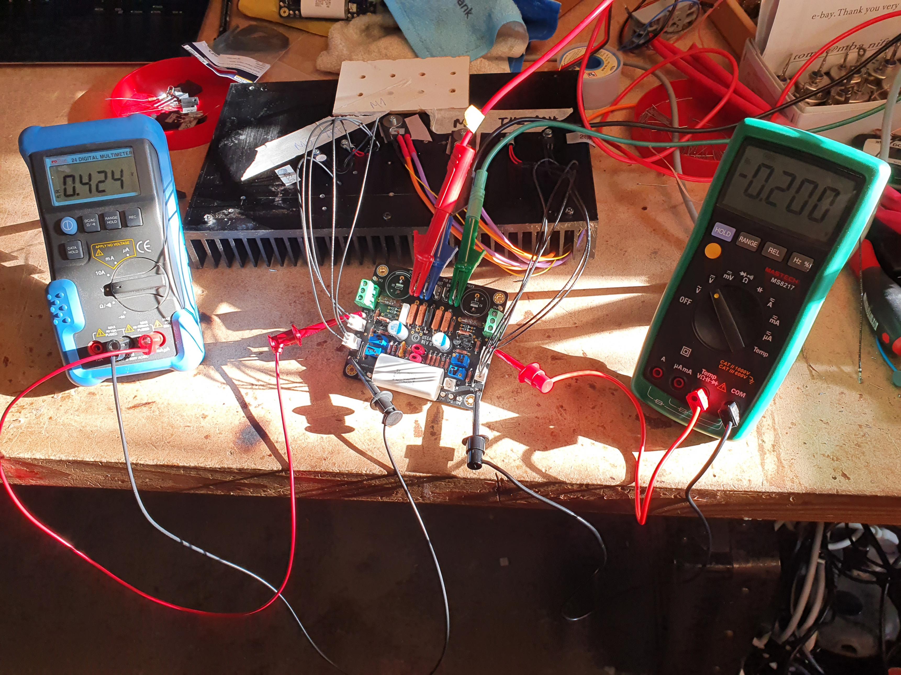

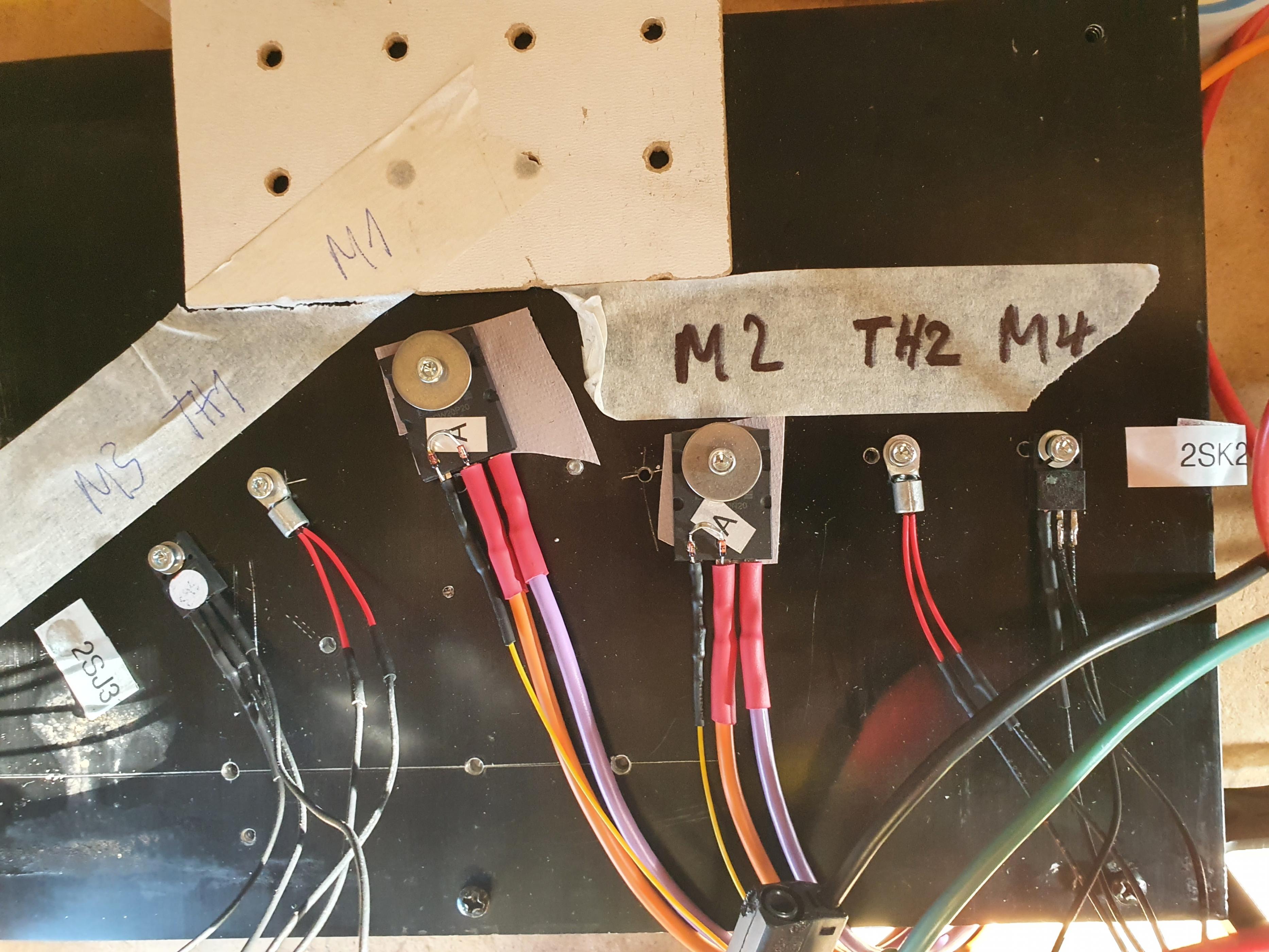

Issues with front end testing
I am running into problems with testing the front end. Step 8.14 in the manual says:
- Adjust P1 for 0.3 V between TP6 and V-
- Adjust P2 for 0.3 V between TP5 and V+
In my build, I can not adjust the voltages independently. If I adjust P1, both voltages will move up and down at the same time. Same with P2. For instance, I could set the voltages to about 0.4 V and 0.2 V. If I adjust P1, I could change the voltages to 0.5 V and 0.3 V (and same for P2). I cannot achieve 0.3 V for both voltages.
This happens with both boards.
PSU is at +/- 25 VDC (lab / bench supplies). Transistors and thermistors are mounted on a dummy heatsink for testing purposes. Output transistors are not connected to the board. I attached some photos.
Any ideas or suggestions?
