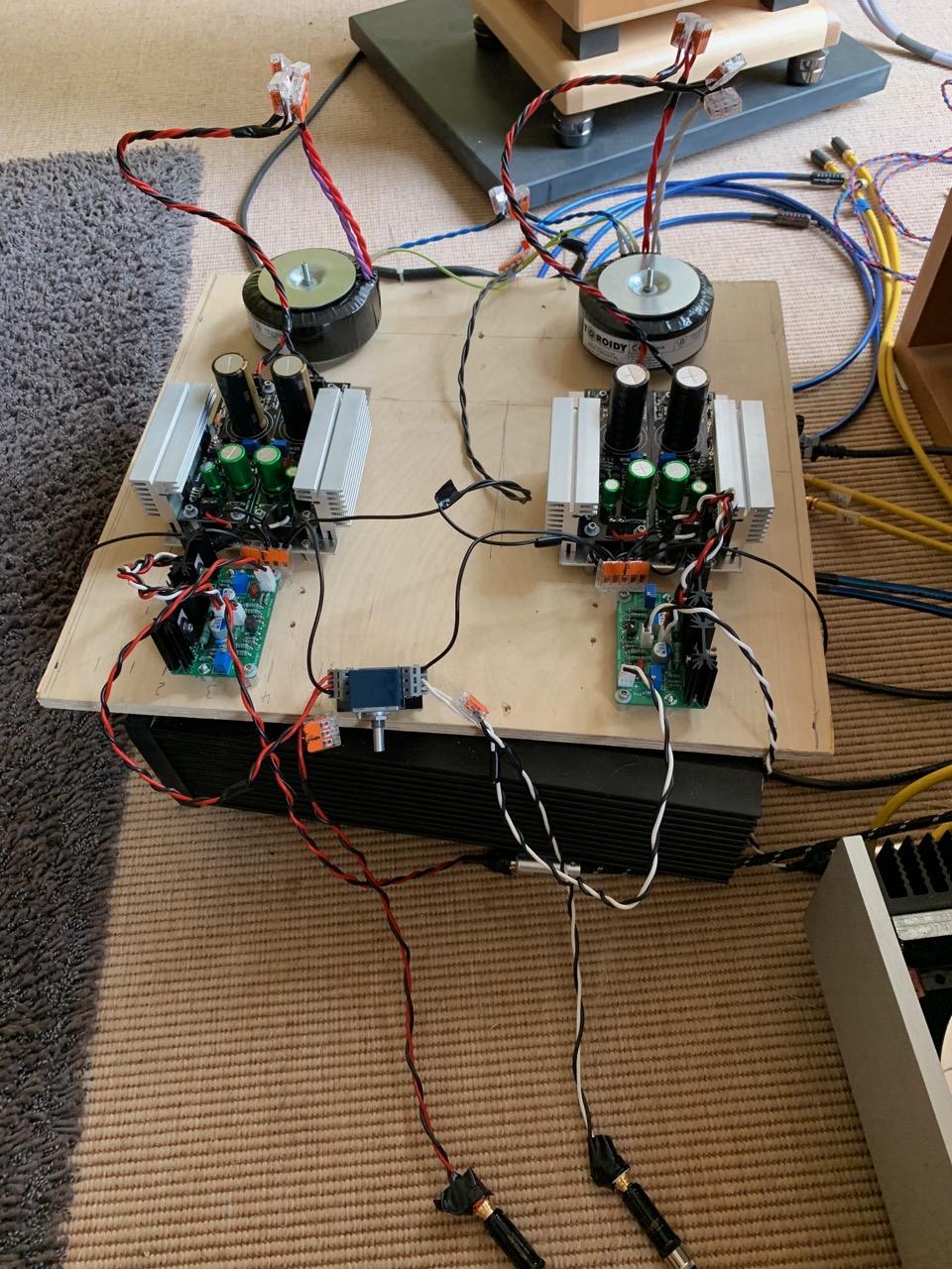

Hello andré
The problem is certainly because of the wiring and it would be interesting to have a picture of your set on the table.

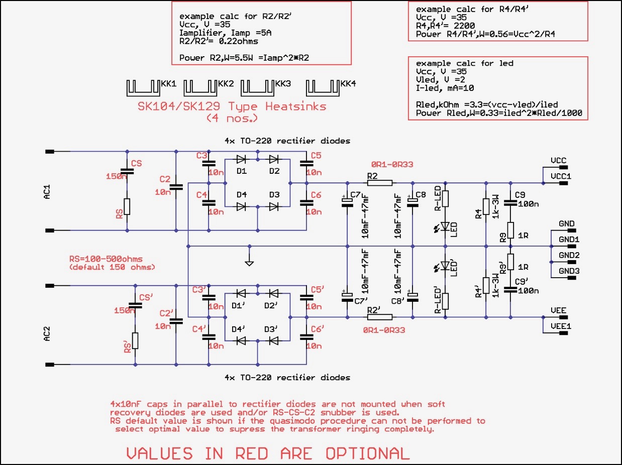

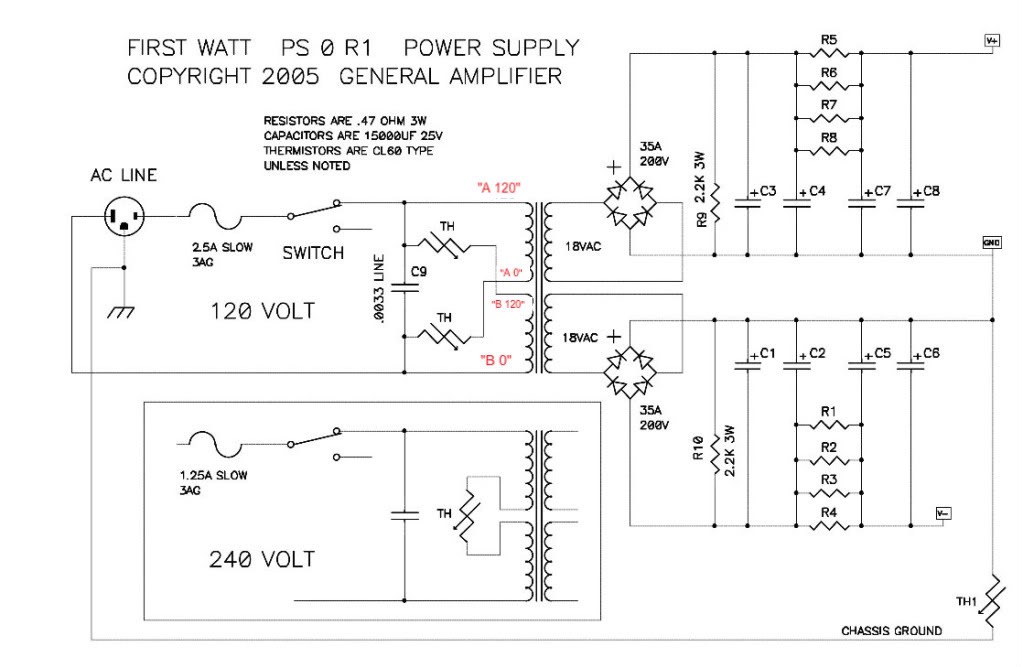

In mostly every schematic I found a ground symbol on the 0V line, even in your power supply for the USSA.
Do I make a mistake? Do I misunderstood the American symbols?
Papa use it too!

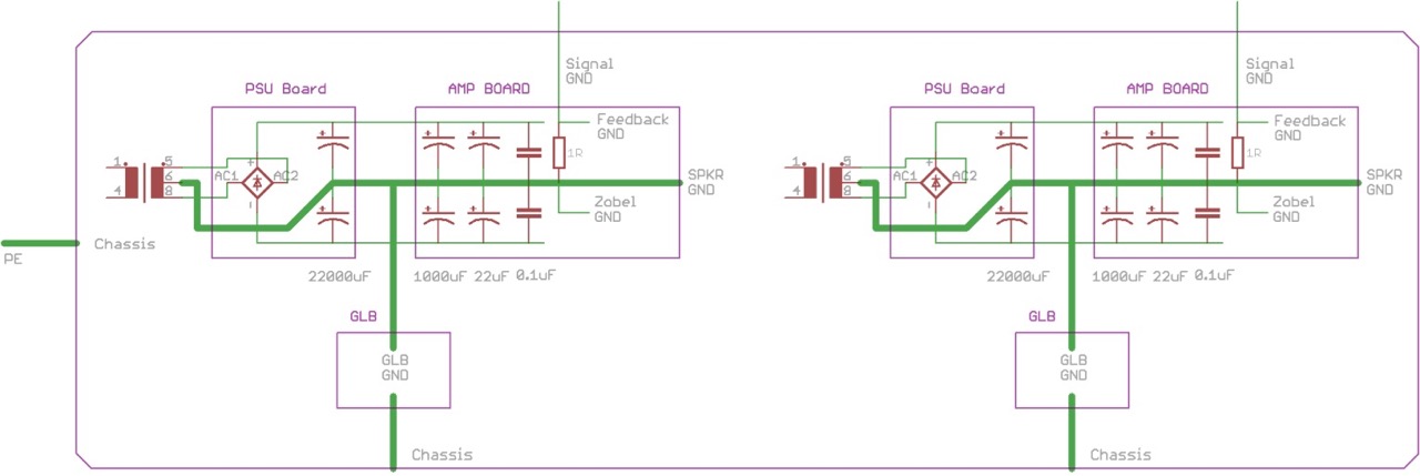

Normal Schematics:
The differences for the USSPA are you have not used or tried the ground connection for the power supply (different sound).
Fab put the output ground (speaker ground) to ground on his PCB (the difference /as expected)
(On the USSA-5 we connect it as "normal" to the power supply)
For both the USSA-5 and the USSPA Fab connects the Input ground over a small resistor to the ground ("not normal") this makes a difference too when you connect it directly to the star ground.
My point is why he made it this way and specially why this small resistor changes the sound.
Is this only my finding or have other find this too?

Picture from my test setup:
André
