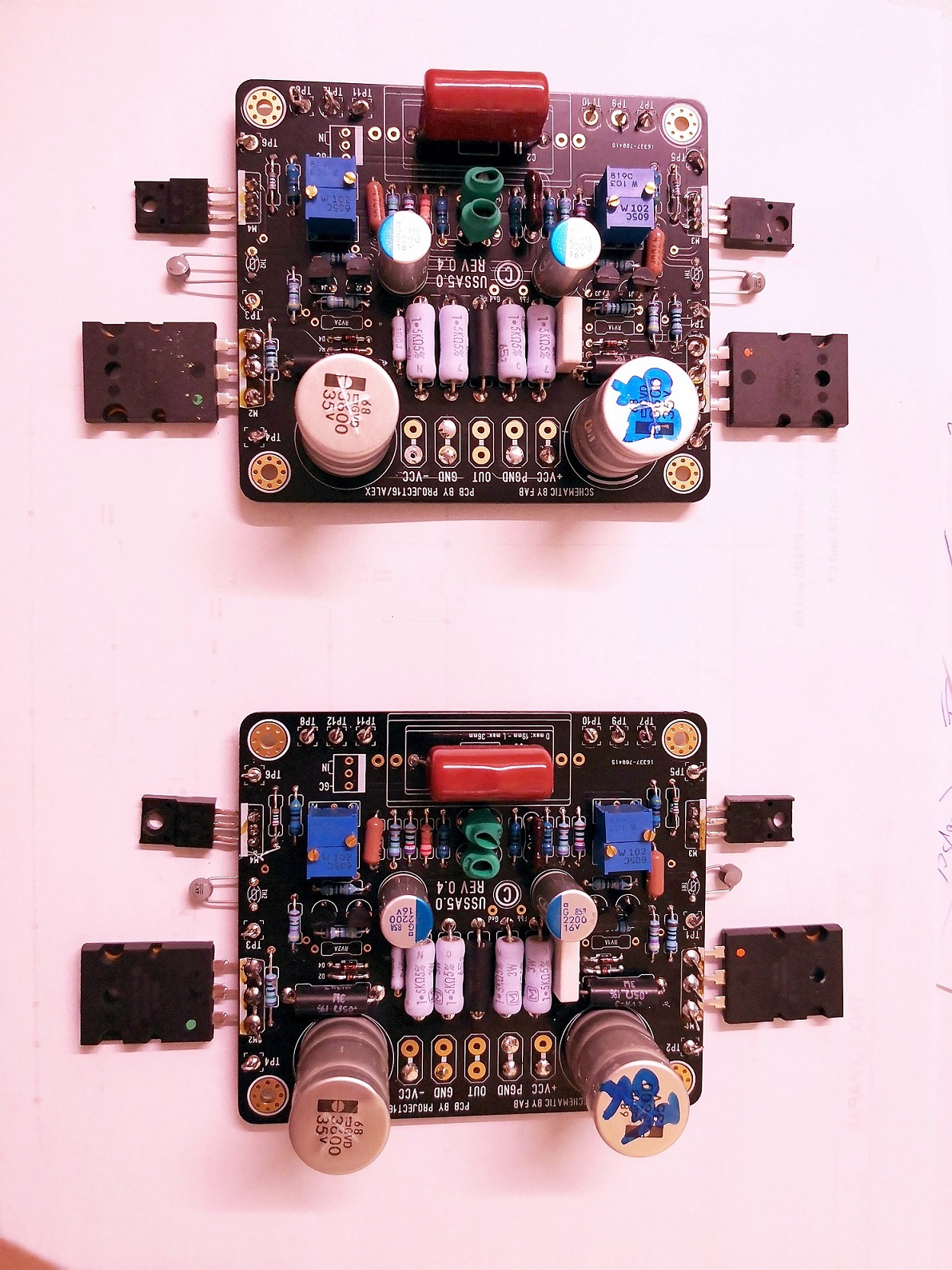

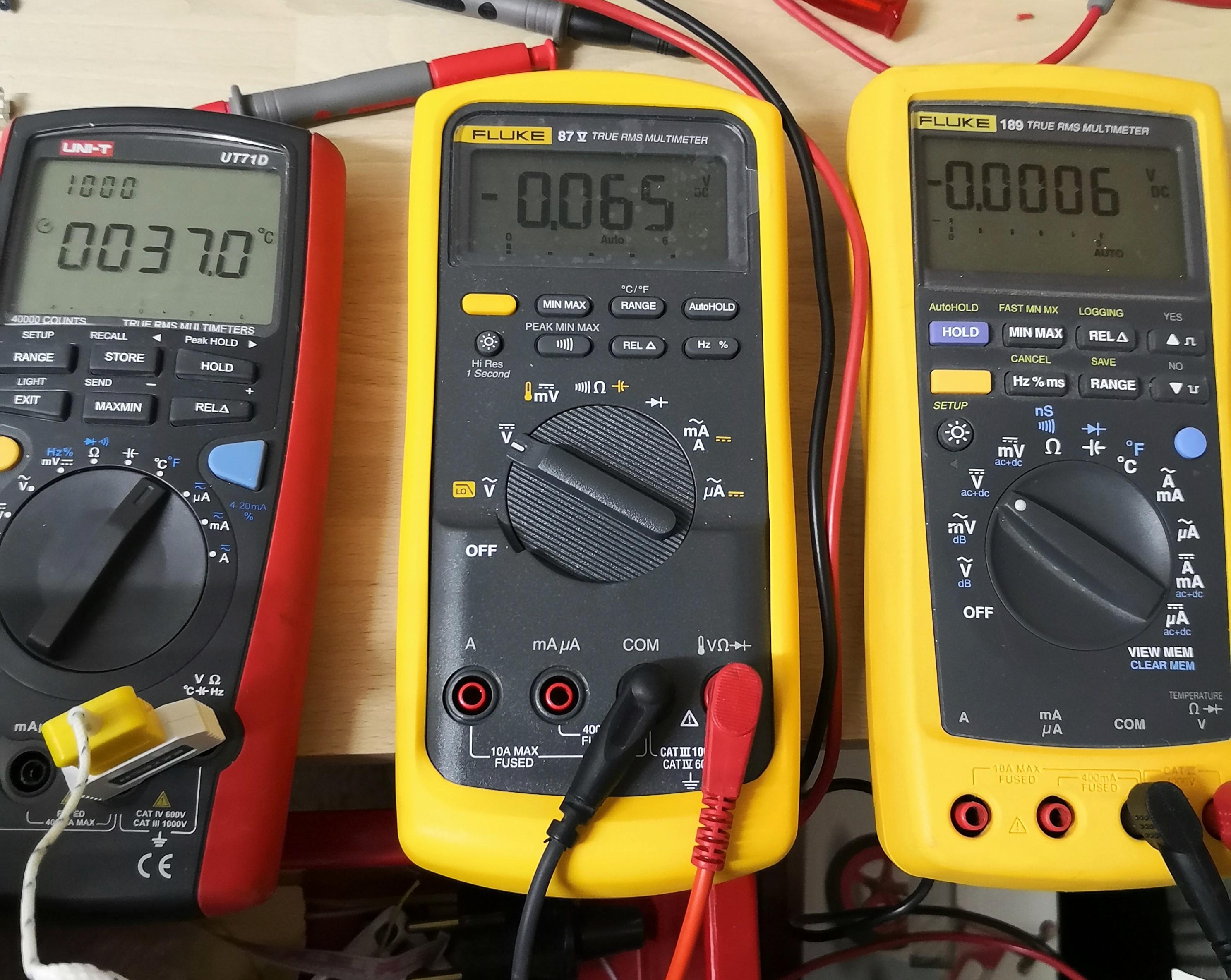

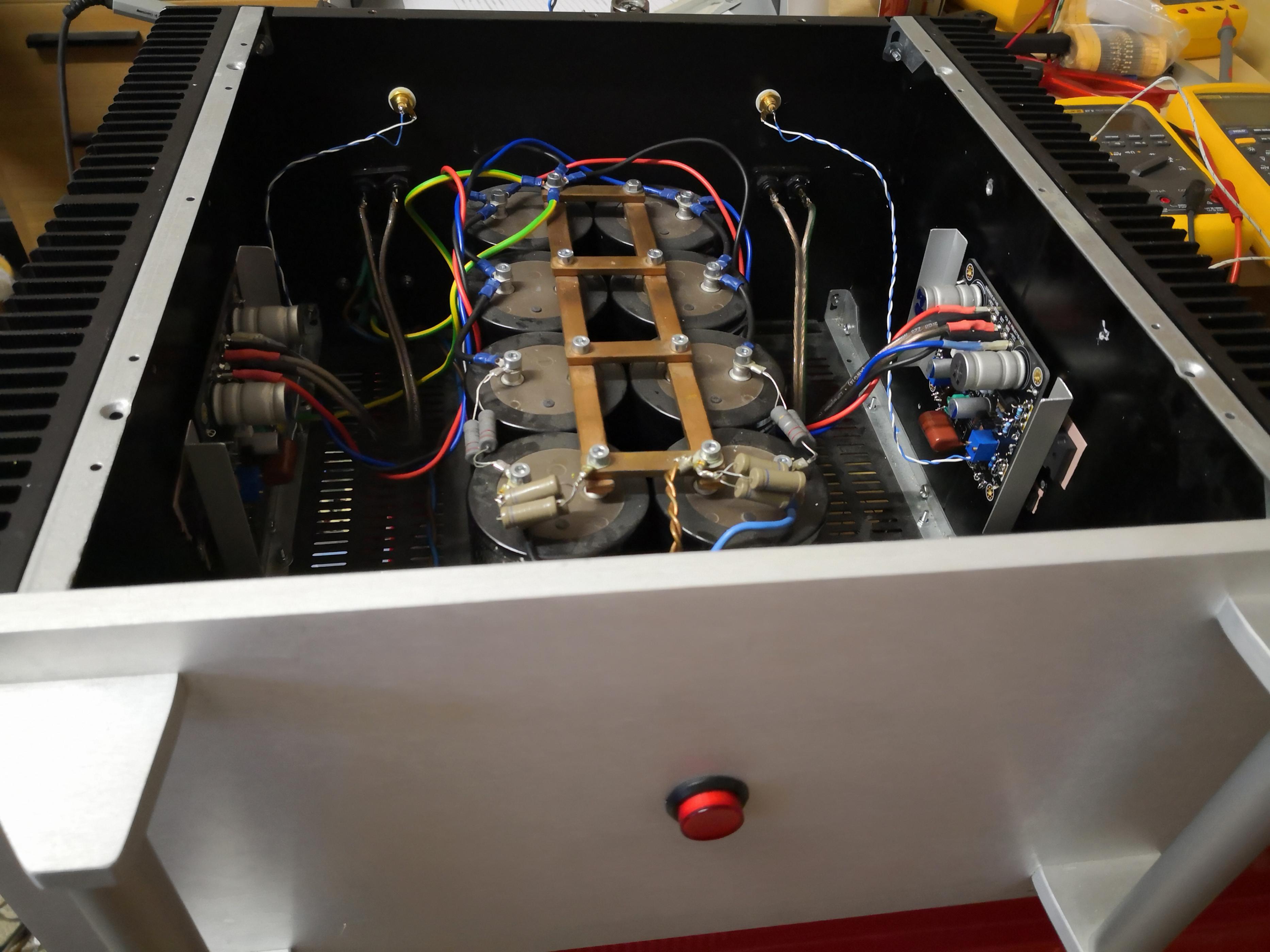

After adjusting USSA 5,let it cook for 3Hours ,while keeping an Eye on it every half Hour.It didn`t move much .After realizing that Temperatur didn`t get very high,I went for 65mV with a Temperatur of ca 38C°.Today let it cook again for 3 Hours and readjusted Offset on one Side,just a little.Hooked it up to Stereo right now and had a short listen.Very promising.Dead Quiet,very Detailed,seperatet from Speaker,not shure about Bass at the Moment.Let it Burn.
regards DT
Some Pics

After listening to USSA5 for a couple Days now ,I can say it is a really good Amp.Clean.lot of Resolution,deep Bass Resolution too.The only Thing I`m missing is some Body for Piano,Voice...Can this be bettered by choosing other Input Cap or Resistors in some Places? Any Advice?

Patience....patience, let it break in. USSA-5 is generally a warmish, full-bodied and detailed amp; it does it all.

DC Offset is very good and stable,I just wondered if that can be tested, with all Parts installed because I didn`t mount them.I just wonder if something is wrong because it is pretty cool,my F5 was a lot warmer.

In the Back of Heatsink is a little Hole where I measure.So I can do what,just push it to 70-75mV and watch Temperatur ?
Regards DT
75mV would be 1.5A bias. No issues as long as your heatsink can support it. Start with 1.3A and then if too low, bring it to 1.4A and see what it gives you for sound each time. You will find the right balance for sure. Class A amps love heat. :)
