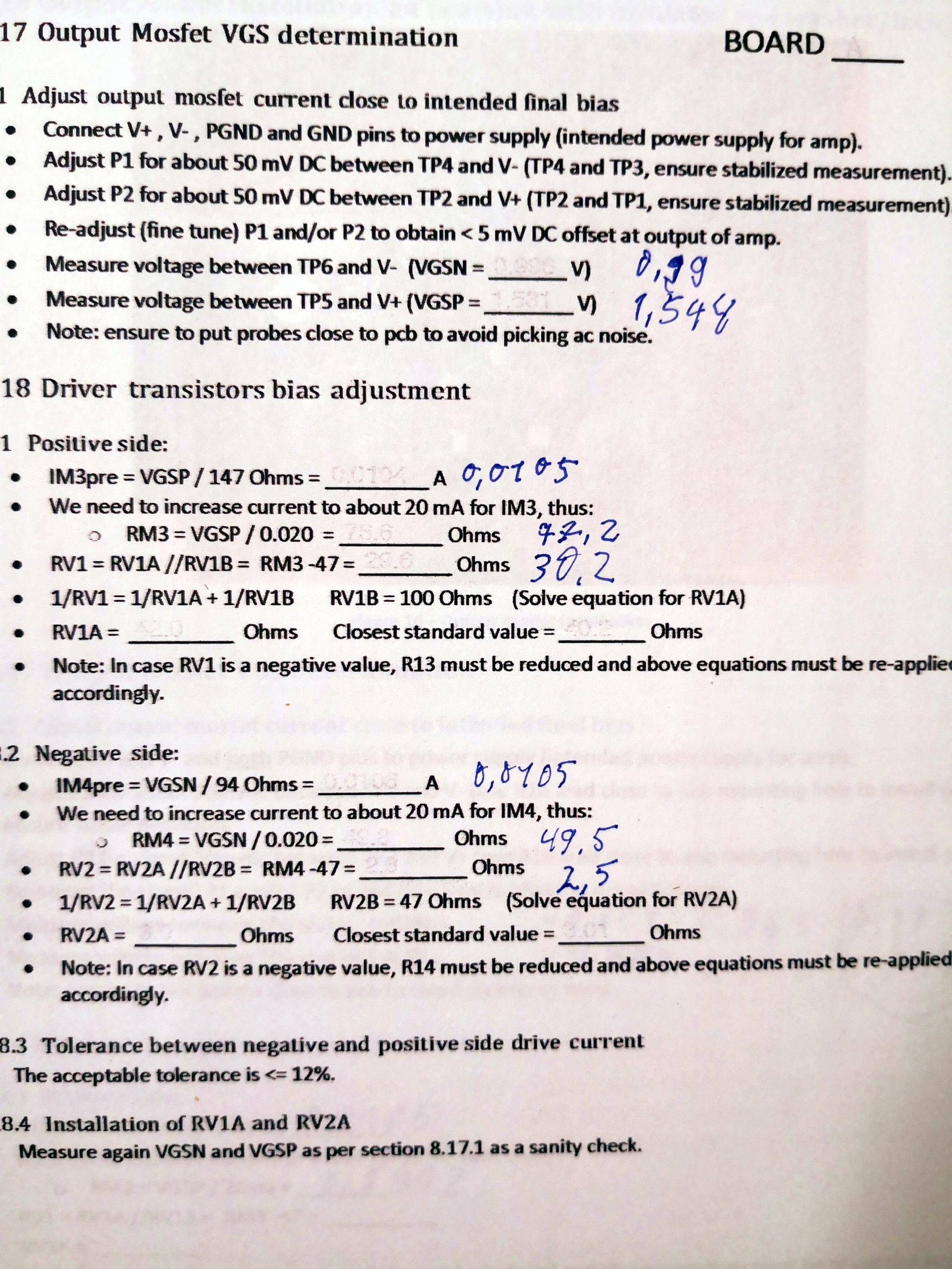

Based on your attached, your final calculation ....Hope i didn't make any mistakes.
RV1A = 43.86 ohms
RV2A = 2.64 ohms
So you need to choose the closest available resistors...
RV1A = 43.86 ohms
RV2A = 2.64 ohms
Before you can give values, you have to make sure before knowing which current values IM3 & IM4 taccodude to choose, 20mA?
Hi taccodude
Project16 means that you need to select your intended final bias current based on your heatsink size and your own tolerance to heat. I target 50C for heatsink temperature for class A amp but it is my personal choice. Higher the temperature allows higher bias so highest power in class A into lower impedance speaker load.
The manual expects that you will have at least 1.2A final bias current for output stage so when you adjust driver current to obtain 1A for test purpose as per the manual then I suggest about 20ma of driver current. At the end of the manual steps when you will set the final bias you will have to increase P1 and P2 set value which will increase driver current (22-25ma) which will increase driver voltage thus will increase output bias current. In the case where you can not go higher than 1A output bias current then you should select about 23ma for driver current. The exact value is not important but should be roughly about the same between positive and negative sides. For final value 20 ma is the lowest value for driver and 25ma is marginally better.
For your calculations of resistors you got it right so far but have in mind the RV1 value is the result of RV1A and RV1b in parallel and then in series with R13. Same with negative side. If you do not want to consider the RV1b then you can simply remove it to have only RV1A and R13 in series then will match your calculated values. Same for negative side.
Meanie has got it right for 20ma of driver current.🙂
As a tip, I use a standard value of resistor for one side, recalculate the current and then use recalculated value of resistor for the other side.
Fab
Fab
Heatsink is around 40C° after 1 Hour,everything is stable so far.Offset starts at 10mV and goes down to Zero.Sorry,still don`t know what to do now.If I want more than 1A say1,2-1.3A what do I have to do? And how do I calculate that?!
And how do I calculate those Resistors now. Can You give an Example with my Numbers ,so that I can follow Steps?
the calculations of meanie done for you are correct.
Select closest resistors values available and this is quite ok.
Fab
Fab

Hi taccodude
Here is the results with 47 ohms as RV1A and 2,2 ohms as RV2A:
Vgsp= 1,548
Requivalent = 47+ 47//100= 79 ohms
IM3pre= 19,6ma
Vgsn= 0,99
Requivalent= 47+ 47//2,2= 49 ohms
IM4pre=0,99 / 49 = 20,16 ma
IMpre Difference = (20,16-19,6) / ((20,16+19,6)/2) * 100 = 2,8 % < 12% — > very good.
When increasing output bias at >= 1,2A at end of test then IMpre will increase to be >= 22ma which will be correct.
Fab
