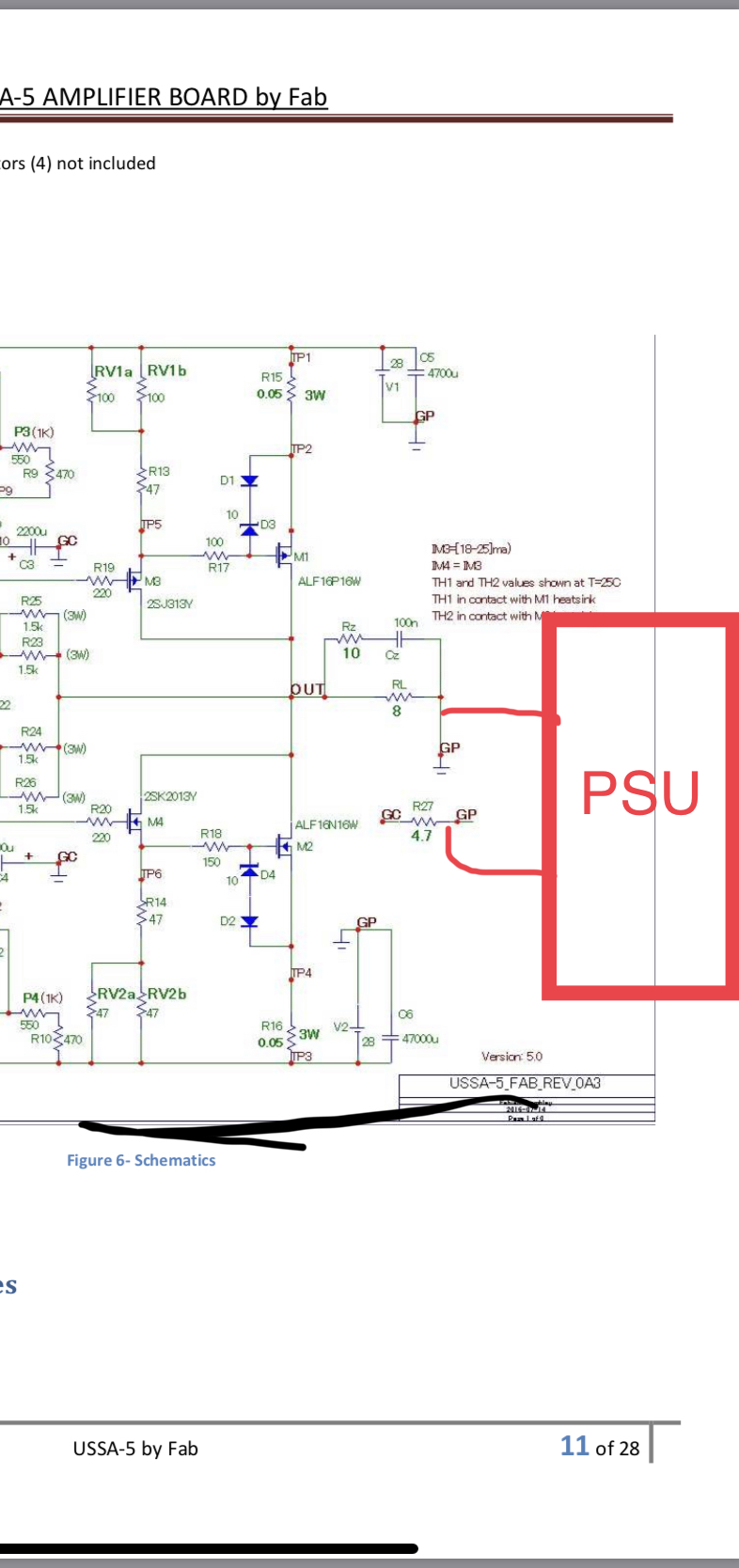

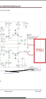

Fab, yesterday I tried to go a confirmation run with the USSA amp in order to have a stable ID. I saw that I don't have a stable power ground 0V if I don't keep power ground and ground connected.
Since there are two different grounds, which are connected by a resistor, I guess, I should not connect them in the finished amp, should I?
Ernst

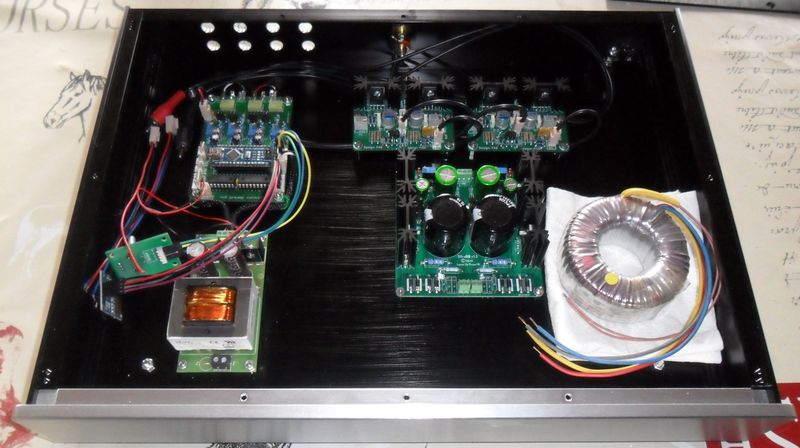

Coupled with the "Arduino based ldr volume source selection controller" I get something really good and as I said above without any particular research on settings.
For power supply the Salas UltraBIB has been really effective compared to a serial model, the transformer is an old ILP very famous for the audio that dragged in my drawers for a good thirty years.
I still have no work to finalize this project but it is worth it.

For the USSA amp, yes you have to connect both ground to PSU. See sketch below.
Fab

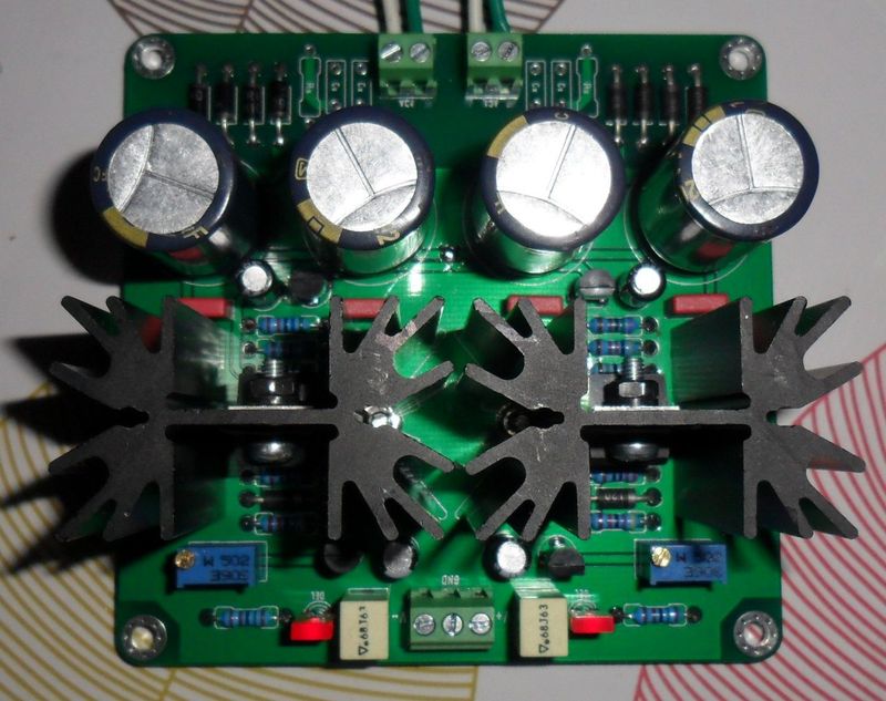

In fact, my serial power supply works very well and is very quiet and is a good choice for the USSPA but the problem was that I did not have sufficient voltage transformer and VA for serious operation and I did not want to invest in this component.
For the UltraBIB the operation is different and the transformer that I owned is perfect for her.
I confirm that listening to the difference seemed flagrant but it can be as suggestive.
