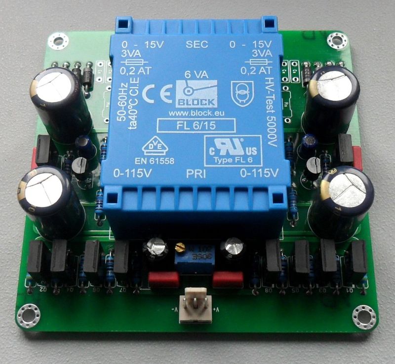

Other options, with a graph, are the regulators made/sell by Aleksandar (ATL Audio). Two PCB or assembled and tested. From Bulgary (EU).
Modified Sulzer Regulator – assembled and tested | ATL Audio Ltd.
ATL-Hifi Sulzer modified regulator
ATL-Hifi Sulzer 15V 375mA OP37 graph
[Big IMG, link] http://maty.galeon.com/WP-imagenes/hard/ATL-Hifi-Sulzer-15V-375mA-OP37-graph.jpg
On the picture below can be seen Regulator’s measured performance with output voltage 15V, 40 Ohm load (375 mA load current)
For the tests was used a 35VA toroidal transformer with two secondary windings; soundcard used – E-MU 0404.
The regulator is offered with the following standard output voltages: 9V, 12V, 15V, 18V, 24V.

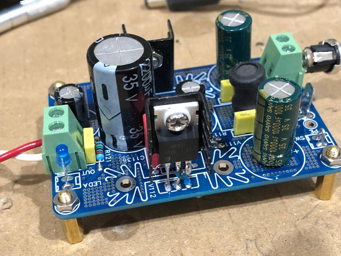

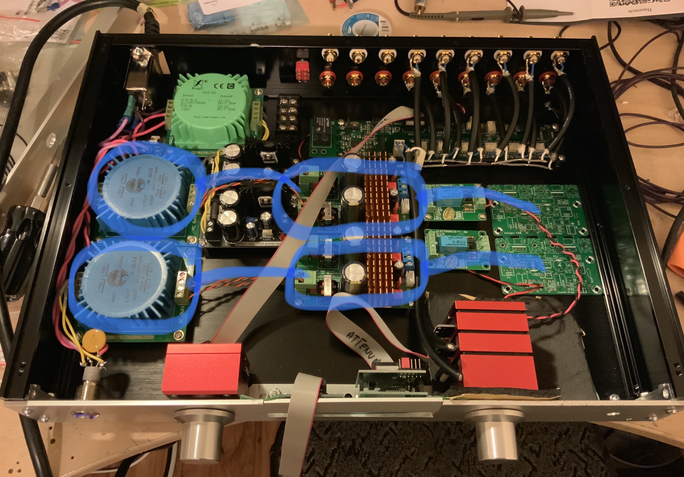

Hi everybody
I will take some pictures of two power supply that I will try on the USSPA soon, I also drew my layout of the UltraBib by Salas.
If you feel like it, here are some tracks to get the most out of the USSA-5. 😀

Initially I made this layout based on the RJM regulator shunt for the Kuartlotron with pre-regulator TL431 but I will try it in 12V dual mono version on the USSPA.
A power supply of type regulator series with pre-regulator is also in manufacture that I will try also on the USSPA.
I will inform you soon about my tests.
USSPA PSU

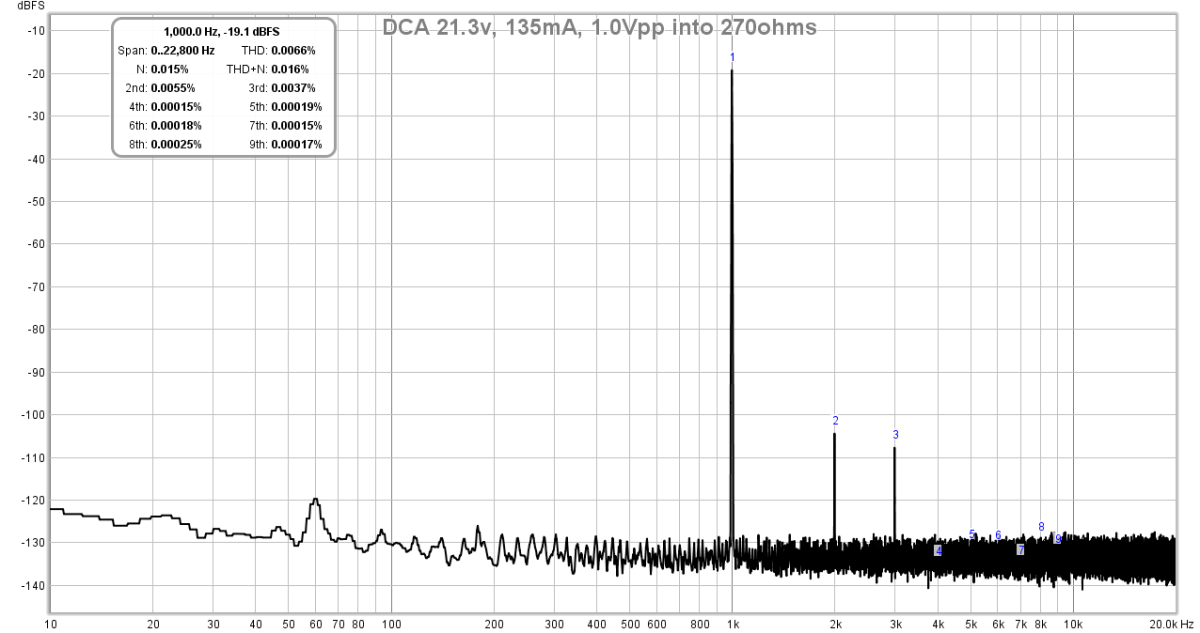

If you look at this link (The SilentSwitcher | Linear Audio NL) and scroll to the bottom, the performance of the Silent Switcher is revealed. Perhaps in a future iteration, Jan will design in more current capabilities at +/- 15V dc. That being said, Jan does say:
The current limits (150mA at the +/-15V and 0.5A at the 6/5/3.3V simultaneously) are such that they can be used with a standard 5V/2.1A USB charger. However, if you use for instance batteries or a wallwart delivering 9V at 2A, the available output currents are doubled.
