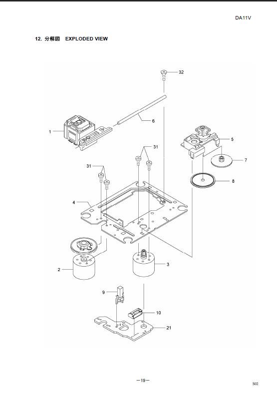

It was also used in mid range players such as the NAD-540, and NAD-541.
The service manuals are available on line and even though they use internal numbers, they translate to the SFP-101V laser assembly and DA11 series of transports.
So what makes the transport cheap? The fact that it was used in inexpensive boom boxes? This simply implies it is cost competitive and does not in itself say anything about quality.
Thus it is simply a cost optimized transport with a minimalist approach to the load mechanism (none) and other amenities which are added as marketing hype to convince consumers that they need the options on mid range and high end systems.
The specifications for the transport mechanism are available.
The main fault I can see with the Boom Boxes is they use the audio out instead of using digital out with a good D/A converter and use lesser quality components to support the drive. This all is in line with the marketing requirements.
So, how is the unit "cheap"? (Implying inferior quality)
What are the specifications of the DA11VZ which are of poor tolerance which will contribute to poor sound quality?
Since this design uses and external D/A, those analog specifications are not in question.
What are the specifications of the DA11VZ which are inferior?
