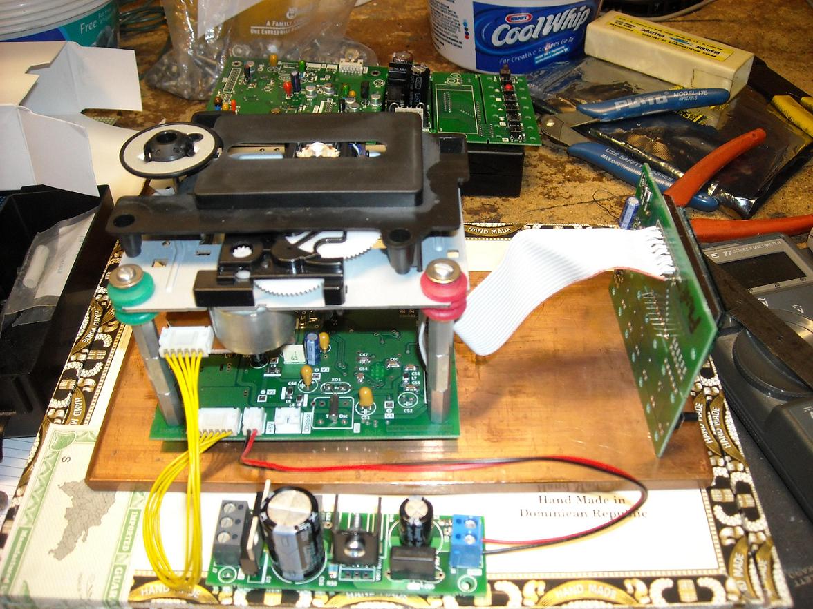

On a slightly different topic, Mounting the Shiga.
All of the Shiga conversions I've seen use solid mounting for the transport. Is this because it is simply easy to do, or has anyone made a direct comparison to the original isolation mounts?
I'm considering this configuration, with the power supply to the left of the transport (as viewed from the front looking at the LCD). I plan on placing a mild steel shield between the power supply and transport.
Using segmented standoffs would also allow me the option of placing a mu-metal shield above the control board to shield it from the transport.
