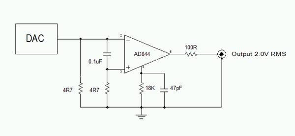

The smart thing to do is // at pin 5 and use a single load resistor, that makes any output offset even smaller.
Jan
Yes, that's exactly how I've configured them. Summing the outputs via series resistors probably isn't required, but doesn't hurt either. The buffers all have gains close to = 1 and slight variations in vbe's might cause a slight variation in offset voltage, though admittedly I haven't taken measurements with a dvm.
Joe, your last pic is definitely NOT in series - two resistors, connected together at both ends - that the definition of parallel!
A voltage divider?? Both resistor have exactly the same voltage - they are connected on both sides! You really have to read up on this basic stuff!
Jan
I think he was trying to draw a parallel (pun not intended) between paralleled resistors across an ideal current source and series resistors on the output of an ideal voltage source (ie Norton vs Thevinin eq ccts.)

Here is my humble attempt to go back to what this thread is all about:
I/V with AD844
Recently I have implemented Joe`s Technique No2 to a Philips CD723 (DAC: TDA1545) with the following changes and additions:
Changed both 4R7 resistors to 10R and connected them to Uref (approx. 3.1V done by TL431 and fed to TDA1545 by 33K)) instead of GND.
Changed resistor at pin5 from 18K to 10K and capacitor from 47P to 100P.
Changed 0.1uF to 47nF
Changed the quartz (8.4672MHz) at SAA7378 to an external oscillator made up by a original PSX oscillator (67,7376MHz) and a 2:1 divider and pulled pin 13 (SELPLL) of SAA7378 to GND (cut and wire operation).
No changes to the power supply, maybe here`s another possibility to improve….
The maximum output level is a bit low (less than 1VRMS), so more gain is desired when your preamp has low gain (change resistor and cap at pin 5 to maybe 22K and 47P).
The result? Unbelievable that such a cheap (20€ on ebay) and simple player can perform like this, even better than using a pure passive I/V with the TDA1545. The passive solution sounds less refined to my ears.

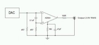

question to joe r
i´m using this setup too and can you tell me please why pin 3 is not going straight to ground instead via a 4r7 resistor?

In Joe`s drawing both inputs are referrred to GND. When using this arrangement with a TDA1545 (or similar DAC) both inputs must be related to Uref = approx. 3.3V (DAC output has 3.3V DC) Otherwise you`ll have the DC-Voltage difference present at pins 2,3 which will then be amplified by 150...300 and the output will be at the supply rail. What you want is AC-signal-gain and as little DC offset as possible.
Hope this helps - I am not as good as other forum members in explaining electical behaviour....
