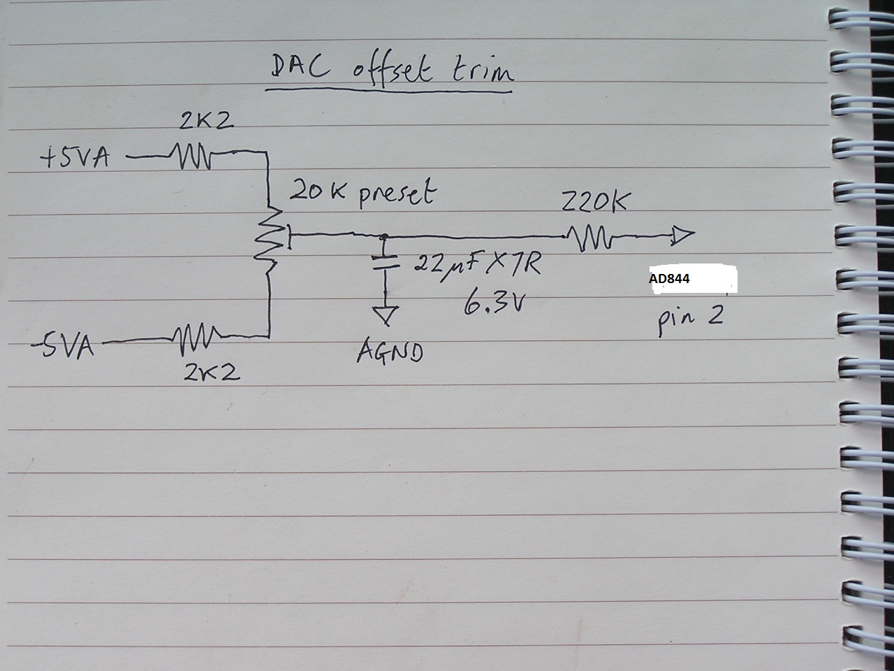

You could however use Abraxalitos dc nulling circuit (attached) after the dac to null it before it gets to the AD844 it may give better range, than just using pins 1 and 8.
Cheers George
I saw Abraxalitos dc nulling circuit before in this thread but thought that it works with bipolar power supply DACs. As there is only 3.3V Vref and 1mA Iout per channel tied to it there is nowhere for me to get -3.3V (DAC is powered by 0 and +5V).

With a "classical" opamp, at equilibrium, the following rule apply:
VIn+ = VIn-
Therefore, if Vin+ is 3.3v, Vin- is 3.3v also. Then you can check which value should the input have in order to fullfill this conditions.
If you have a resistor between out and -in, assuming no current flows in, then vout = vin- = vref.
If it is different, then there is some current flowing at idle in the feedback resistor, caused by the current offset of the dac. In your case, it is stated at 714uA typical for the tda1545. This is not in accordance to the offset you measured, I don't know why. (edit: abraxalito gave the answer above)
Now, for the ad844 running open loop, the in+ = in- still applies but the rule to follow is current at TZ = current into In-.
If current into In-= 0 then current at TZ=0 and thus no DC offset in the R I/V going to ground (since no current).
In your case, you will need a current nulling servo if you want to DC couple the output.

This is right on the dot, but don't forget that even with the current into pin 2 being zero, the current at Tz is not perfectly zero. There is always a small offset current which will give a small offset voltage. Don't know how much, should be in the data sheet.
You can null that out by a small offset correction current into pin 2, or a small offset correction voltage to pin 3. Or using the offset control pins. Or a small offset correction current at pin 5 ;-)
