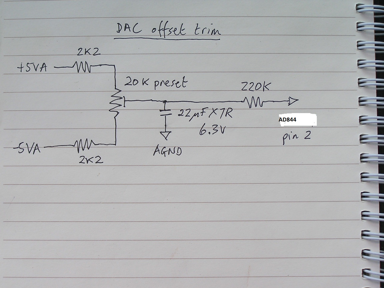

How bad is the DC offset on a PCM1704?
They vary, one of mine was 2mV the other was 10mV, just use the 20kohm trimpot on pin 1 and 8 one of the stacked 844's and you'll get very stable +- 1mV dc offset.

If it is this drawing you mean, it does not say 5VAC. It says 5VA which to me is 5VAnalog (power)
My bad. That make sense now!

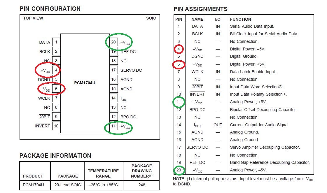

For a different application, can I use +/-12 and change the resistor values?Yes for clarity it should have labeled + & - 5vdc from the "analogue" power supply, not power from the dirty digital side of things.
In the case of the PCM1704K dac chip, the green not the red. (attached)
