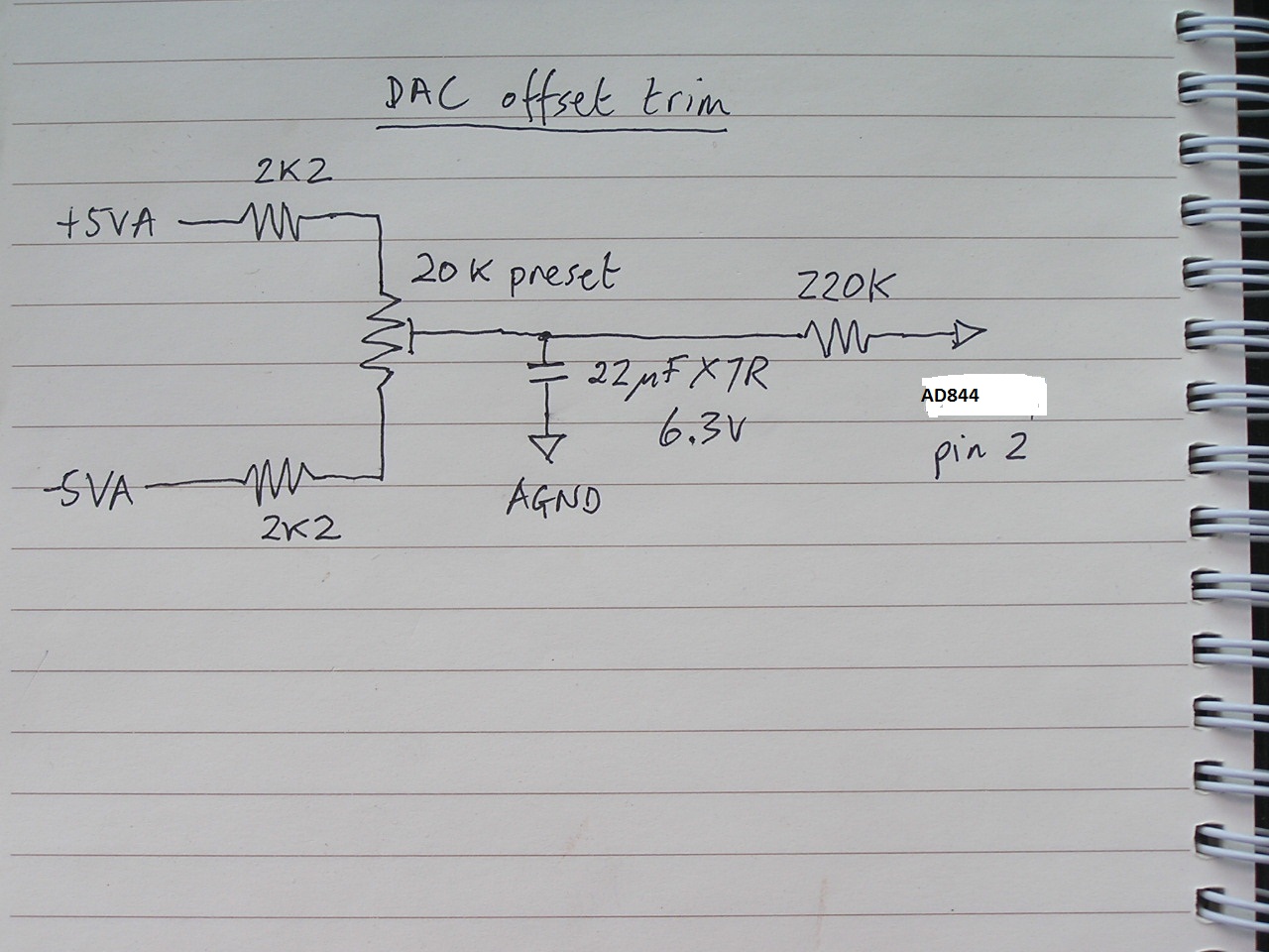

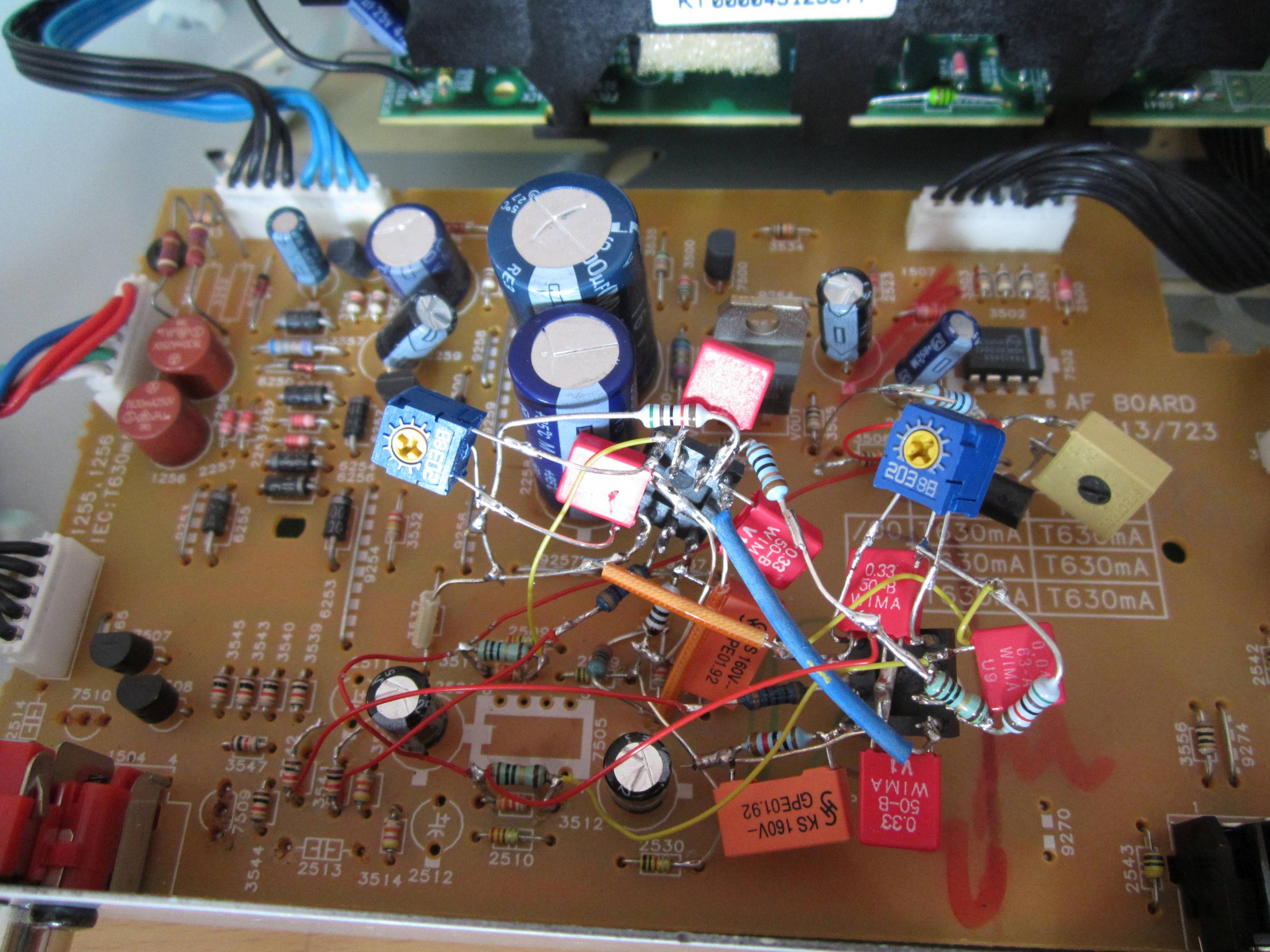

Yes, you are right. Without any other means the offset in my player was around -300mV. When you increase the gain, you may get more. You can use a coupling cap or some means of offset compensation to null it out. In my setup I could not null the output with the pins1,8 of the AD844 alone using the recommended offset arrangement as drawn in the datasheet. I connected an additional resistor (50K - 100K) from the plus rail to pin3/AD844. Then it was possible to null it out. If you change the gain of the stage you may need to adjust this resistor accordingly.
I could not null the output with the pins1,8 of the AD844 alone using the recommended offset arrangement as drawn in the datasheet. .
Pozo, maybe you missed it, but I believe the AD844 data sheet has a misprint re the offset nulling pot on pins 1 and 8.
It should be 20kohms not 20ohms, this may then work for you if it has the range. If not then Abraxalito's DC offset nulling circuit should.

Thanks for the hint. I could not null the output with this measure alone trying pots from 50K to 10k. Adding a resistor from VCC to pin3 did the job of nulling the output. I have read about Abraxalito`s circuit but did not find the schematic. Leaving the coupling cap out.....to me there was no clear benefit...but I don`t want to go into that discussion....all have been said already.

Pozo, if all else fails, you can also insert a very small DC current from a supply through a large resistor into pin 5. For instance, if he offset is -100mV, with a 10k R at pin 5, you need offset current of 10uA. That would be a resistor of 1.5meg from pin 5 to V+ if V+ is 15V.

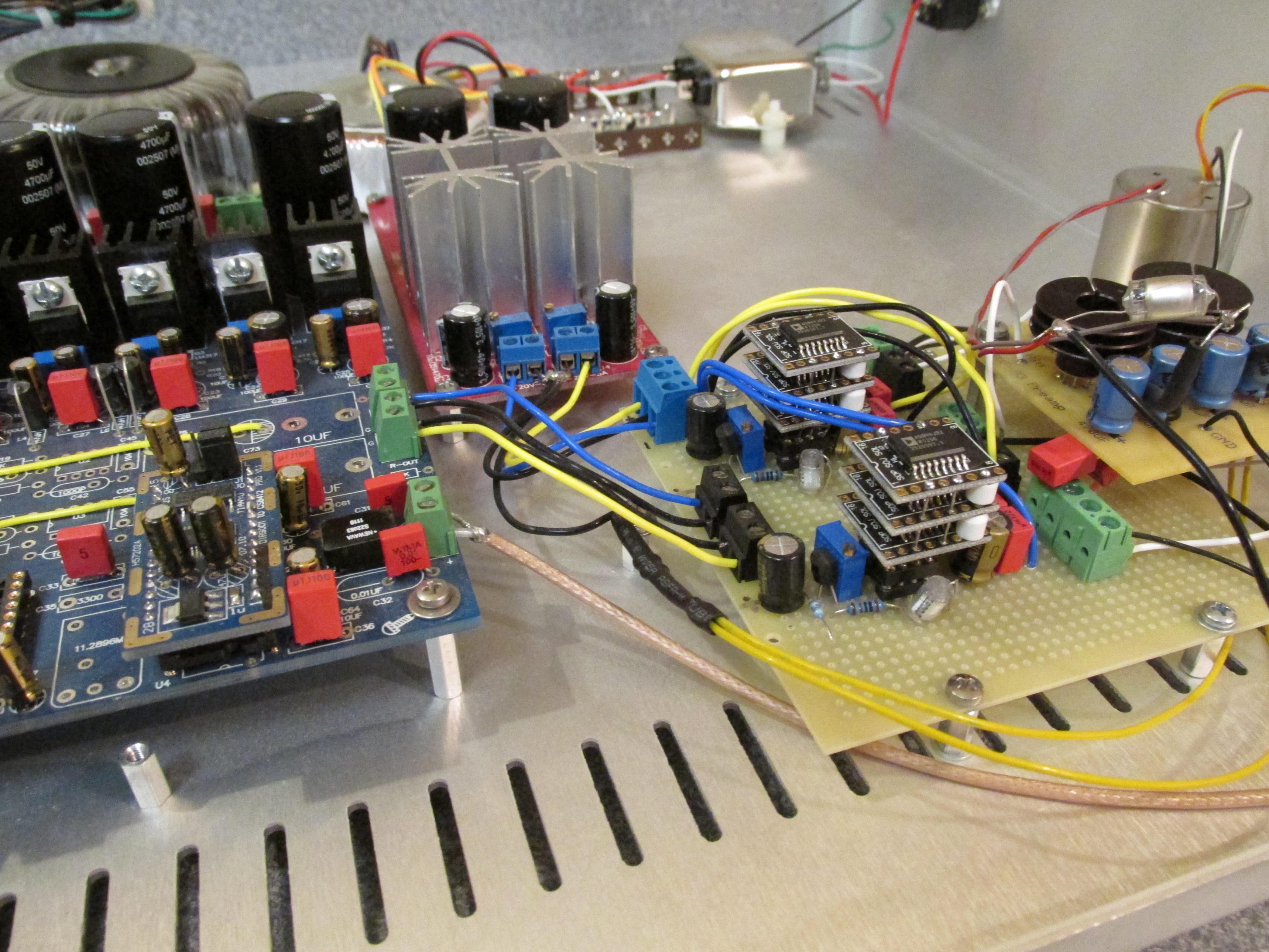

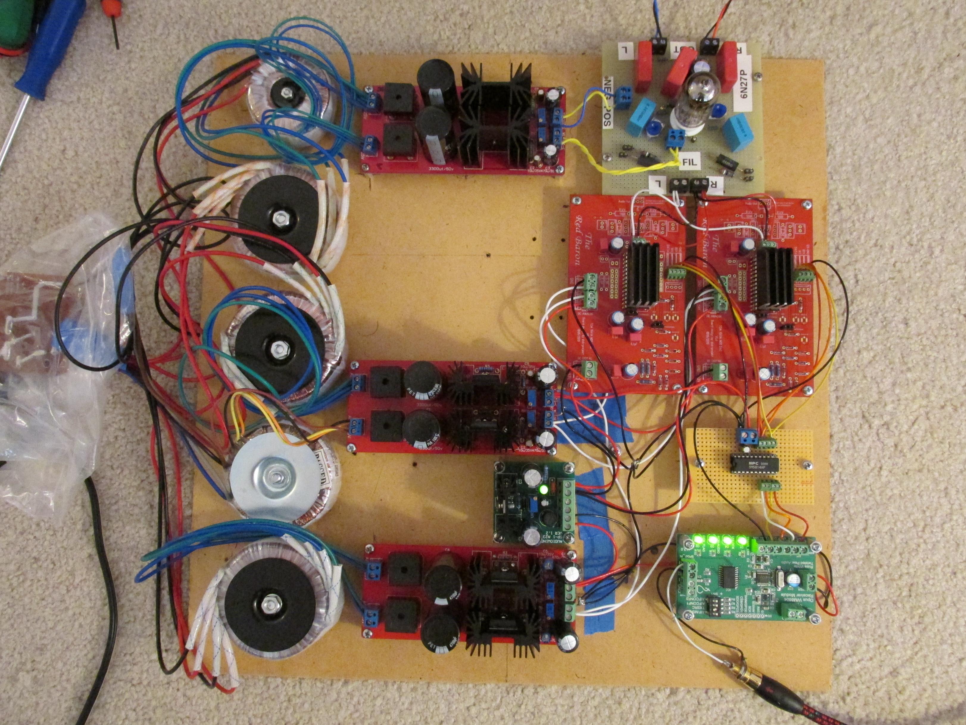

I pulled my DAC from service to confirm a few things. Wanted to see if I had ever used conventional feedback with the AD844. I didn't. In my TDA1541 D/A I am using Pedja's 2SK170 2 mA current source. I found no drift and both DAC outputs sat at 0.0 mV. In my build I have a triple stack with pin 6's all floating. Connected to nothing. I have a connection point wired up (bottom output) just not in use. In my build I go pin 5 (TZ) via 1 K resistors to the BUF03 buffer, Feedback resistor = 1.5 K. I look at it as a gate resistor. It adds nothing really considering the super high input impedance of the BUF03. For fun I probed the pin 6 connector and found -15 to -16 mV. Considering it is floating I am not concerned. Early on I did use this and had about -1.6 mV offsets. While I was in there I checked the power supplies and all is in specification. I decided to leave it alone as a reference. I have a new build in progress. WM8804 NPC SM5814 Parallel TDA1541A S1 Crown D/A (purchased in 1990). I am still working on the digital filter board and yet to finalize the I/V. Expect to have it on a bread board for testing in 2 weeks. Ultimately may try a balanced configuration. 😉Yes, you are right. Without any other means the offset in my player was around -300mV. When you increase the gain, you may get more. You can use a coupling cap or some means of offset compensation to null it out. In my setup I could not null the output with the pins1,8 of the AD844 alone using the recommended offset arrangement as drawn in the datasheet. I connected an additional resistor (50K - 100K) from the plus rail to pin3/AD844. Then it was possible to null it out. If you change the gain of the stage you may need to adjust this resistor accordingly.

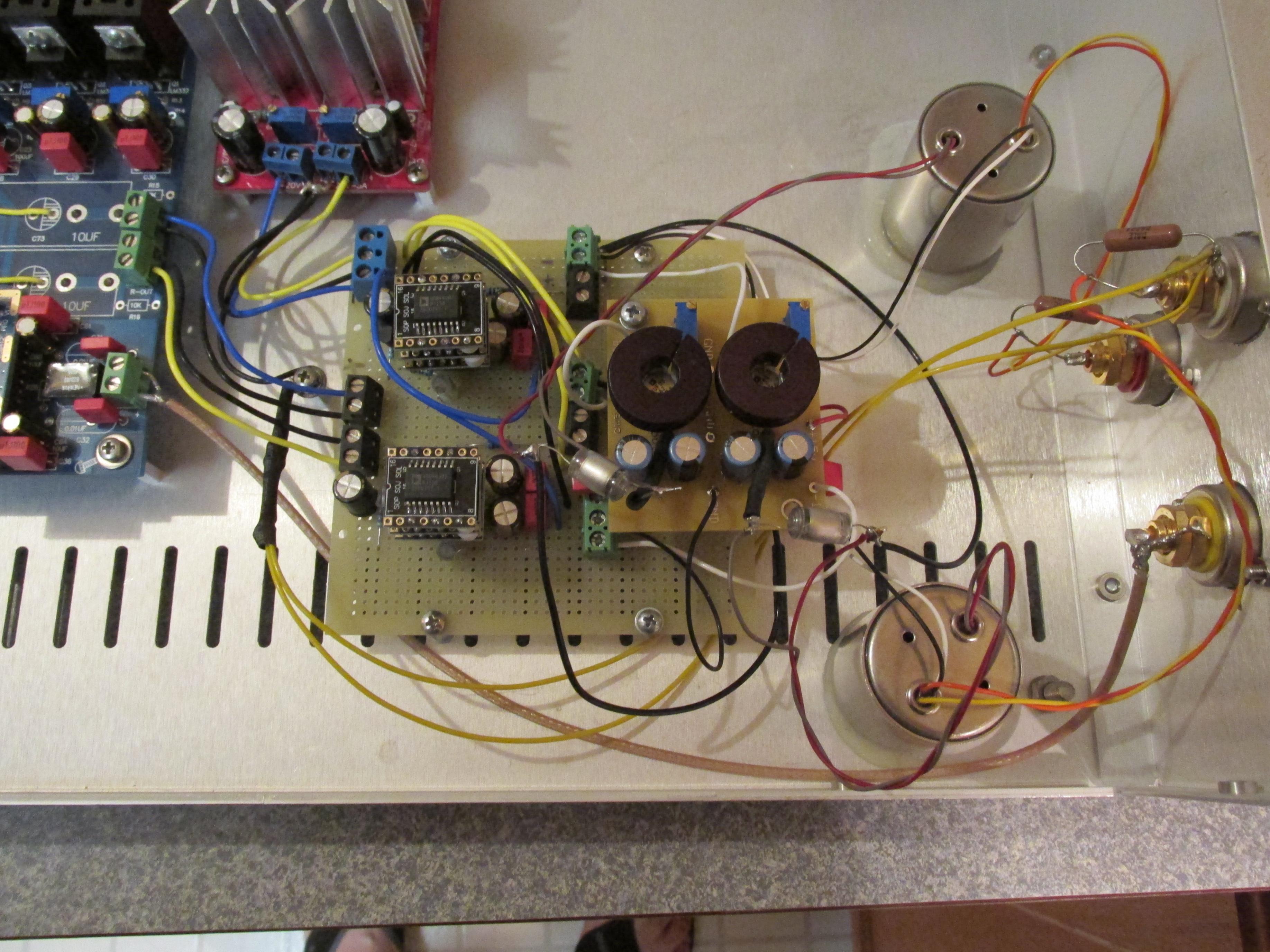

As long as it works....Here`s the nest, works better than it looks......
It's alive.... Tweaking it since last Thursday. Resistor I/V = 25 Ohms. SRPP ECC86/ 2SK170.... Results. Best DAC to date. So my question is with 0-8 mA output, would that seem to be to much for the AD844?

it definitely gives more air to the music... 😀Here`s the nest, works better than it looks......
