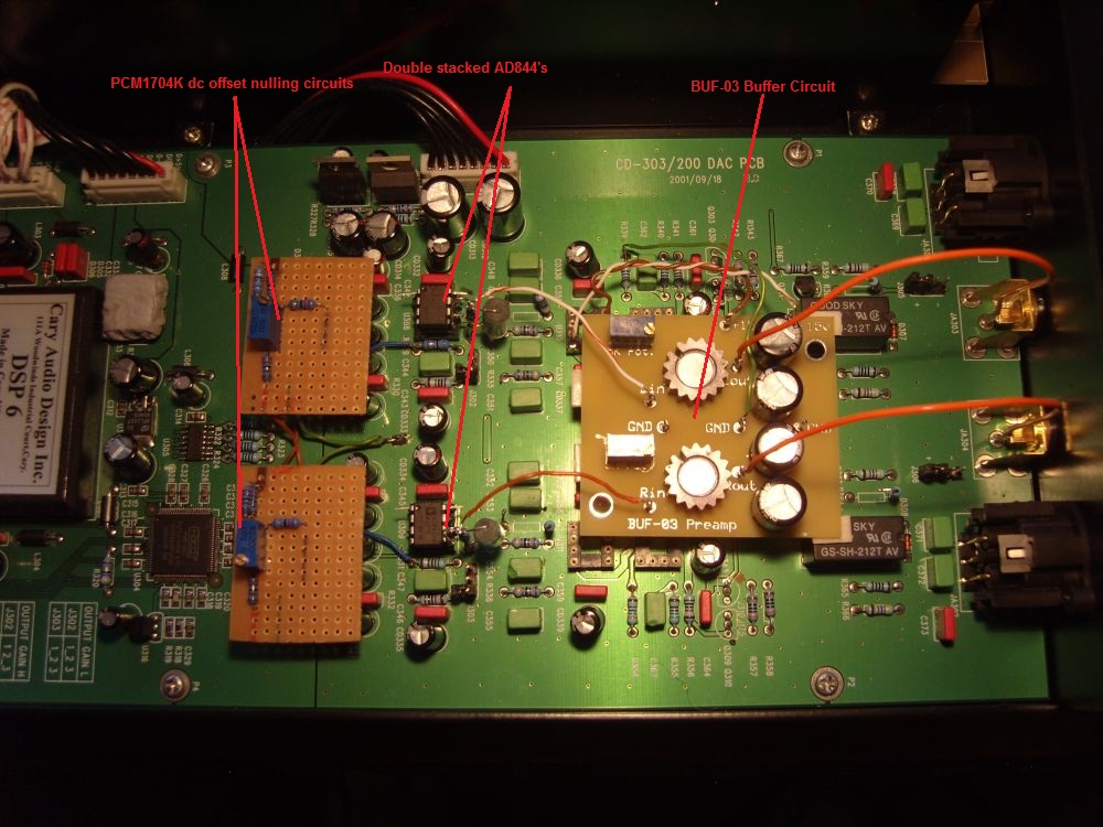

Using the AD844 as an I/V
Pic of the temp setup for those who wish to see.
Cheers George
BUF03
Got the BUF-03 yesterday put it in instead of the AD844's own buffer, dc offsets steady at .1 to .2mV after warm up, when cold I get around 5mV, also a mute circuit is needed as it in conjunction with the AD844 gives a hefty 5v switch on and off thump for a second. I have very nice TO-99 cast aluminium heatsinks for them they run HOT, and no they are not oscillating, 15v rails.
The 844's buffer will not drive my Sennheiser HD650 (300ohm) without gross distortion where the BUF-03 does it no trouble, the BUF-03 has far lower output impedance and higher current than the 844's buffer.
On my system proper both are driving a 50kohm total load of the input of my poweramps (bi-amped 100kohm each) I use the digital domain volume on the cdp, it is in the same position for both buffers almost full up.
Listened all night. I am perplexed, the sound is so different and opposite to what I thought would happen, the AD844 is super fast, very dynamic, very detailed, sweet highs, very extended both ends and kicks like a mule in the bass, and has subterranean bass. It can get in your face sometimes with bad cd's
The BUF-03 I thought with it's far low output impedance and far higher current would be even more of the above. But no it does exactly what pure class A poweramps do, things seem mellower/relaxed (almost tube like) it's all there but it's toned down a little like someone has slipped a tube in somewhere, but more so like a good class a/b poweramp which has been biased up almost into full class A.
Both are great to listen to but as to say which is right, I cannot say yet, I need to listen much longer to see if I miss the 844's attitude. One thing though the BUF-03 has got the thumbs up for driving the Sennheiser phones.
Cheers George
Hi George, You summed it up pretty well. I run my BUF03's with even larger heatsinks. I listen to Grado SR80's and Audio Technica ATH-M50's. 35 Ohm and 38 Ohm headphones. You can null those BUF03's out too. My current Preamp/Headphone amp is based on LME49710HA and BUF03, I use a 21 position attenuator at 20K Ohm. Compares well with my Nelsen Pass BA-3. The headphone amp is more interesting in the lower mid bass. I switch off the power amp first to avoid the thump. Also I noted that the AD version BUF03AJ sound a touch different then EJ's. Not sure why. PMI was the original design and AD bought them out sometime in the late 80's or early 90's. Lots of high end manufactures used the BUF03. Just a thought.... In my testing I find the BUF03 will take on a different sound based on what feeds it. If I stick it behind the BA-3 it sounds a bit like a OPA627, a tad dark like the DIP version. Behind the LME49710HA it isn't the slightest bit dark. Dave
Have now double stacked the I/V section of the AD844. Georgehifi is absolutely right. This is the most impressive improvement I have done in quite some years. Fantastic! For those of you that are into using the AD844, I can only applaud to this solution. Well done!!!
Looks good. Surprised to see a purpose built PC board. I'm using larger electro's with Wima bypasses on mine. My soic AD844's should be here today. 😀
Yes this was aready made board I picked up on ebay, I also have .1uf bypass caps underneath.
That's three now out of three that have bothered to try stacking the I/V section of the AD844 with the same great results that I achieved, maybe this will make the nay sayers think again before questioning stacking the AD844's I/V stage in open loop configuration without even trying it. Current starvation with dac's glitches or transients seems to be the issue here I feel which is addressed with stacking, but it could also be the fact the input impedance is halved for each doubling of 844's i/v stages as well, it's win win whatever is the cause for the massive improvement in sound quality.
